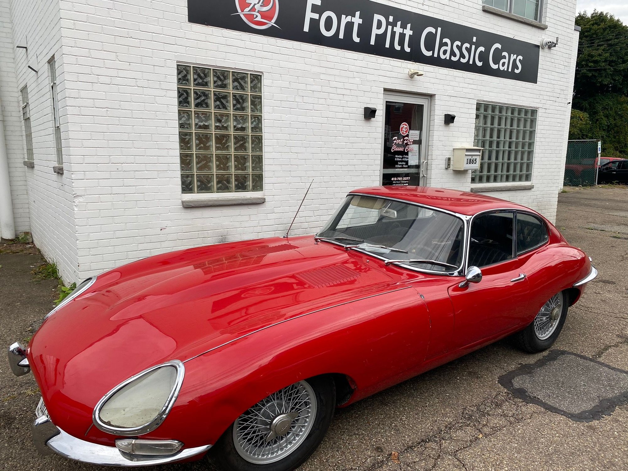

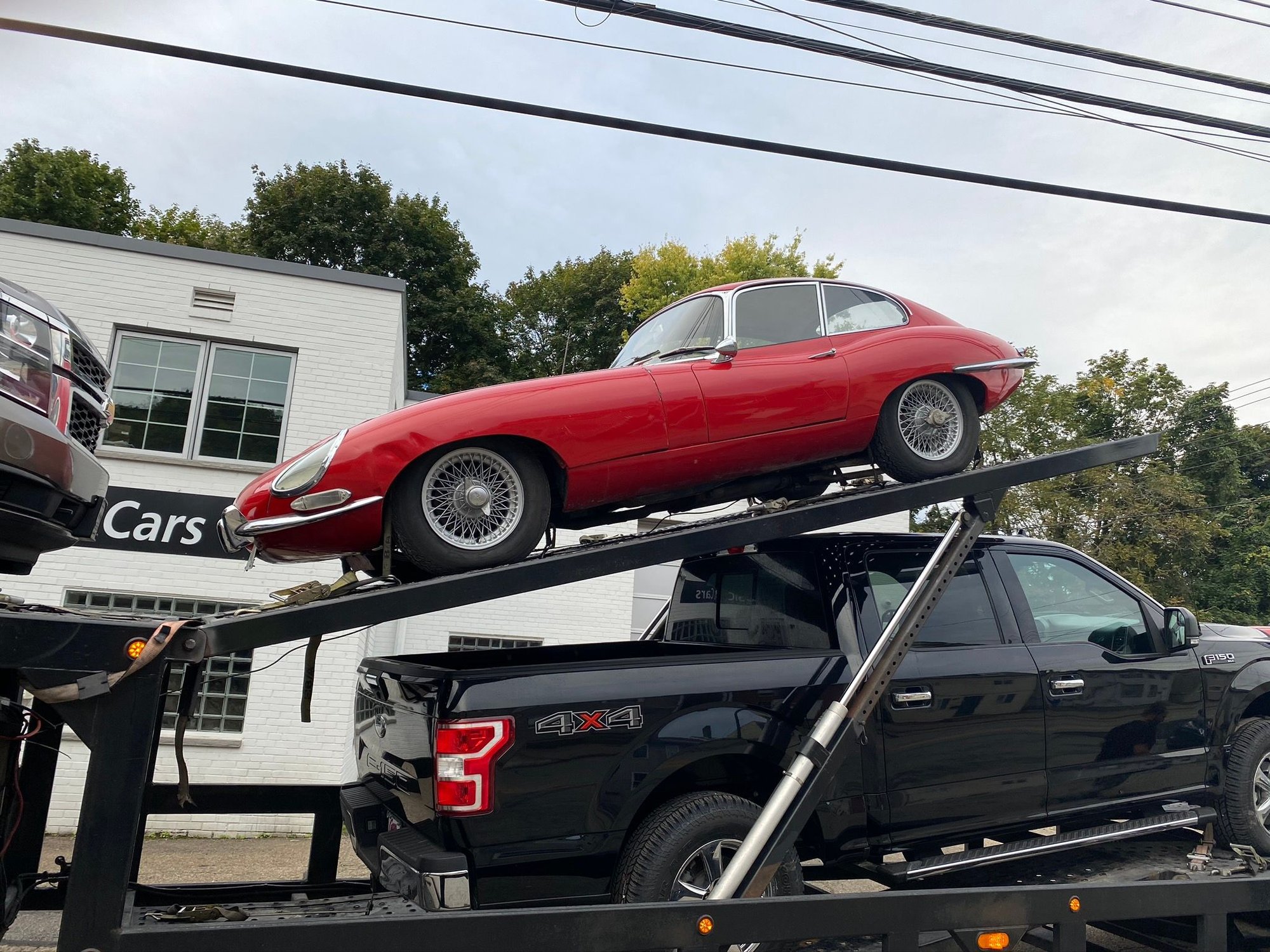

Finally got the key issue resolved and had the car transported to Pittsburgh. Going to have some of the basics addressed to get it running before I decide how and if to restore it.

my father in law acquired the car in the 80’s he did not restore it. But, it was definitely repainted at some point by a previous owner. It does need quite a bit of work.
