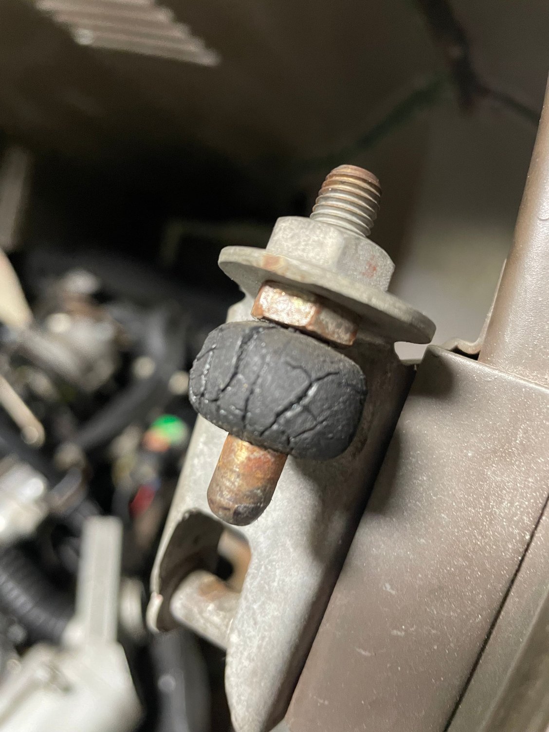

In two weeks my journey starts to replace the whole brake system from front to back. I don’t believe anything has been done as everything is corroded and brakes are terrible even with a fluid change and correct bleeding. The rotor surfaces are paper thin.
In the mean time I’m starting a list of parts for the future which includes all of the rubber seals on the exterior and I cannot find a name or number for these two small rubber “bumpers” at the rear inside of the bonnet. I could easily make them myself but would like to keep original if possible. Any ideas? Thanks….

Try part numbers bd 19896 for the pin and bd 19936 for the buffer.

Yeah, what Valerie said. Next order, ask Moss to include their catalog; it has exploded diagrams that facilitate identification, in this case on page 124.
