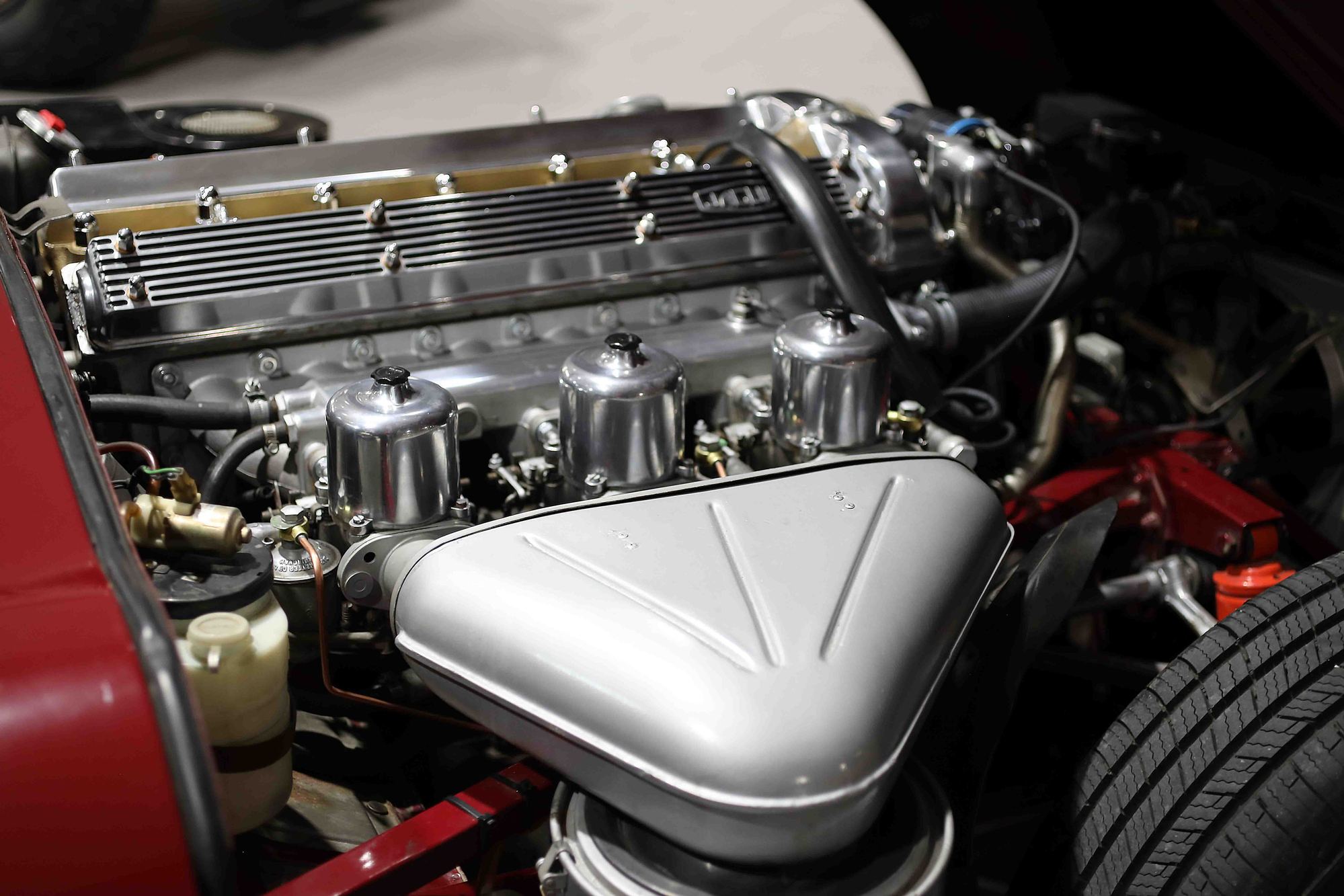

The black crinkle paint on the covers have been polished. Chromed high output alternator, triple SUs, cam valley painted Jag gold, electronic distributor, NGKs, battery cutoff, Koni shocks all around. 205 Michelin Defenders. I also used the dummy (rear defroster) rocker switch as a "Kill" switch.

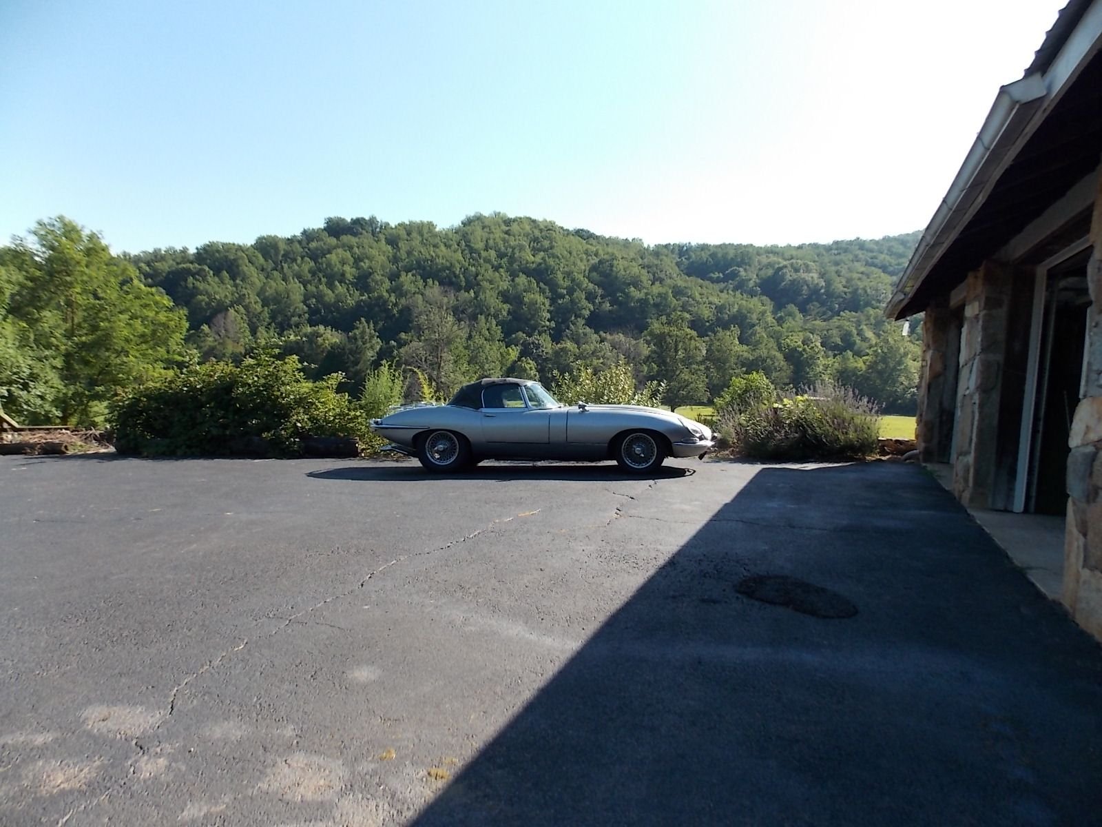

Hello Daytona, please excuse the delay had rinse her off before I took a picture for you. My garage apron is at an incline so she looks sort of level in the picture but the front tires are quite smaller. The rear exhaust has more clearance with the 205 tires on back and it has never bottomed out on me. I've had the car since 1984 and have had 185"s and then 205 tires all the way around on the 5" wire wheels but she now seems to corner better with the 185 tires on the front. Who would have figured?
