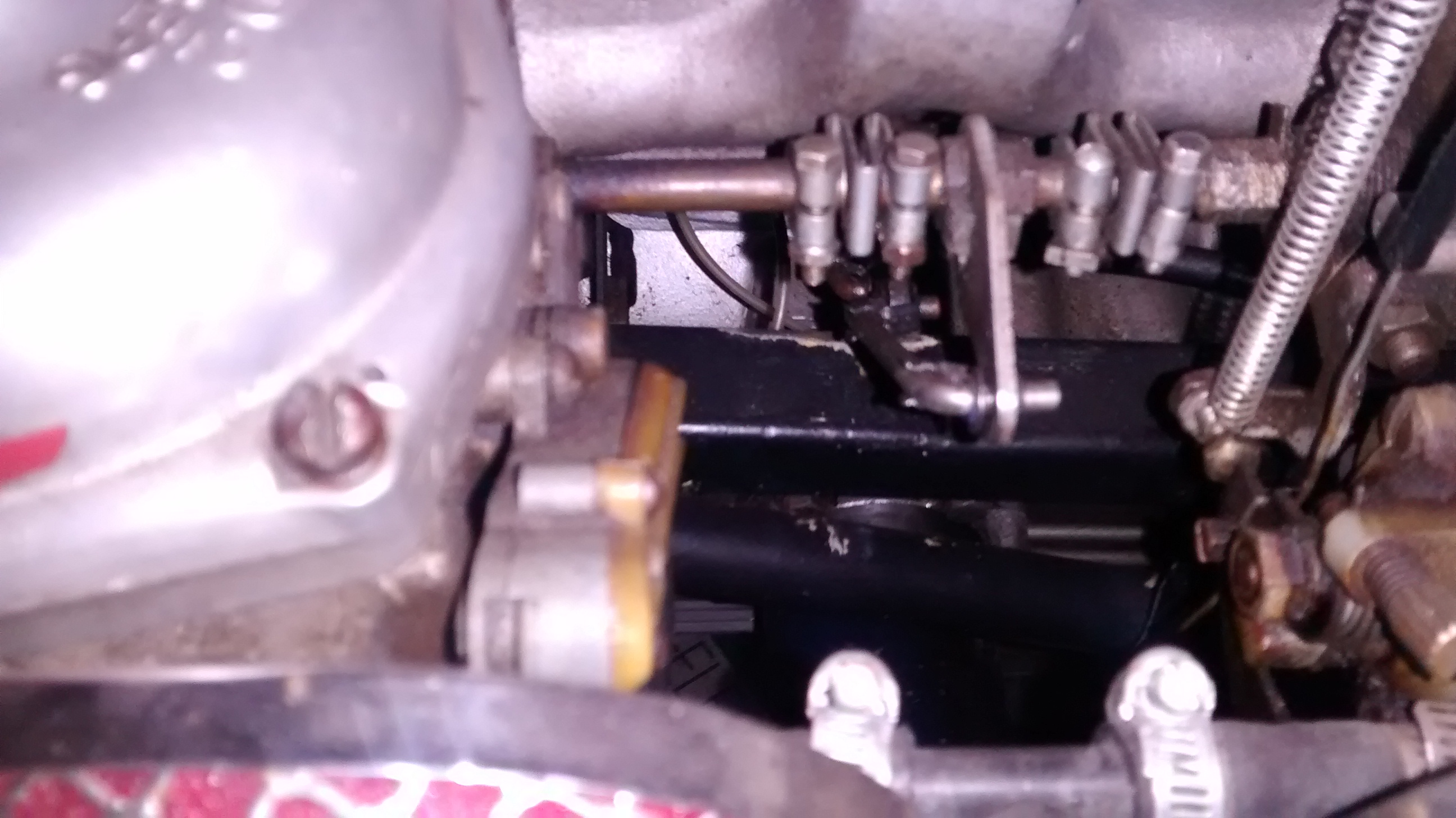

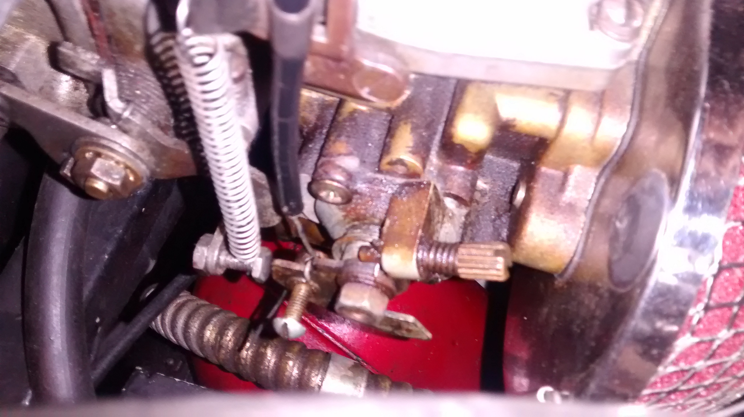

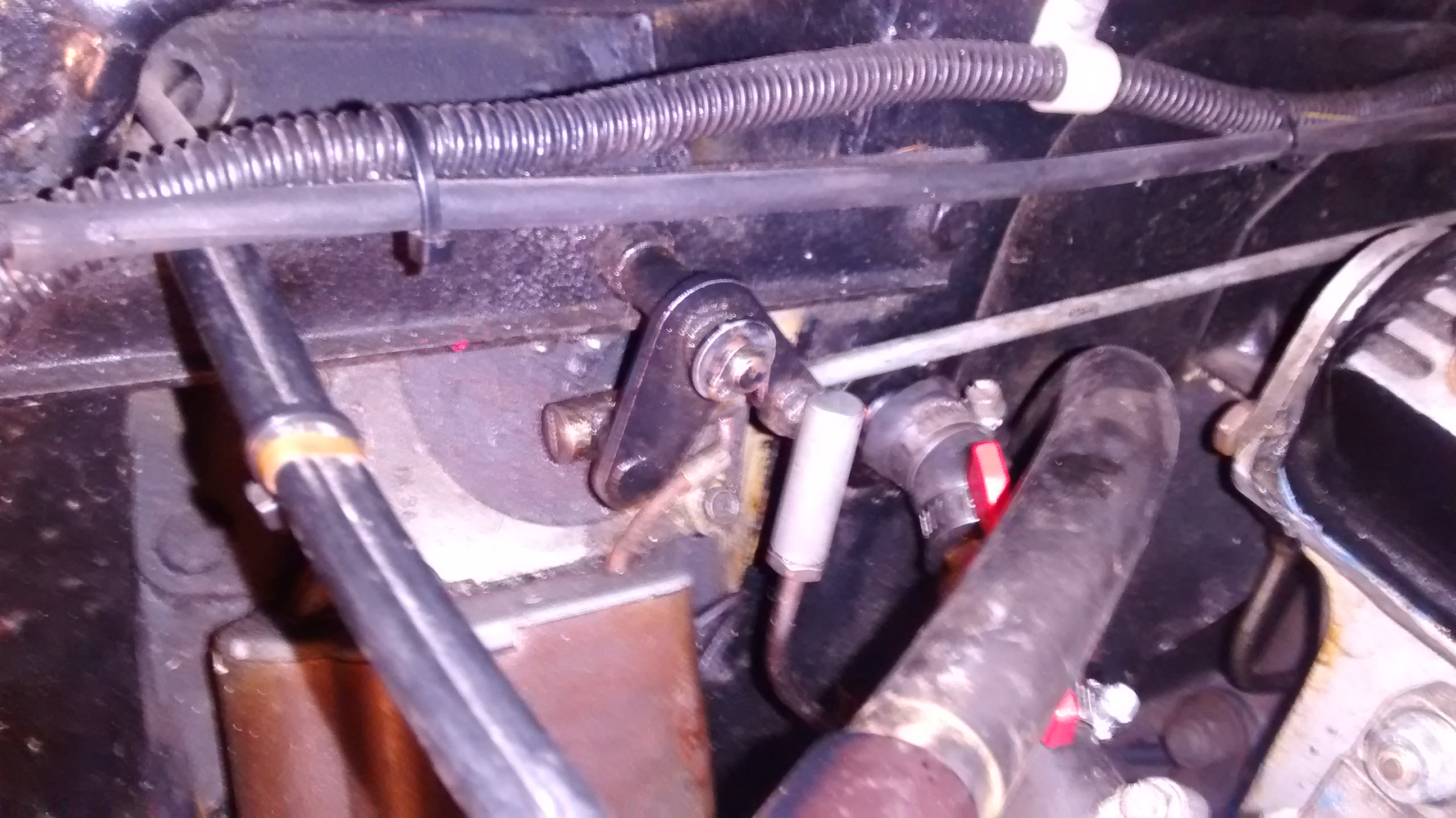

here are some pics

Awesome thanks Alfred. Can you take pics of under the carbs? Like the Springs and stuff?
So far everything looks right

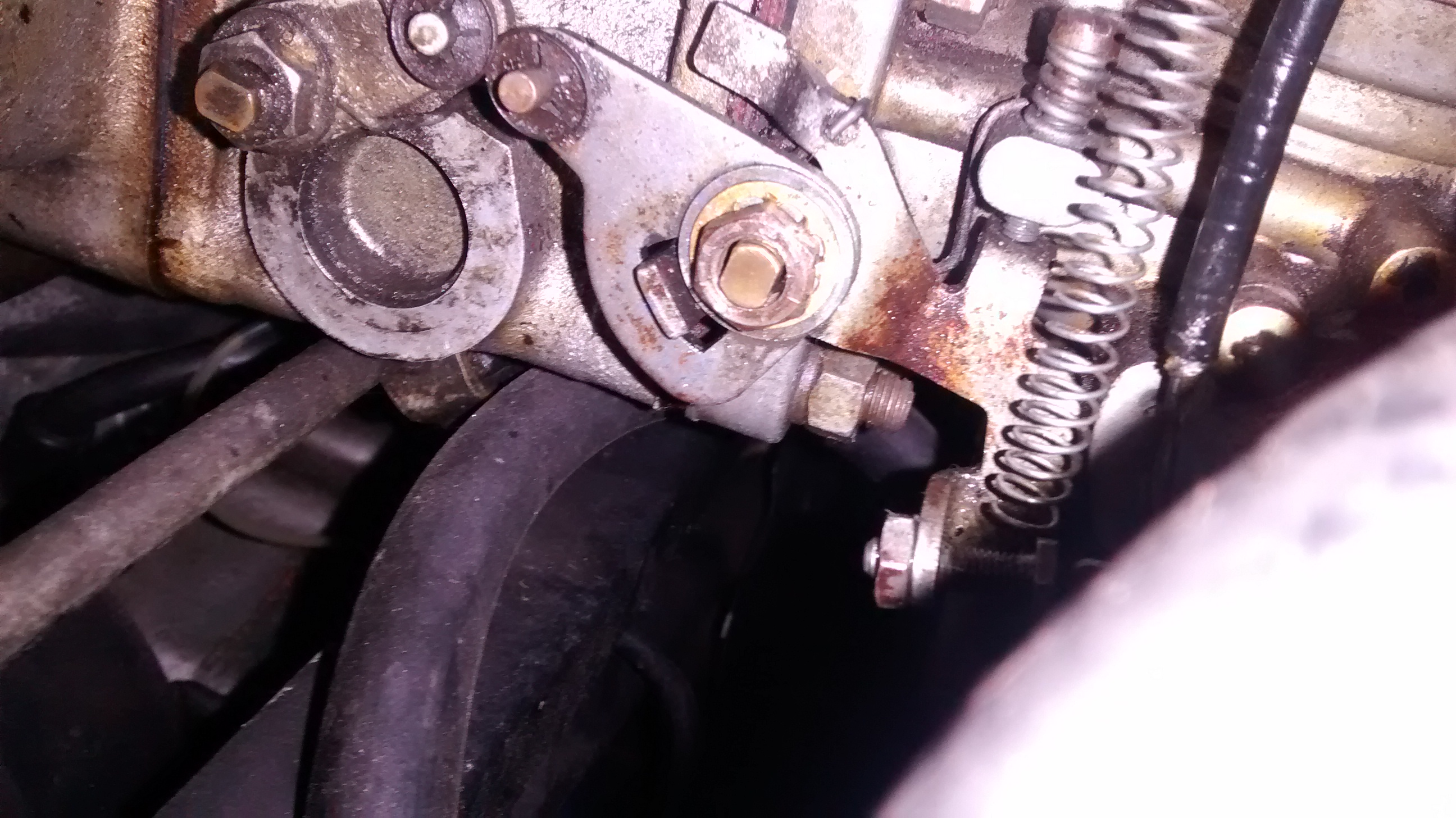

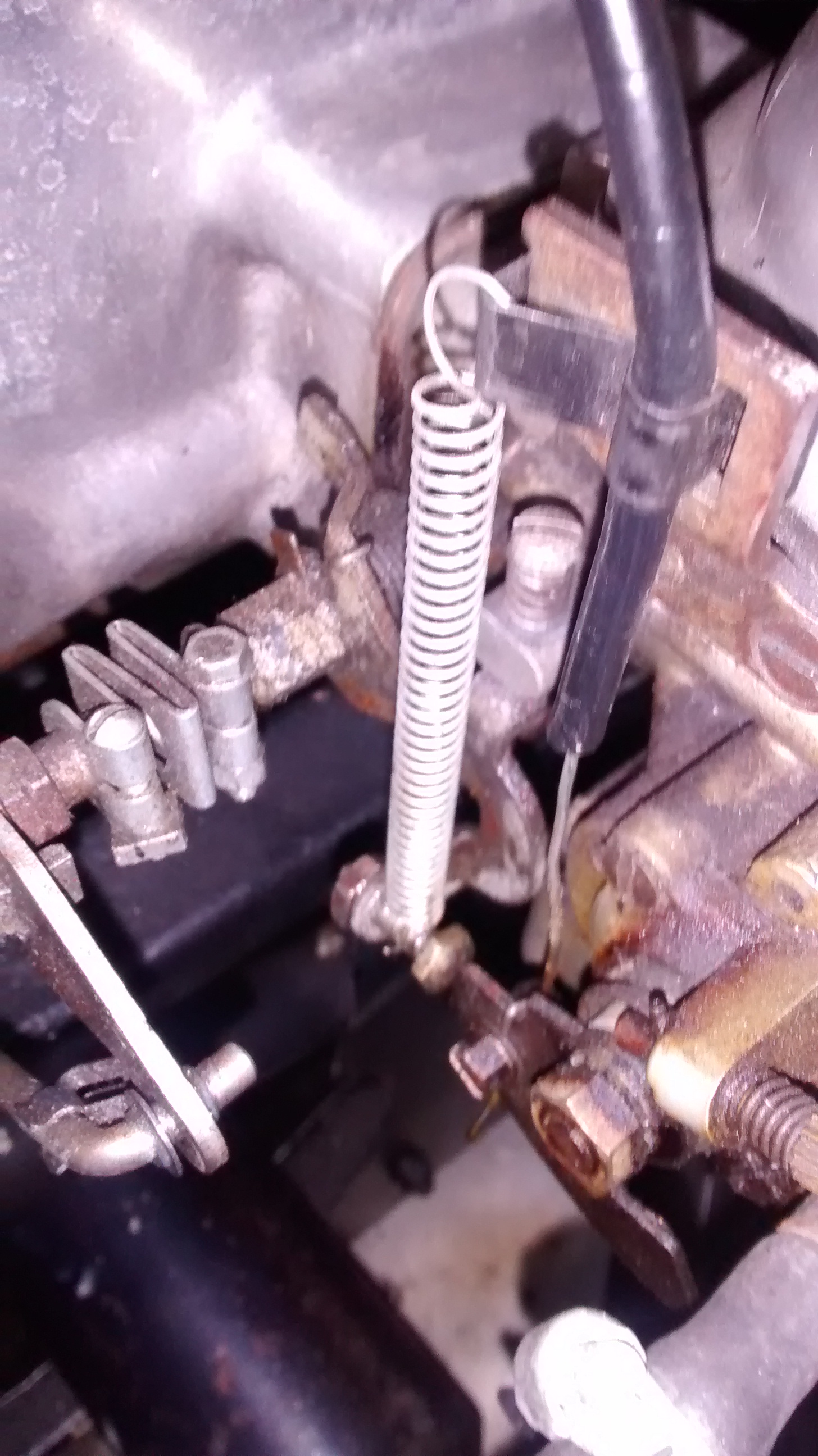

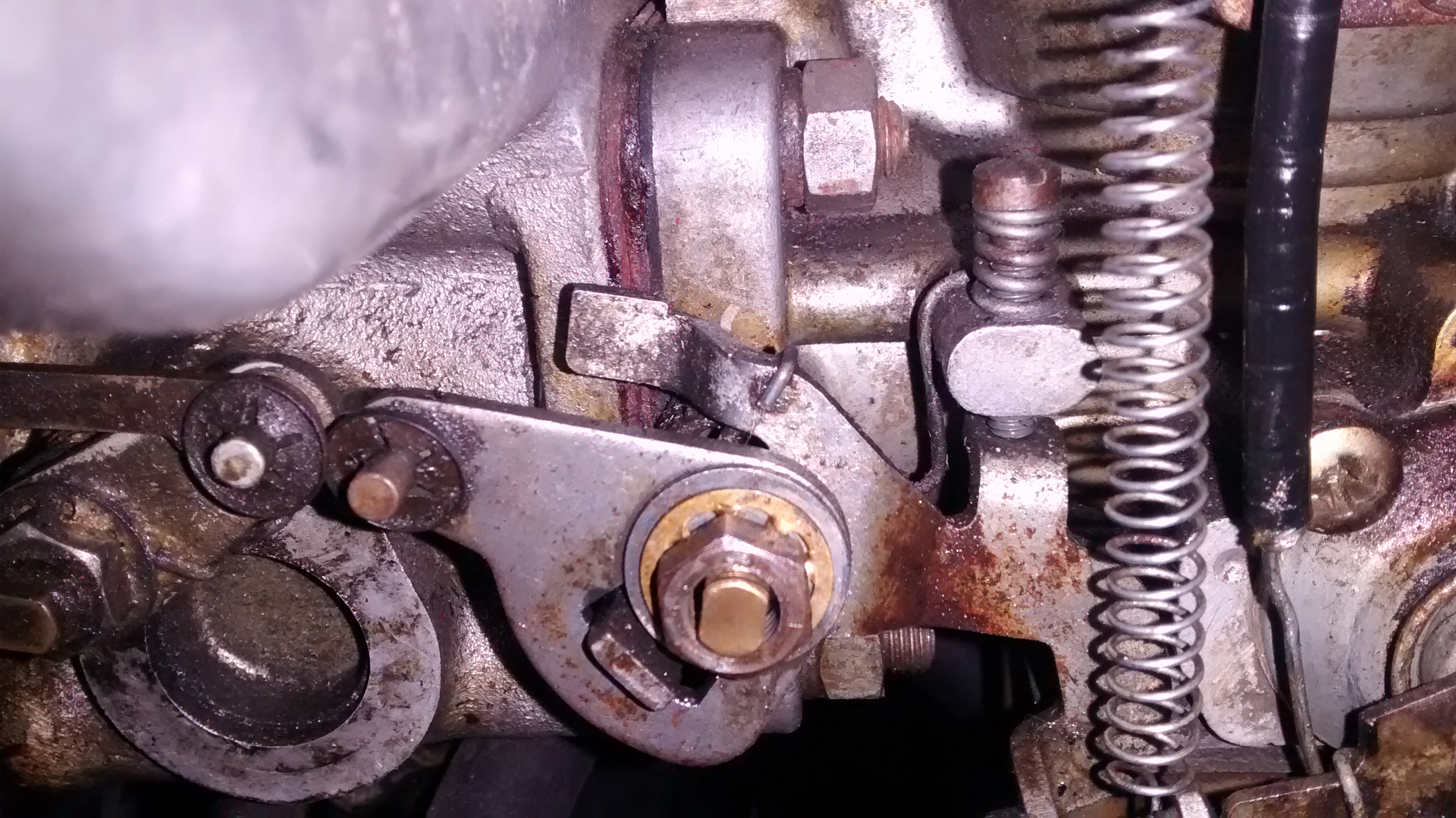

more pics, as you can tell I have done the "Strangleburg fix".

What's the strangleburg fox about?
Old Apr 12, 2017 | 10:16 PM
alfred's Avatar
Joined: Nov 2009
Posts: 354
Likes: 53
From: London Ontario Canada
Peter Crespin detailed how to modify/disconnect the secondary throttle link at the Carb. search Crespin mod, or 5 minute strangleberg fix.
