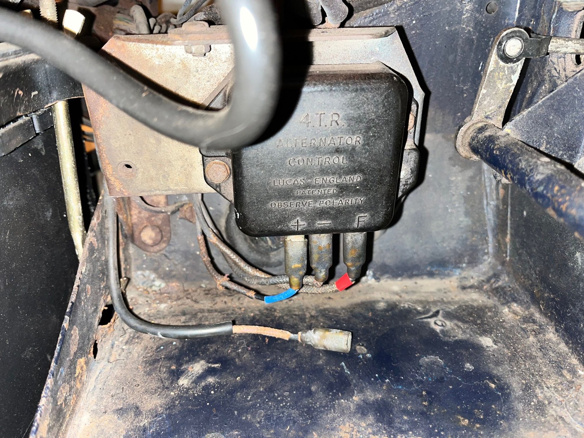

I tried the CoolCat test of the 4TR and still no charge. I will try it again just to be sure I didn't miss something the first time around.
Not sure which relay is the 6RW or the 3AW. There are two relays behind the battery (one above the other) and I think one is for the horns.
Old Jul 26, 2022 | 03:46 PM
ChrisMills's Avatar
Joined: Jun 2018
Posts: 943
Likes: 292
From: Auckland, New Zealand
There should be 12v at the alternator large terminal (left on your photo).
The grounding that CoolCat suggests at the 4TR, is equivalent to grounding the Field terminal (bolted wire on the right). This would put the alternator to max output and should be visible as an immediate rise in battery voltage.
Mucking with the other terminal (bit of red showing) should alter the indicator light I think (with engine not running, just to check continuity).

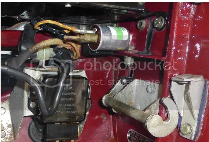

The 3AW looks like a turn signal flasher can, typically has green printing on it, IIRC it plugged into the firewall.

Yes, that's the wiring diagram that I've been using, however I don't know if I should be following the basic one, or the "alternate circuit for cars with steering lock".
In either case, I've identified the following:
  • I have 13.1V across the battery.
  • On the regulator, the (-) has continuity to ground; the (+) has continuity to the wire next to the 'B-post' on the alternator; and the (F) has continuity to the wire (with the bit of red) on the alternator.
  • There is no power to the (+) lead on the regulator (marked with blue tape).
  • Bypassing the 4TR did not yield any change.
  • The large bolted wire on the alternator has 12V (actually 13.1V since the battery is fully charged).

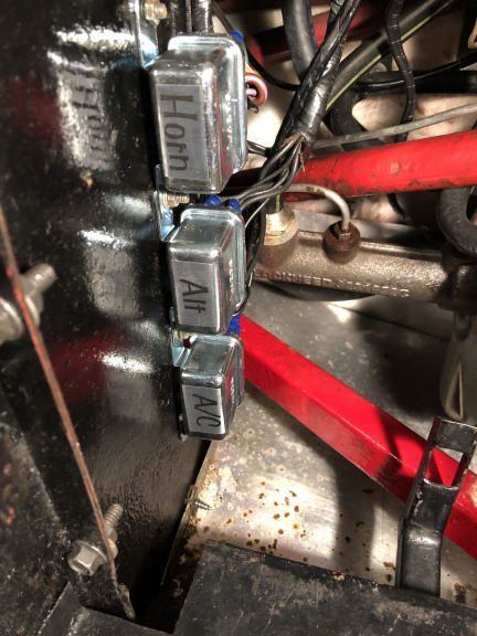

  • The only relays I can see are the two on the left wheel well. I am assuming the top one is for the horns and the bottom one is the 6RA for the charging circuit. However, the basic wiring diagram isn't showing how a 6RA relay is connected to the circuit. The regulator (+) lead does not seem to have continuity with the relay.
  • The ignition warning lamp lights up when the ignition is switched on, but once the car is running, does not light—even at low RPM.
  • I think the black wire on the alternator that is farthest from the others goes to the 3AW relay/ignition warning lamp, but that is just a guess.
  • I cannot find where the 3AW relay is.
More pix attached. Additional thoughts?
the regulator with the four leads. I added the color tape to temporarily identify.
the two relays on the left wheel well.

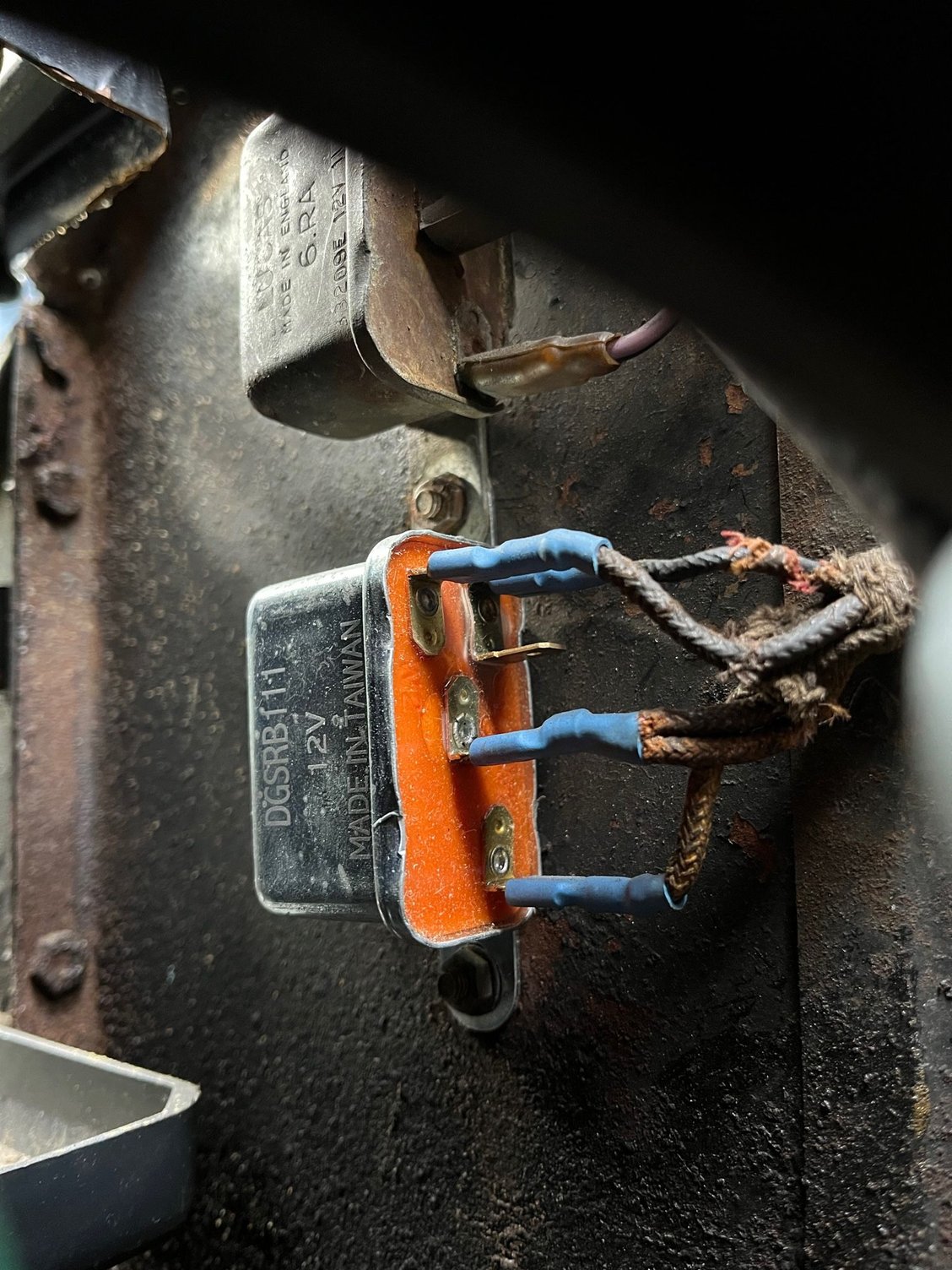

the bottom relay. is this the 6RA relay?

Default 3AW
Hope this photo helps: It looks like a turn signal/flasher 'can' with a green label.
Attached Thumbnails non-charging issue: alternator or regulator or wiring?-3aw2.jpg

To recap you've got Field F- (red bit) continuity between alternator and 4TR.
You need 12v at the F+ terminal (next to the big wire), which also goes to the 4TR + terminal. And that's supplied by the 6RA relay.
Although the upper relay says 6RA, the lower relay has braided wires like the alternator/4TR so I'd check for some continuity there to F+ and 4TR+. Or test that relay, I'm not sure which terminal is which but 2 are the coil and 2 are the switch. Likely the relay, which supplies the 12v you're missing.

The (F+) lead at the alternator is getting 0.0V. This seems to indicate that the 6RA relay is DOA but maybe it's the wiring.
My questions are now:
  • which wiring diagram should I be following? The factory diagram does not show a 6RA relay and therefore conflicts with the CoolCat diagram. Or since my car originally had a steering column lock but no longer does, is the alternate circuit diagram still correct?
  • is there a way of bypassing the 6RA to see if that is the culprit?
  • where do the 6RA W1 and W2 connectors go? Or is it even in the circuit (per the factory diagram)?
  • does the 3AW relay have anything to do with the actual charging, or is it merely for the warning light (and can therefore be discounted in my troubleshooting)?
Thanks again for everyone's help.

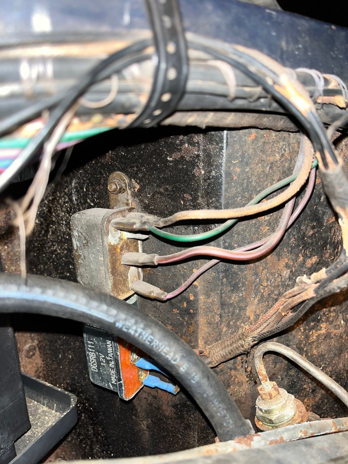

Ok, let's see if I can sort this out for you. First of all, the CoolCat diagram applies to late 4.2's with a 3AW relay, which would not include your 1966. For the early 4.2's, the indicator light is operated by an oil pressure switch, which is located on the right side of the engine block.There won't be a 3AW. It may sound crazy, but the ignition light on these cars has nothing to do with the alternator or the ignition system. All it tells you is that the key is on and the engine isn't running. It's a crappy design, but praise Lucas..In all other respects, the '66 wiring is the same as the later cars. Your car does use an alternator relay, and there is a relay on the official parts diagram. The 11AC system can't work without one.
Since your car won't have a 3AW, it shouldn't have any wire on the alternator's AL terminal, but it does. I'm assuming that this ends up as the loose connection next to the VR. If that's correct, it's a problem waiting to happen. You need to disconnect it at the alternator, and tape off the ends for safety. I would guess that someone bought the later alternator harness.
To find this problem, turn the key to the "run" position. Then set your meter to DC voltage and clip one leg to any good ground. test the "+" wire at the VR, which should have 12.something volts. Then check the wire on the alternator between the B+ post and the red wire. That one should also have 12.something volts. I'll bet that you don't have voltage in either location. The likely culprit is the alternator relay, which is the second from the top on the left fender apron. The one that's "made in Taiwan". These relays have a bad reputation in service. SNG carries Lucas branded relays in a green box. They work pretty well.
These photos should help a bit:

Just a quick guess. I can't be sure of the harness wiring because the colors are faded and dirty. But the relay should be wired as follows:
C1: unswitched 12V+ it will have power whether the key is on or off (Brown/Red)
C2 should have two wires, one goes to the alternator F+, the other to the VR + (Brown/Purple)
W2 Should be a ground wire (Black)
W1 switched 12V+, it will only have power when the key is on. (White)
Given the poor state of your wiring, you will have to verify the wires with your multimeter.

The wiring seems to check out; I've traced the following:
  • W1 is getting 12.7V (with IGN switched on); no power (w/ IGN switched off)
  • W2 is connected to ground
  • C1 is getting 12.7V (unswitched)
  • C2 wires have connectivity from alt (F+) to reg (+). [weird side note: my multi-meter did not show connectivity when I tested the Lucar connection at C2 to the individual points, but did show full connectivity when I tested (F+) to (+).] [I then used jumper wires to bypass the original wiring of C2---(F+) and C2---(+). Still no charging.]
At this point, I'm thinking it's the 6RA relay...
