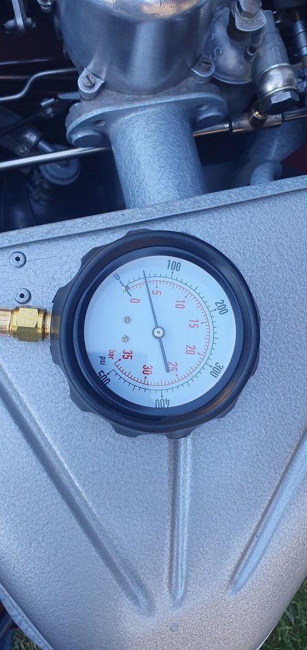

Here are some news for today. I’ve received my workshop mechanical oil pressure gauge.
engine cold
35 psi at idle
40 psi at 2000 rpm
engine warm 80 degrees
40 psi at idle
50 psi at 2000 rpm
a little to high at idle, isn’t it ?
engine cold
35 psi at idle
40 psi at 2000 rpm
40 psi at idle
50 psi at 2000 rpm
I cannot edit my first post, please read "Tension" as "Voltage". Sorry for my poor English, and thanks a lot for your patience and comprehension
I think you posted this on the UK E Type forum. Oil pressures are fine. The reason why your hot oil pressure at idle is higher than your cold idle is probably because your tickover is faster when hot. Oil pressure on the E is quite sensitive to engine speed at the lower end. Give your oil pressure a tick and move on would be my advice.

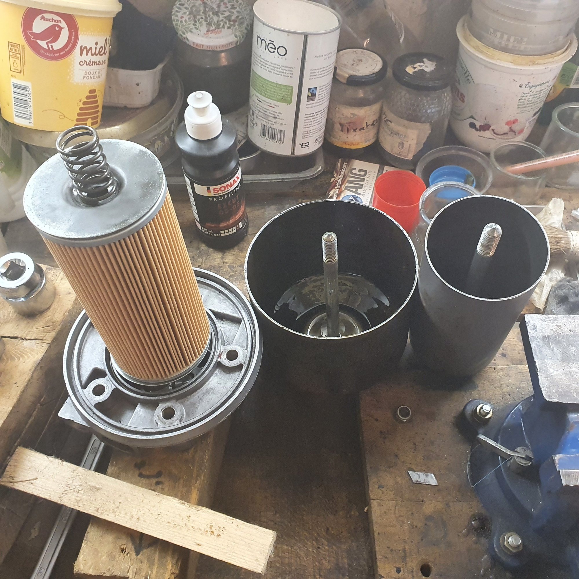

i finally changed the oil by a 20/50 mineral one. I changed the filter oil and discovered the mechanism was not complete. The spring and oil filter plate were missing... I toke the one from an XJ6 engine that is standing at the back of my garage
They are fitting well.

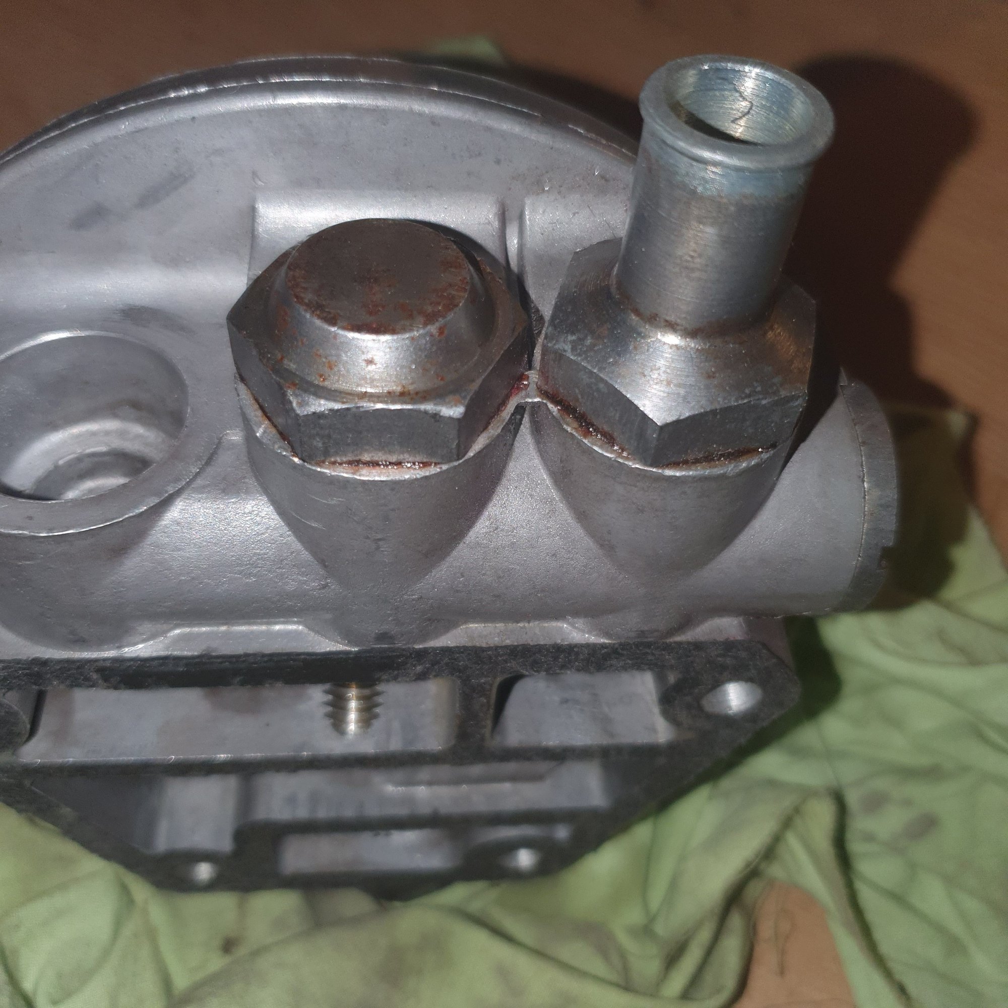

Pushing forward, i dismantled the oil filter head assembly to be able to unmount the relief valve (it was glued with red loctite). I cleaned everthing including the valve, cleaned and replaced everything in place...
Using a workshop mechanical oil pressure gauge, i can see 2.5 bars at idle (engine warm), and 4 bars at 3.000 rpm. Job done
