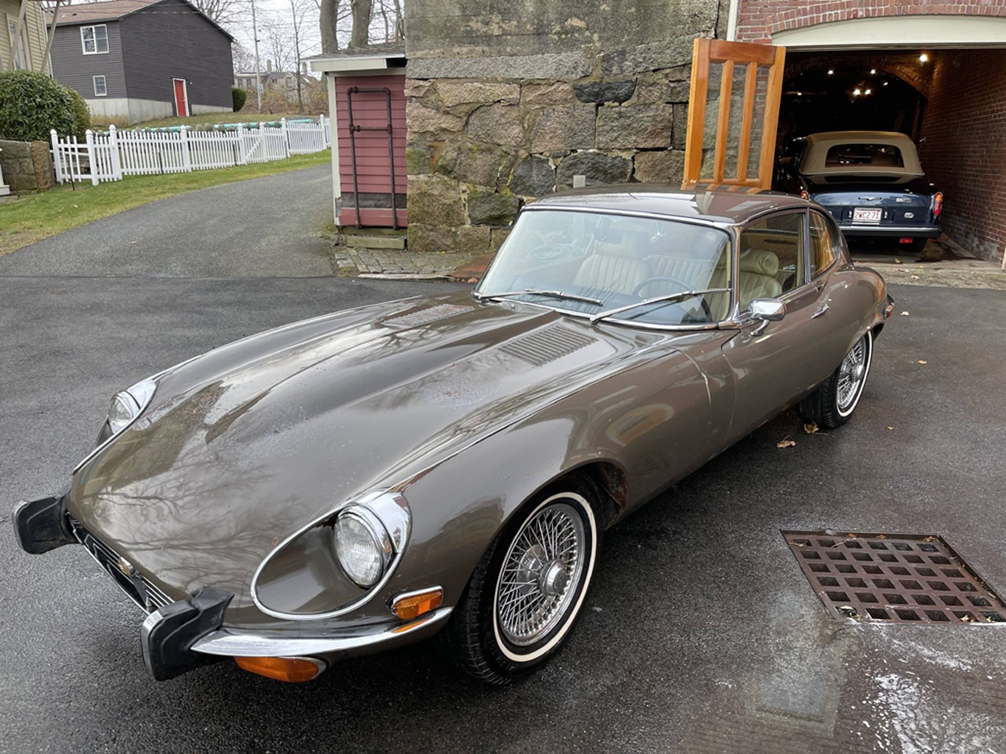

I just bought a 1973 Jaguar V12 2+2. I would like to get rid of the US government-mandated large rubber front bumper guards and replace them with the more conservative-looking European type. I notice Baratts has them. The question is do they just bolt right in after the old ones are removed or do they require extra modifications? I notice these bumper guards come with expensive bumpers. I don't really need them. I just want to replace the bumper guards.

Wow! Thanks. All I want to do is replace just the large rubber blocks they call bumper guards on the front only. The bumpers themselves, front and rear can stay. Sounds like a bolt on process.

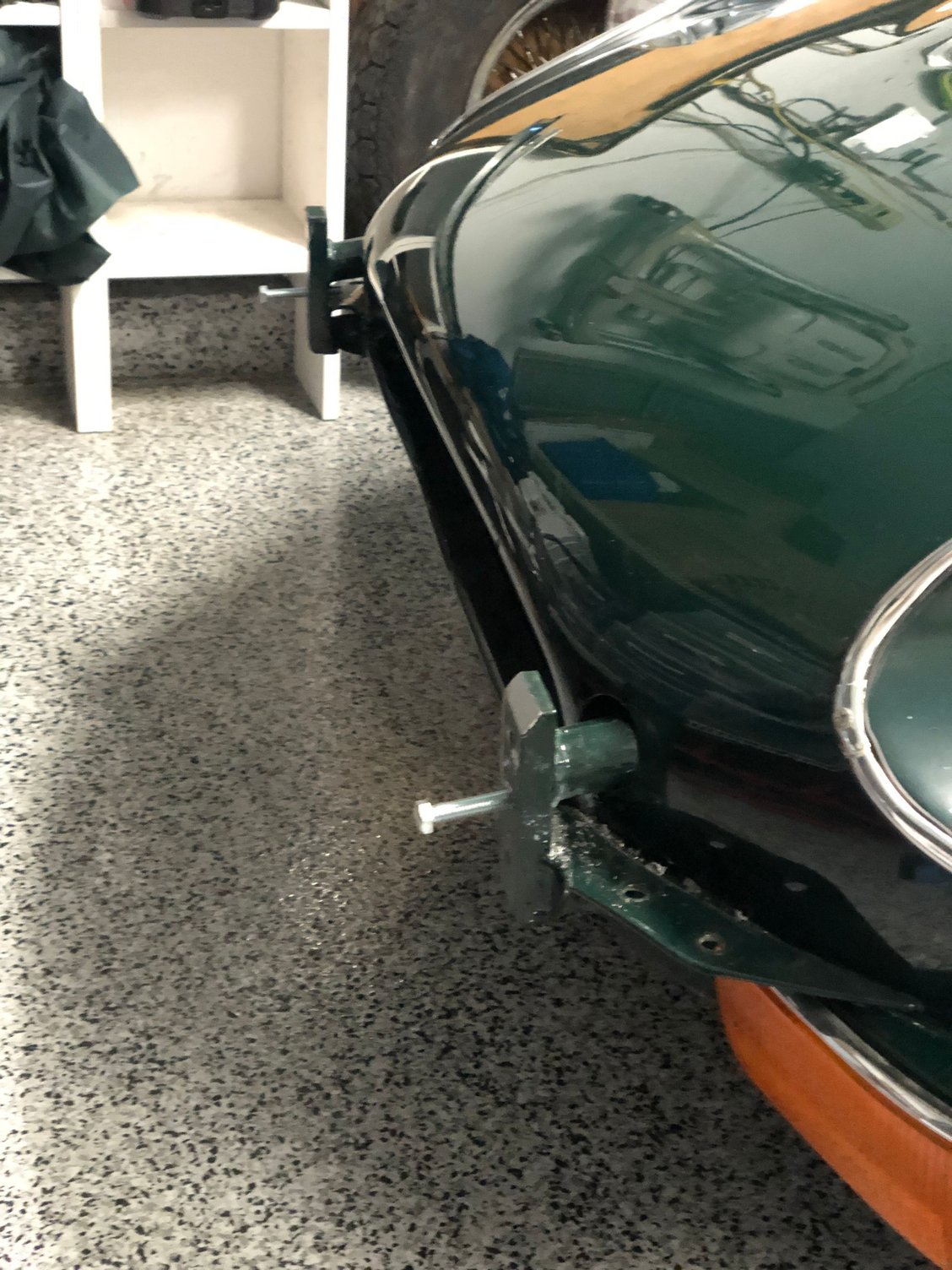

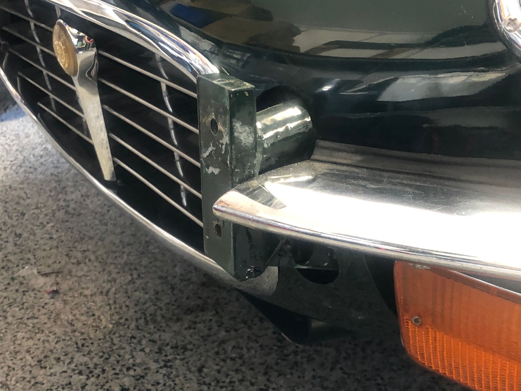

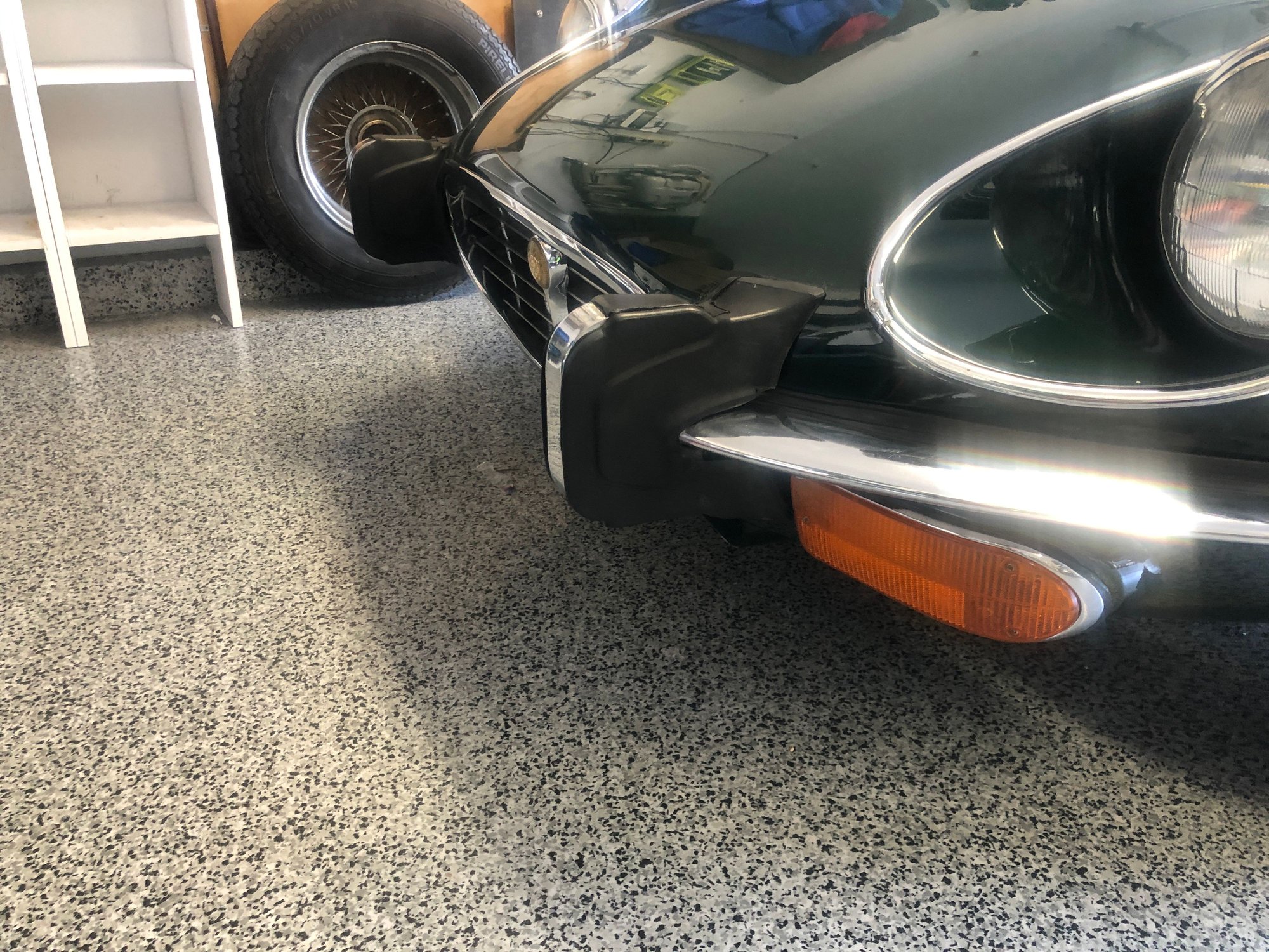

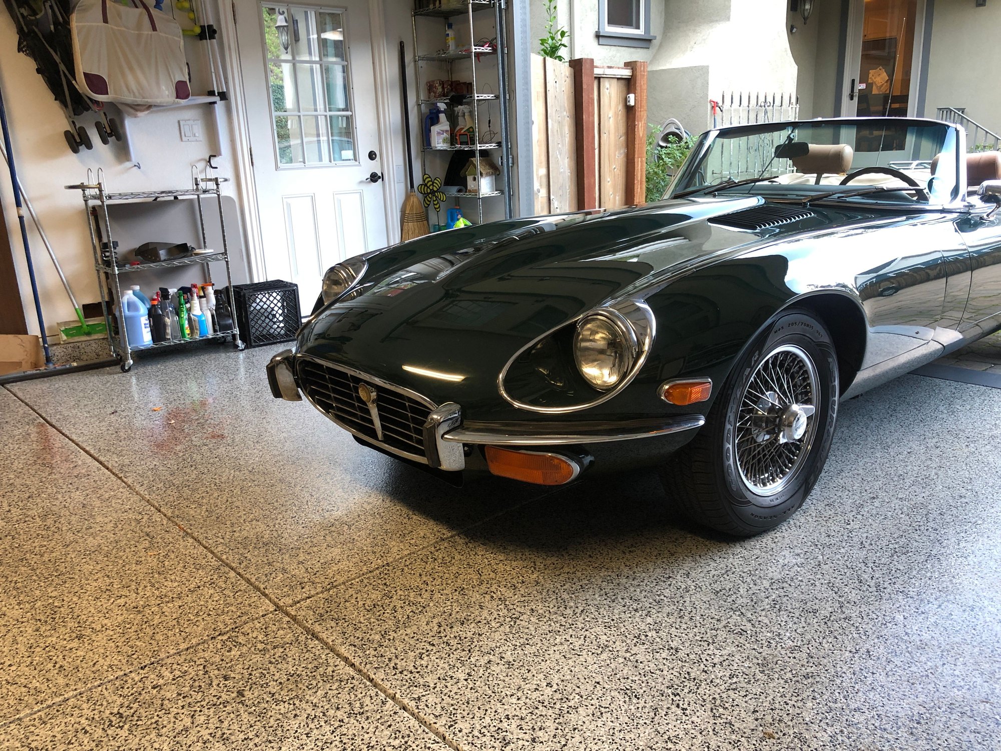

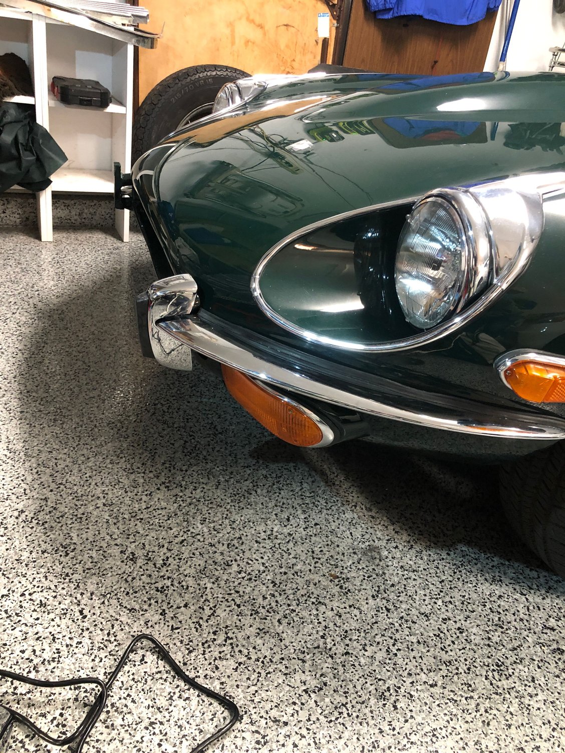

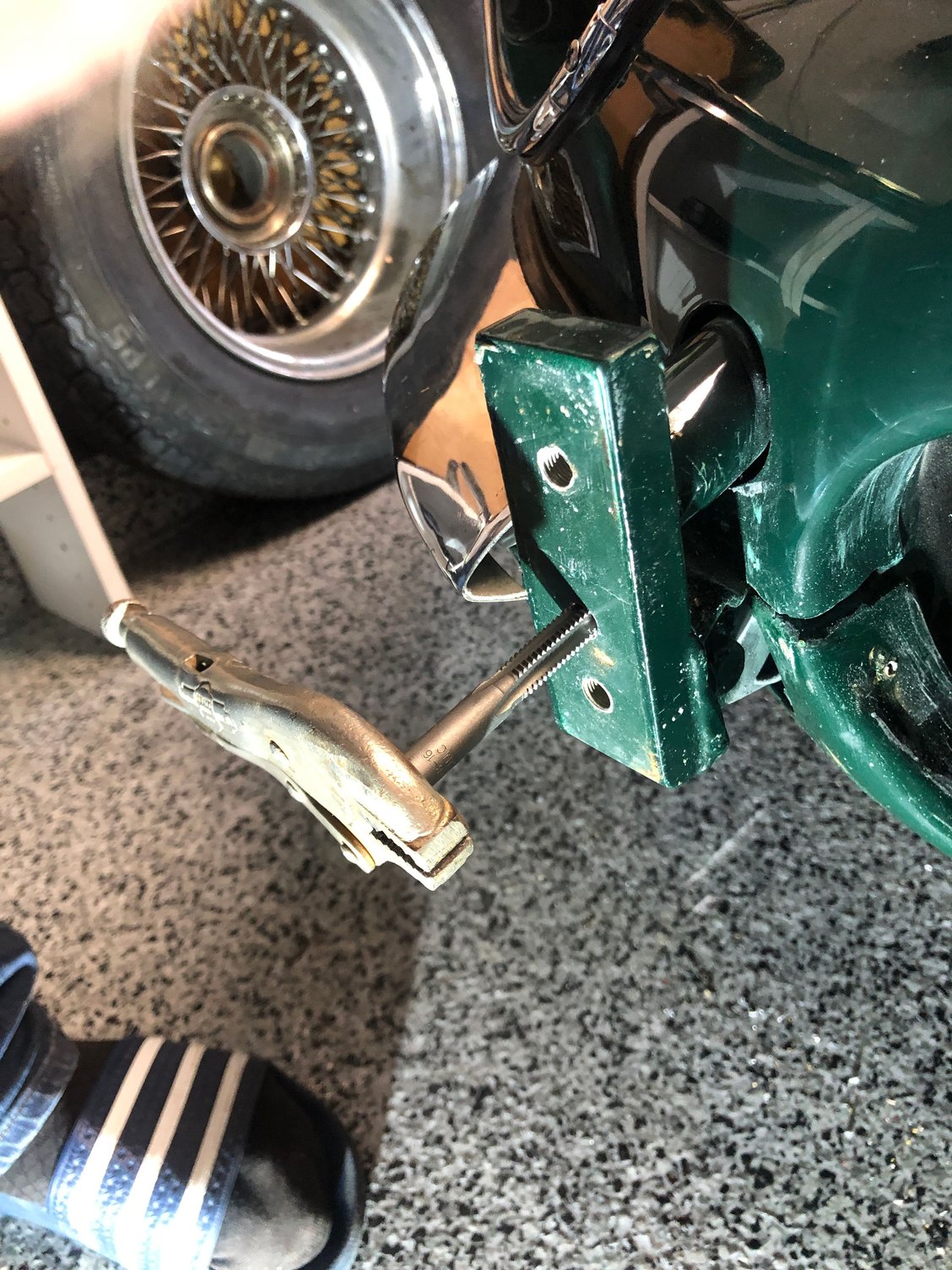

My '73 wasn't broke, but I fixed it anyway and I'm very happy I did. You're correct, it'll cost a little over $300, plus a little elbow grease.
In my case I bought the 2 overriders (BD38803, BD38804) from SNG Barratt for $289. You'll also need an angle grinder. I got this one for $40 at Ace Hardware. And you'll need a tap to thread the mount holes.
Here are some "before, during and after" photos (yes, I know the overriders are upside down, I think they look better that way. YMMV ).
The changeover is reversible, so keep the original overriders in the event of resale.
Cheers,
Rick
Before
Overriders removed
Tapping the bolt holes
Bumpers removed, grinding complete, bolt holes tapped
Trial fit "rightside up"
Trial fit "upside down"
Project complete

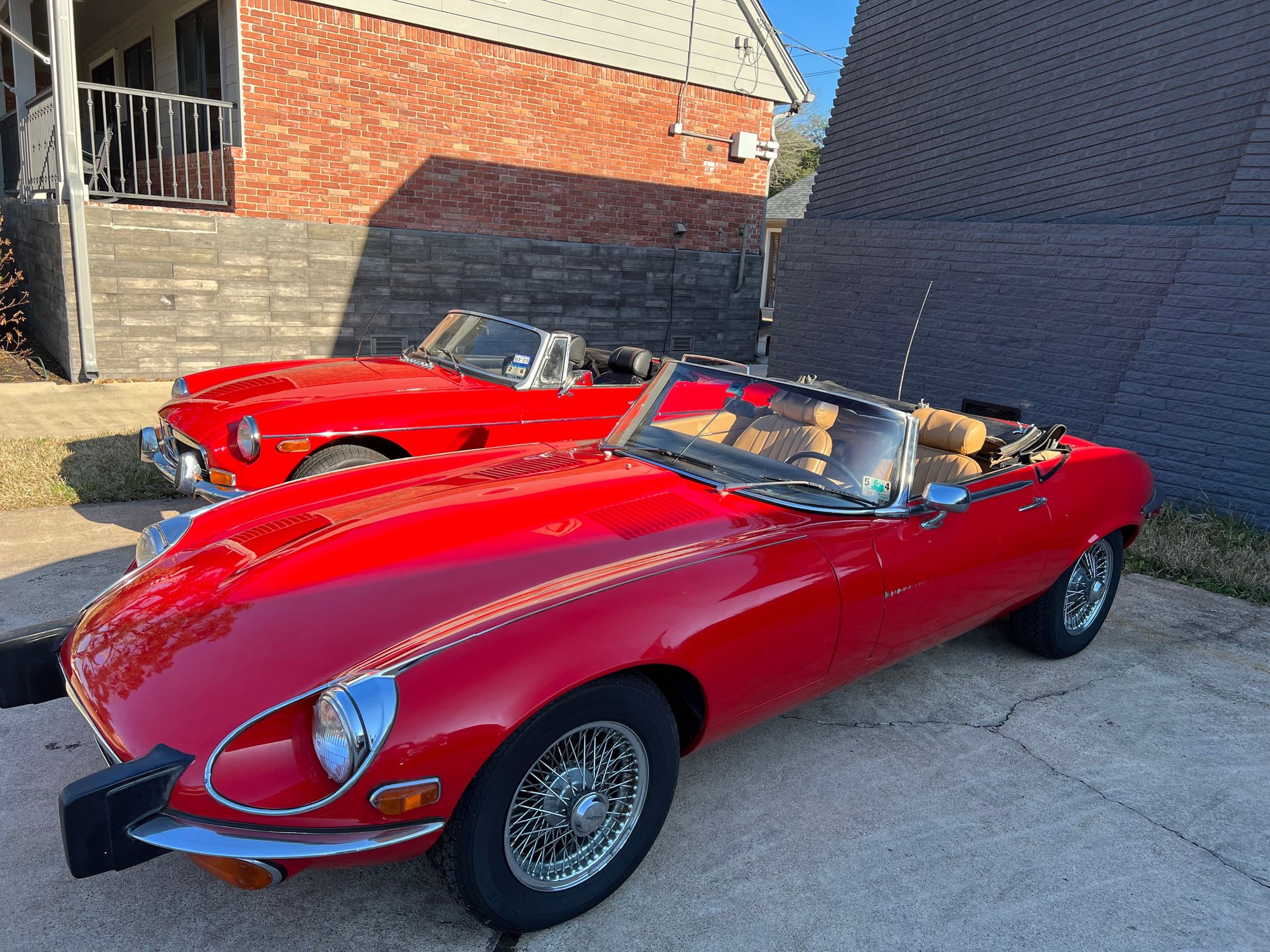

EGOLD56

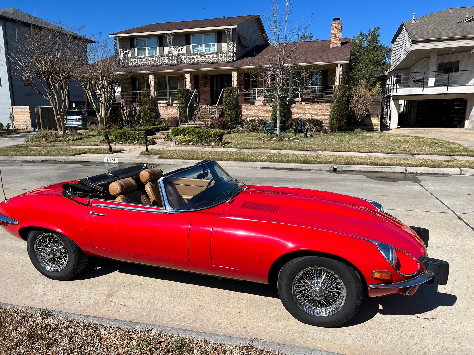

While it's not my place to spend your money, IMO it was well spent to make this improvement to your car. They can be a PITA at times and you wonder if they are really a car or a money pit. They are not making these cars anymore... they are history as well as historic. If that is your red E in the photo... it looks very nice. Go watch some of the YouTube videos where Es that have been sorely trashed are being done over. Yours is FAR nicer, and you WILL get there with all the work you are doing.
Old Mar 27, 2023 | 04:17 PM
egold56's Avatar
Joined: Nov 2022
Posts: 74
From: Texas
Yes the red one is mine. It was in storage for 20 years and I have spent the last six months and thousands of dollars getting it running. Believe it or not the A/
C actually works now. It is also getting new shocks. Yes it is a PITA.
