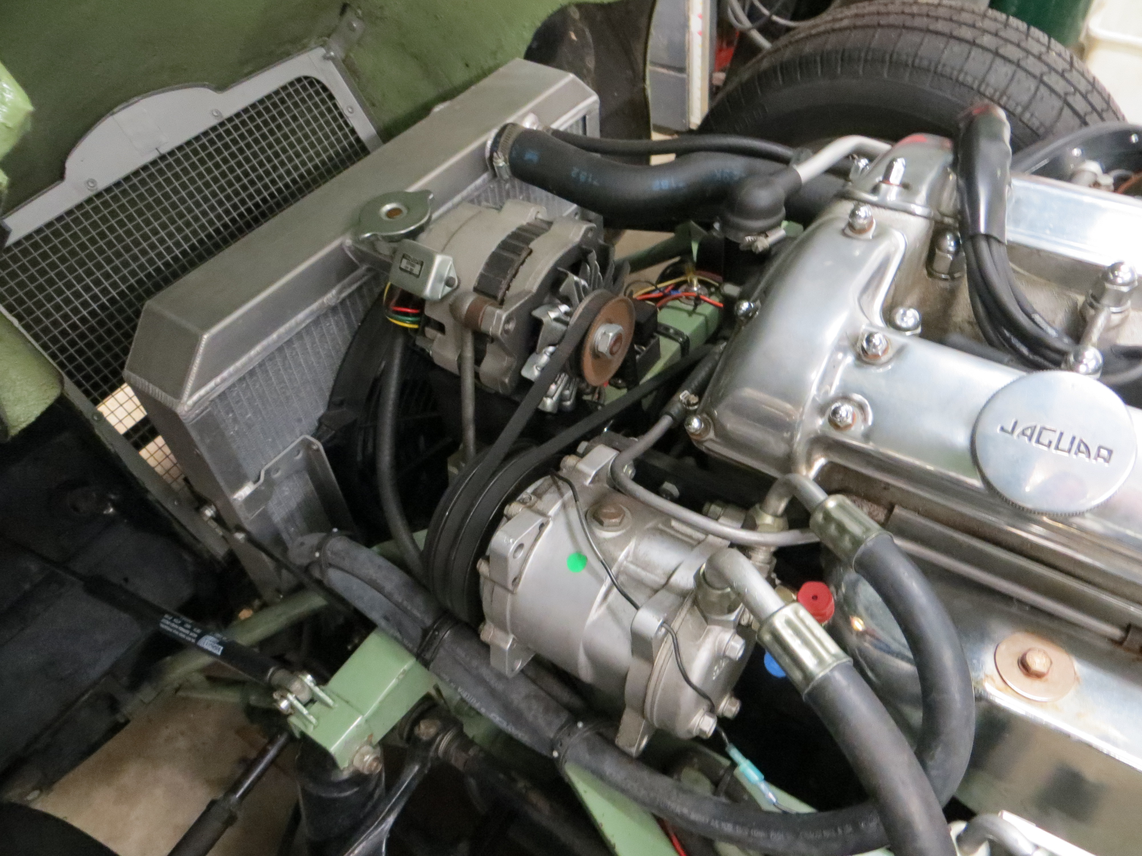

Mark ,Next week I'm going to try and post many upgrades with my 4.2 series 2 .
Over 30 years and me and my friends use them a good 6,000 miles per year!
Great start what you posted....
1. Do you still have the twin strombergs or triples?
2. I swear by a k+n filter , its good for 3 to5 degrees.
3. Aluminium rad and a modern electric fan will help HUGE!
4. Ive done tricks like the series 3 xj6 exhaust cover, hayden electric switch , they all help.
I did another trick today but will put 1,000 miles next week to prove it out.
Also a 160 thermostat will help when tied in with the hayden adjustable switch.
The otter switch and original rad with the twin fans is sooooo out dated and one removed will save at least 60 to 70 lbs of dead weight.
Good luck!
P.S. you did bleed the block running the heater core correct?
GTJOEY1314

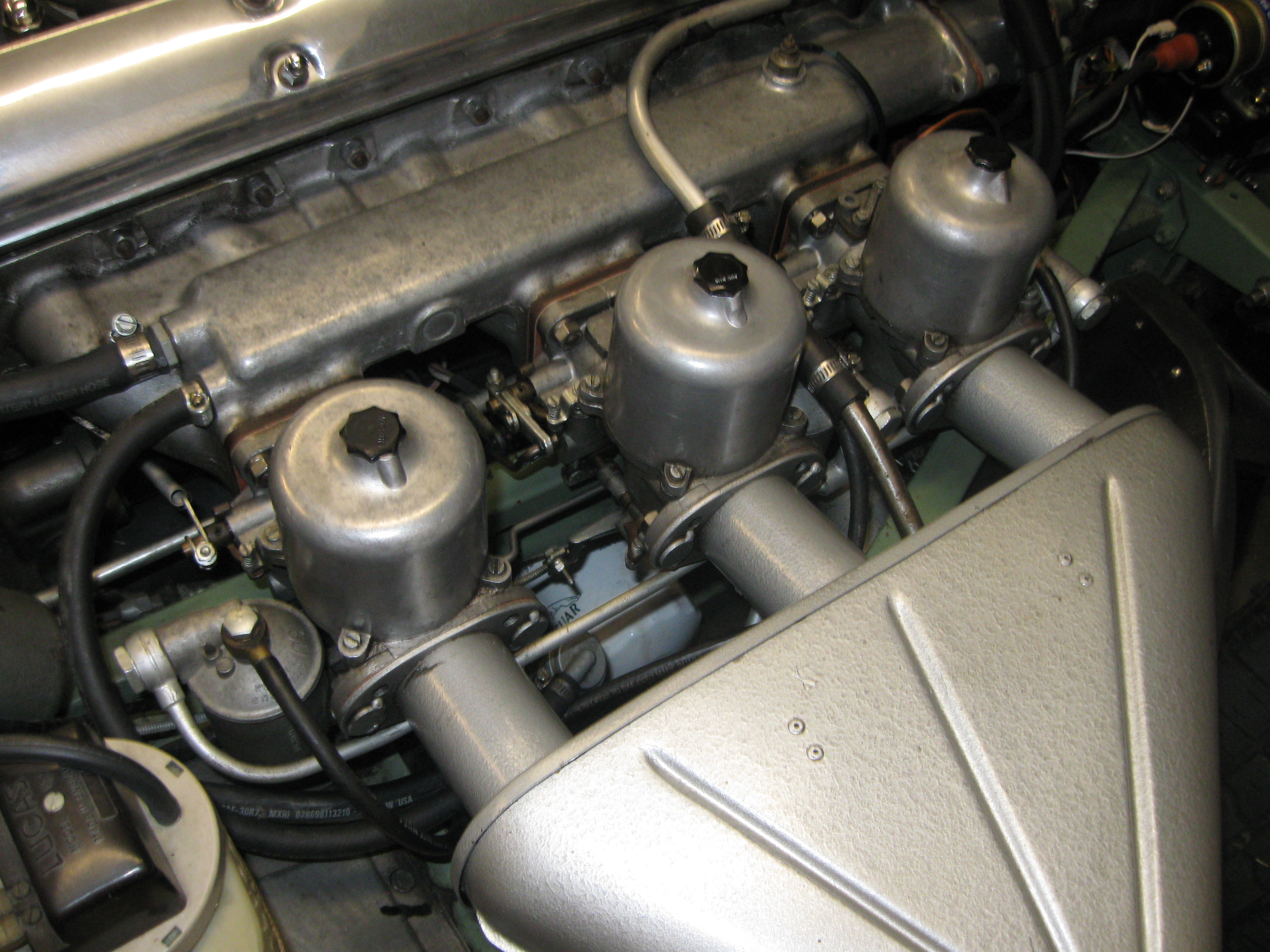

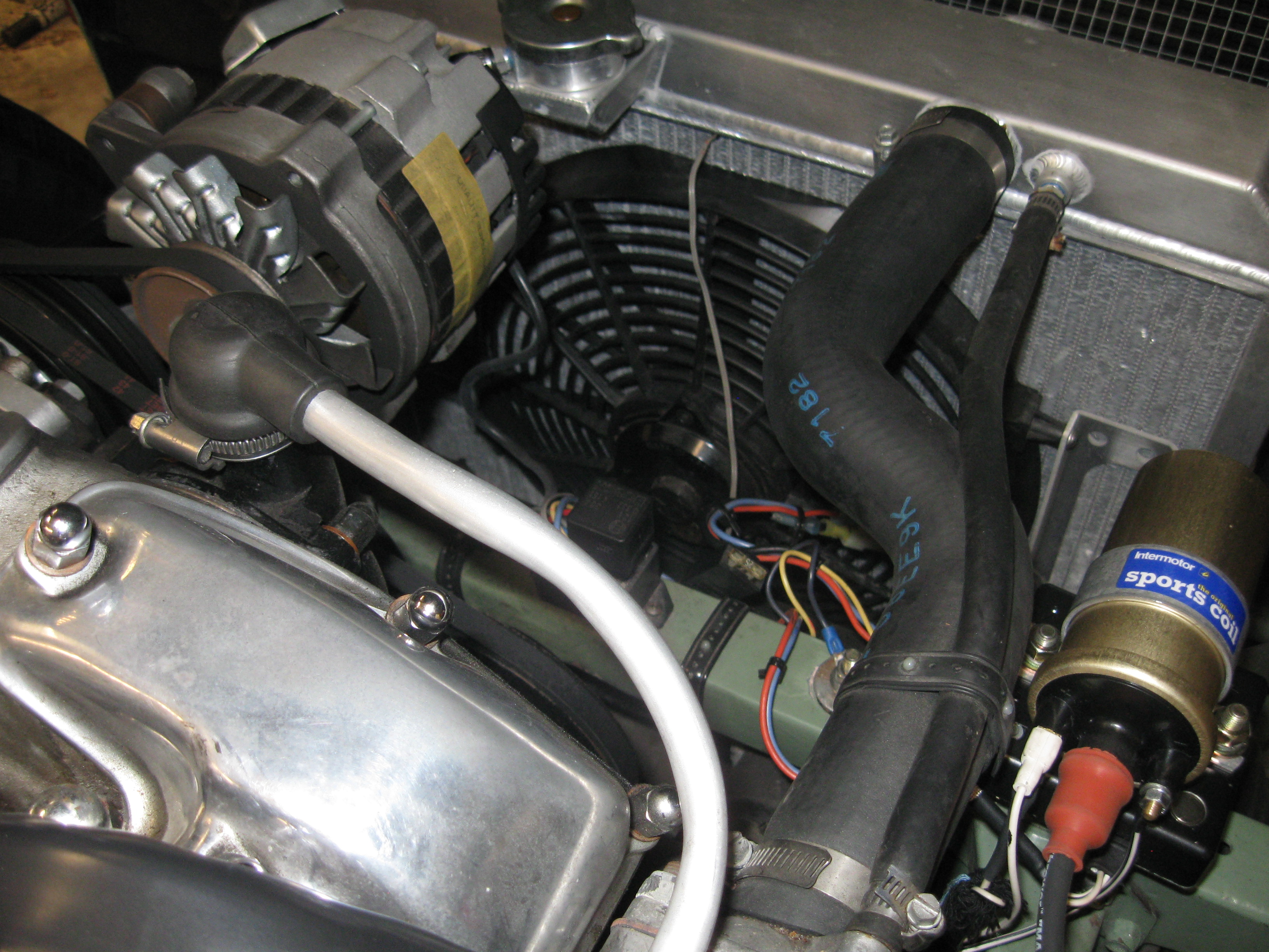

Originally Posted by jmgtaylor
Hi yes i bled the block the coolant level is good though lost about a cupfull in the 2500 mile trip so am not concerned at that possible a slight weep somewhere. Got rid of strombergs put 3 off su on with kn filters. Car was then set up by mcwilkinson in doncaster uk. I got rid of the poor s2 fans and put 2 if revotec tye units i, otter switch is working fine have a bypass switch and a light so in know when they come on.my suspicion was rad at low rpm sat idling in traffic. It did get very hot outside temp was 30 degc too at the time.
Good Man!
You need the radiator and the hayden switch , this way you can dial in when the fans kick on each car is different.
Thankfully you switched to the triples.....
No offense but the twin strombergs unless for show are not real etypes.....
IMHO.
Take a look at these enjoy my friend...........
Keep in touch. Once you get the aluminium rad and switch, it will be night and day.
Good luck
GTJOEY1314
