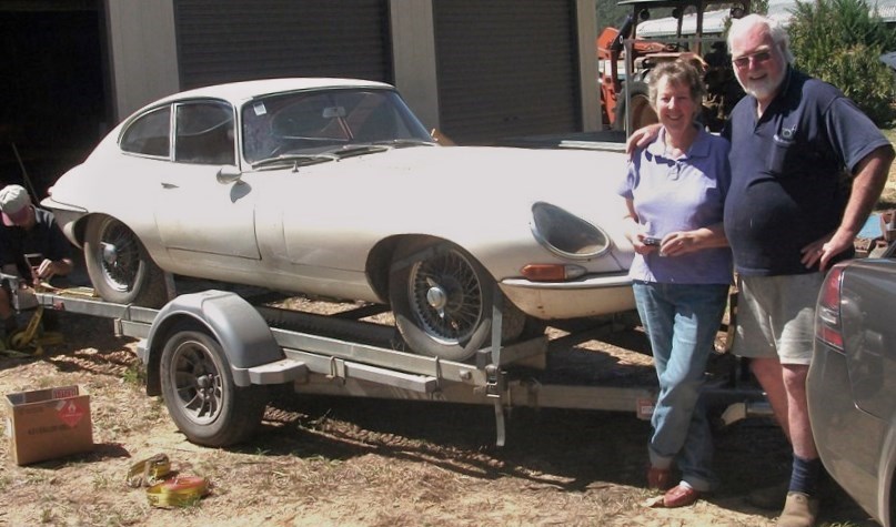

Sorry folks ... just learned that Paul Skilleter's book I recommended is out of print. What a pity - the ideal DIY companion - saved time, cash and made upkeep of our E Type enjoyable ... eBay?
Yes, Fraser, E Types are expensive, but have been for many years. In Oz anyway, secondhand prices were modest only once replaced by new models. Values rose rapidly once Jaguar failed to market a true sports car replacement. I would not be alone in suggesting that much of the mystique of the E was not only that it had no affordable peers in the decade before its debut, none (imho) during the decade it was produced, but also little of note in the decade following. We spent about 12 years having made our choice, and enjoying a succession of Jag saloons, but never an XK until careers and finance got us our pristine, superbly maintained and documented S1 in 1982 - for a price that was exactly half what we paid for our modest country Victorian home - also in 1982.
10/10 also Fraser, for pointing out the E Type weakness of metal cancer - doors, sills, coupe hatch, rear numberplate area, wheel well, floor wells, and even headlight nacelles, must be inspected and maintained. But ... and it's a huge BUT ... we can reassure our OP mulhollandmaster that this was never a killer issue in the warm dry climates that we share in US west and south west and much of Australia - provided the car does not live outdoors at the seaside! Best advice ... ensure your car was a new car local delivery, and not a later import that may have spent destructive winters in ice, snow and slushy salted roads. Zoom into the attached pic of our S1 as it leaves home for the final time to friends and new owners, and you will note ripples starting to appear in and around the door - but in a car that has never been accident damaged, never restored or even resprayed, it approaches its 50th birthday in remarkable style. Even so, the new owners plan a total ground-up strip and rebuild to achieve true concourse condition that she deserves.
This brings me to a too often neglected topic - detailed provenance. This is far more than just owner & service manuals, and a haphazard collection of receipts. Our S1 came with a bulging folder of documents, much of it assembled by the local Jaguar agents Brysons at the request of the first owner whom we were able to contact, who added even more photos, stories and memorabilia and confirm we were the second owners. Over more than 30 years, we were able to dig out even more details and documents from Jaguar at Browns Lane and Australian distributors - then build the lot into a sequential, uninterrupted narrative. While respecting the privacy of her new owners, I can state that this provenance formed a sizable premium that was negotiated as part of the recent sale.
Mulhollandmaster, I sense you teetering on the brink ... Take 3 deep breaths; accept the initial pain of the price premium, and I encourage you to go with your heart. She will return the love tenfold every time you punch that starter button ... Clutch; slot into 2nd; ease away at 1500 rpm ... now push hard and 50 yards of road disappears as the long bonnet leaps up ... 4000 rpm; lift briefly; stick over into 4th; full throttle; and then back off as our Abarth free flow exhaust comes on song ... 70 to 100 mph is like a rocket ride. Yes, it's a 4speed but this is sooo impressive. So is downshifting to 3rd at 110 mph, and still having bonnet snapping acceleration.
Just reliving it is exhilarating ... Now, I'll have to get my medication and lie down for a while ha ha ha
Remember ... If you don't get it ... you won't get it!
