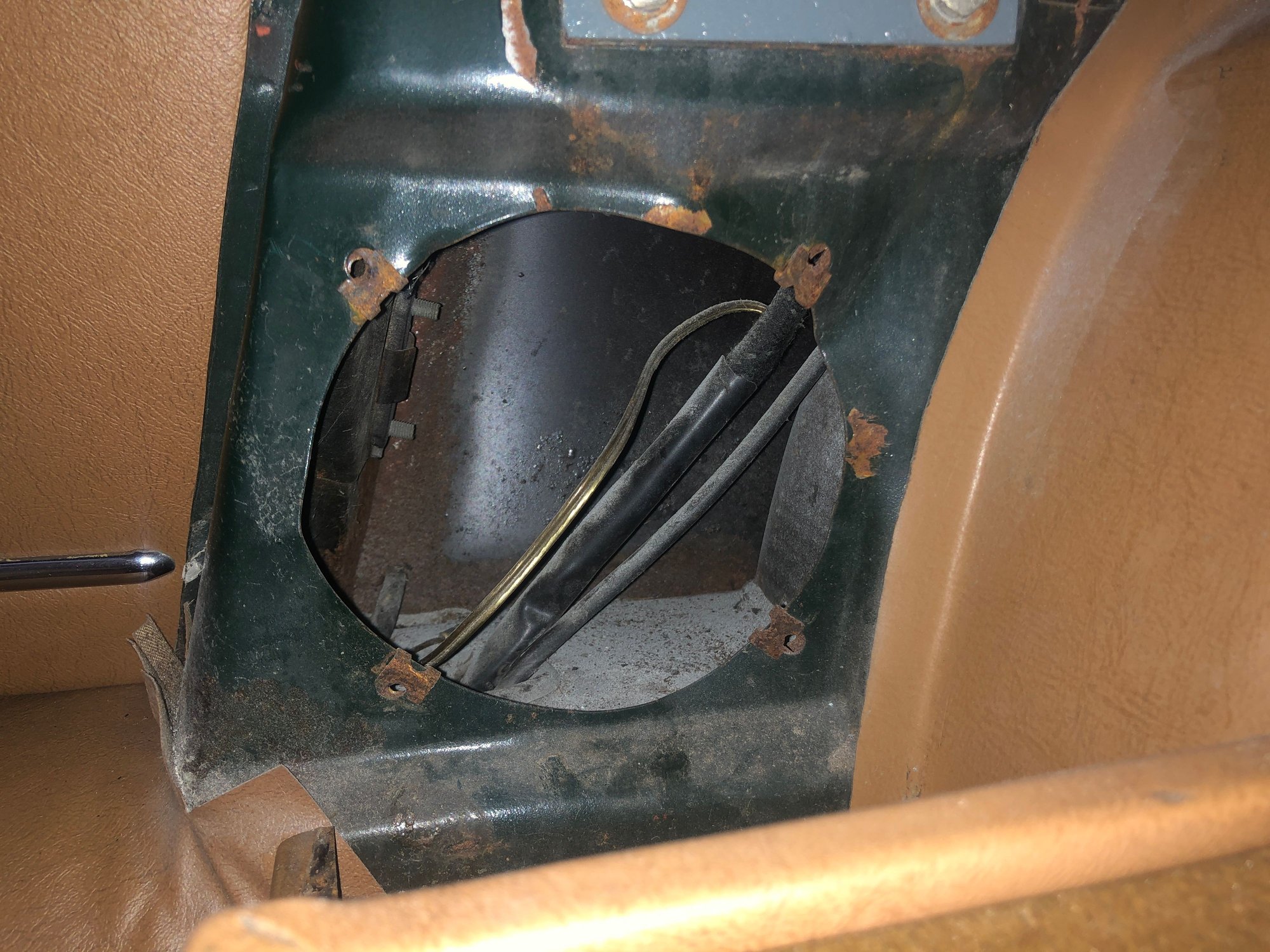

The thing is, the car's speakers are missing. So I want to install speakers in the original mounts (behind the seats on either side - photo below). I measured the diameter between the mounting holes. 6 Inches. So I ordered "6 inch speakers" on Amazon. But they don't fit. Then did a little more research to discover that "6 inches" is really only a general category for speakers, not a specific size. Sigh.
So the question is: does anyone know a specific speaker that will fit the original unmodified mounting holes?

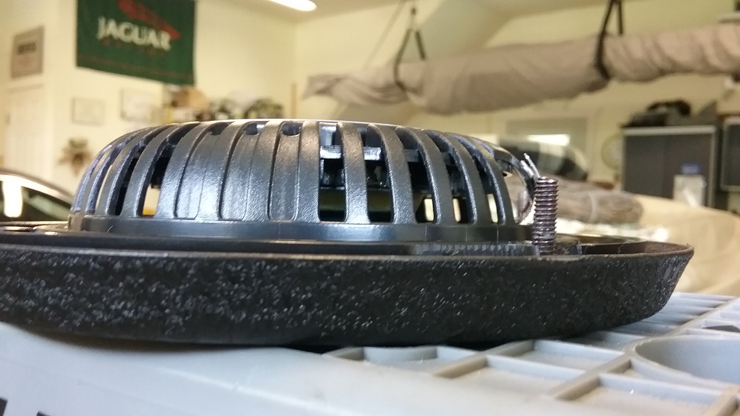

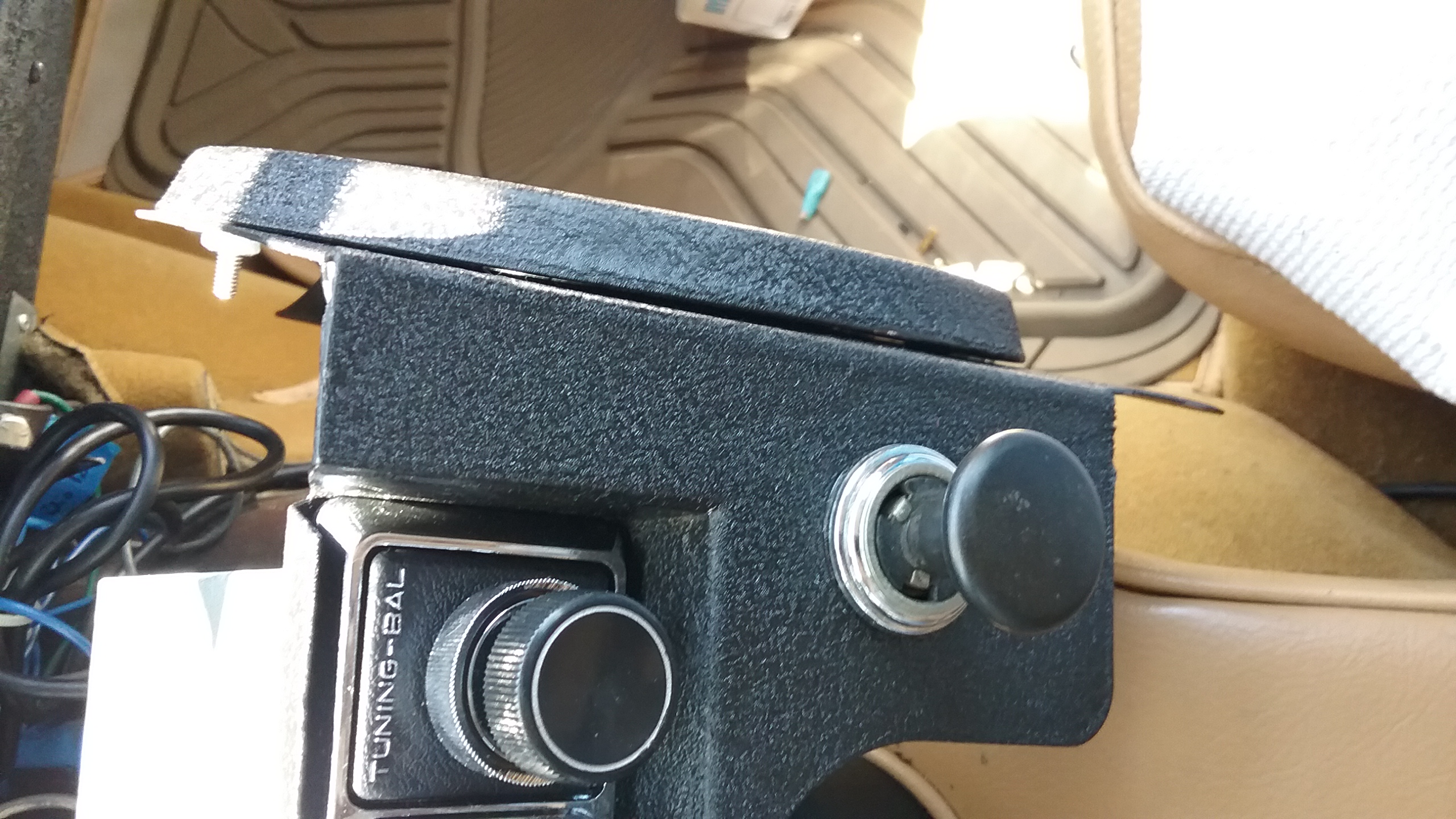

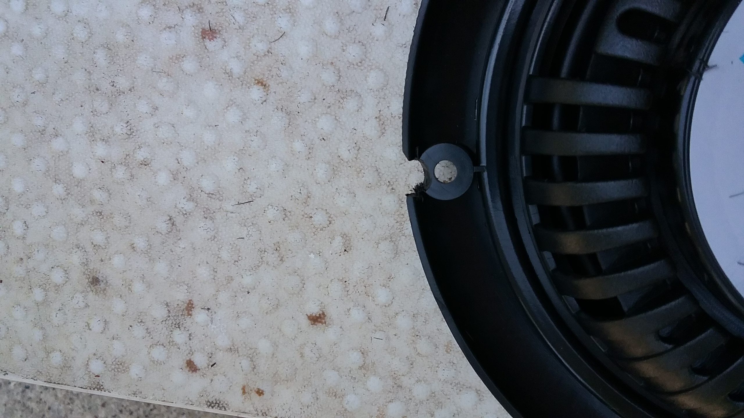

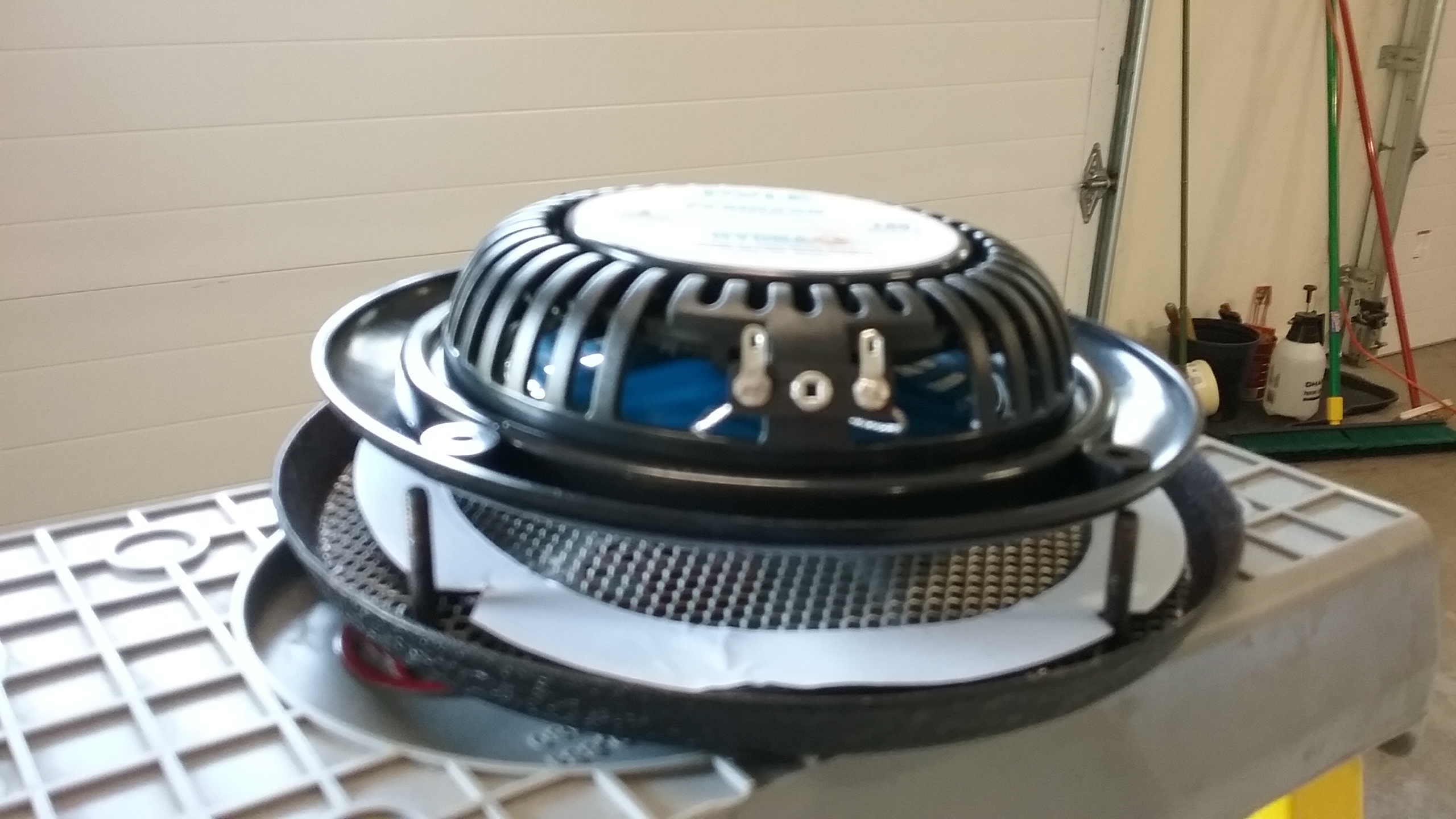

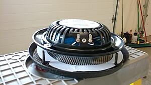

I looked through the BAT photos and could not see where this speaker opening is. I have a Series 2 and had good success with these PYLE speakers, 5.25 inch. They are Marine speakers (good for an OTS) and have a low profile. They come with a substantial amount of speaker wire. I'm also attaching some of the photos of the install, in case this would help, or give you some ideas on yours. I had to Dremel out a bit of the speaker surround to accommodate the original speaker grille's bolts.

  • I'm attaching a photo that should give you a good idea as to where the speakers are located (behind the seats as irgridley mentions).

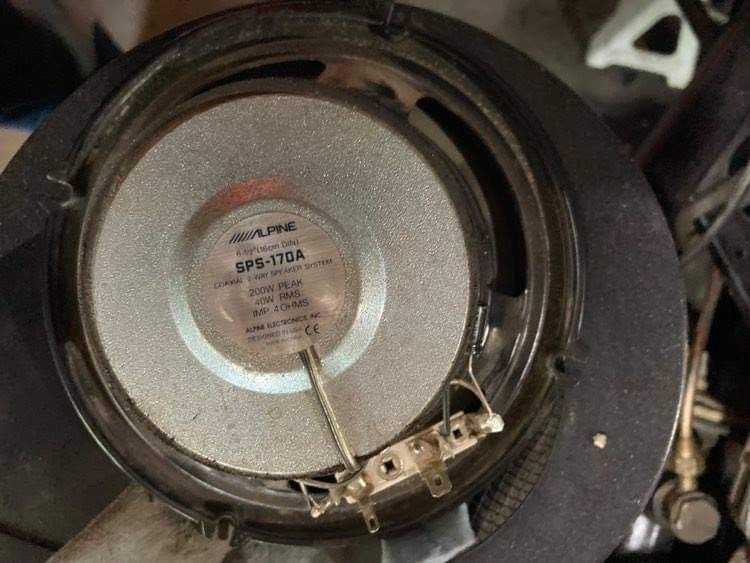

Rhvh2000, I have a ‘74 SIII OTS that I am reassembling after a paint refresh. For the rear speakers behind the seats, she has Alpine SPS-170A speakers. They fit perfectly with no alterations needed.
