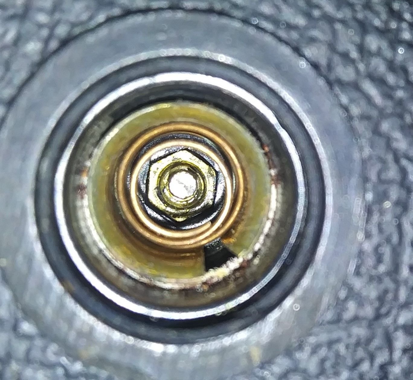

The bulb to the left of the steering wheel on the instrument panel for the parking brake is missing on my series 1.5 I cant find this bulb for sale anywhere. Check out the slot at the 5 o'clock position. It looks like it is for a single side post bulb?

Hi racerxf12004,
You mean you can't find the bulb locally? I would imagine that places like Moss, SNG Barratt, Welsh, and others would have the bulb. For sure British wire would have it.
Bill.

It should be a LLB987 bulb.
