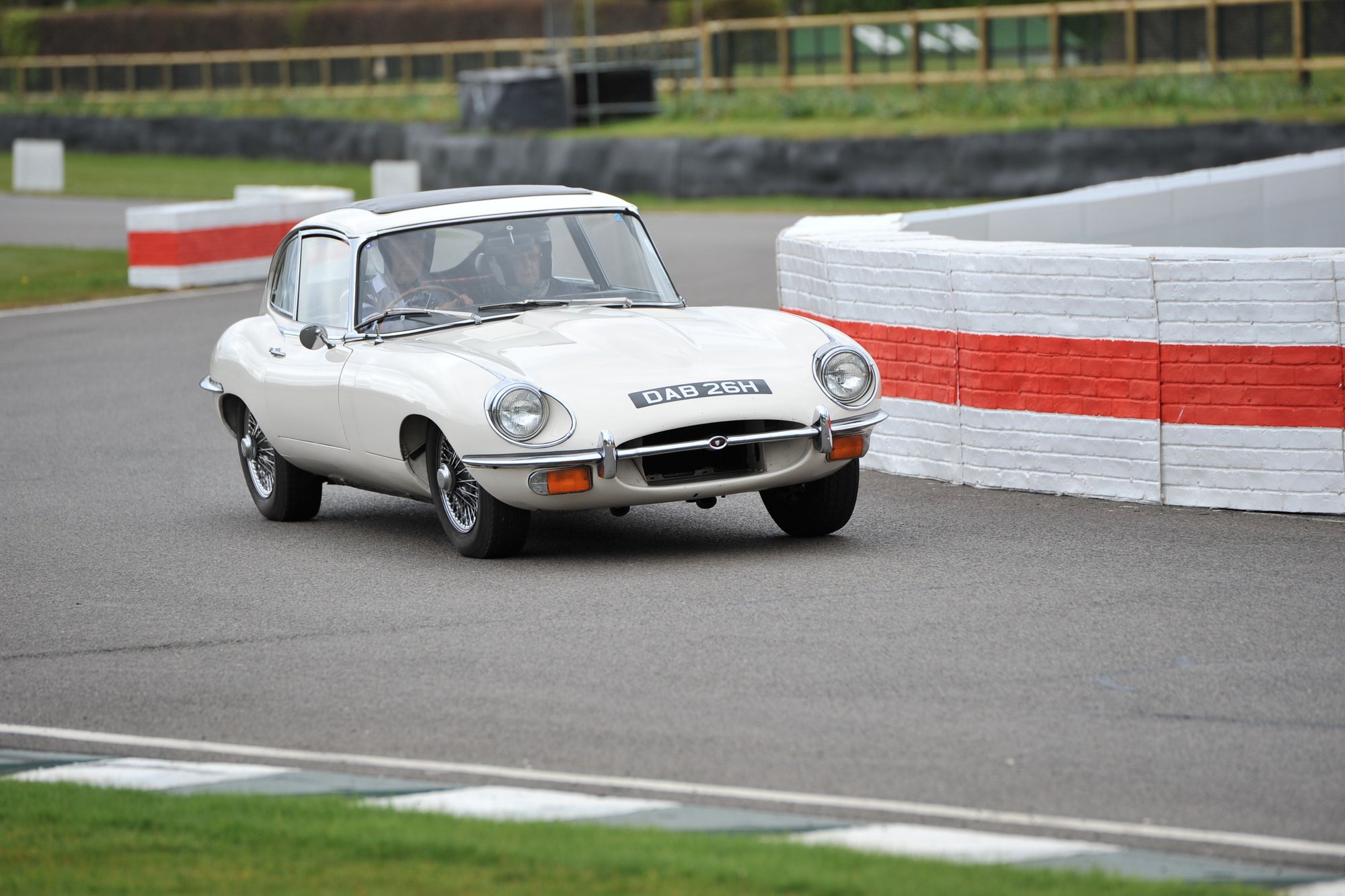

In terms of traction and handling, many people fit tyres larger than original. however, I feel Jaguar, and Norman Dewis in particular, knew what they were doing. I stick to the original 185/15 and have used them a lot at Goodwood, where they have never let me down. Wider tyres may look more "modern" and fill the wheel arch better, but this isn't a modern car. Wider tyres can make it feel heavier with less feedback. Too wide and you won't change a wheel on the road!
The picture shows me coming out of the chicane before the grandstand straight. Inside front wheel just starting to go light, but the 185/15s hanging on well.

Great Picture! It looks like you were having fun on the track.

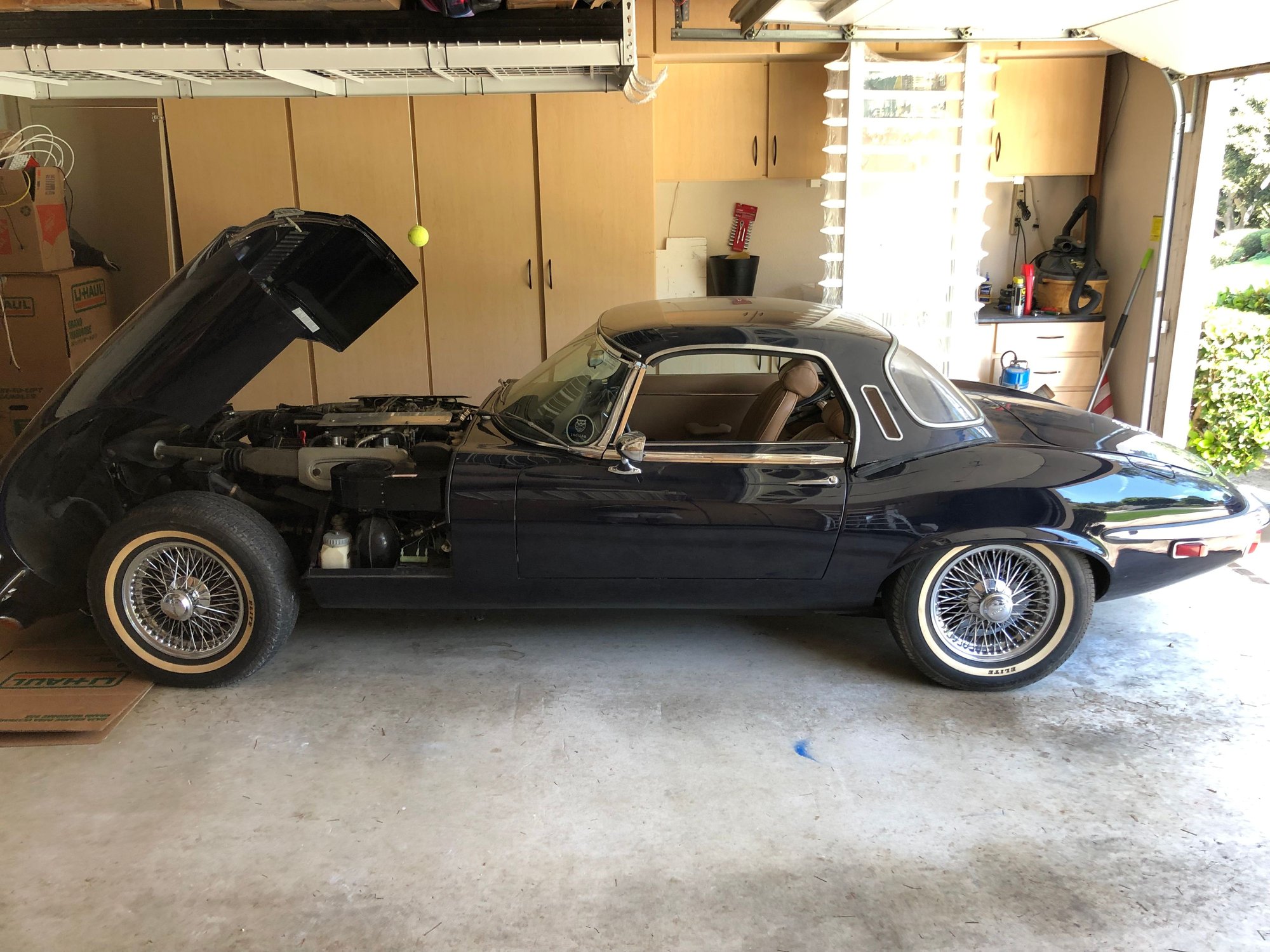

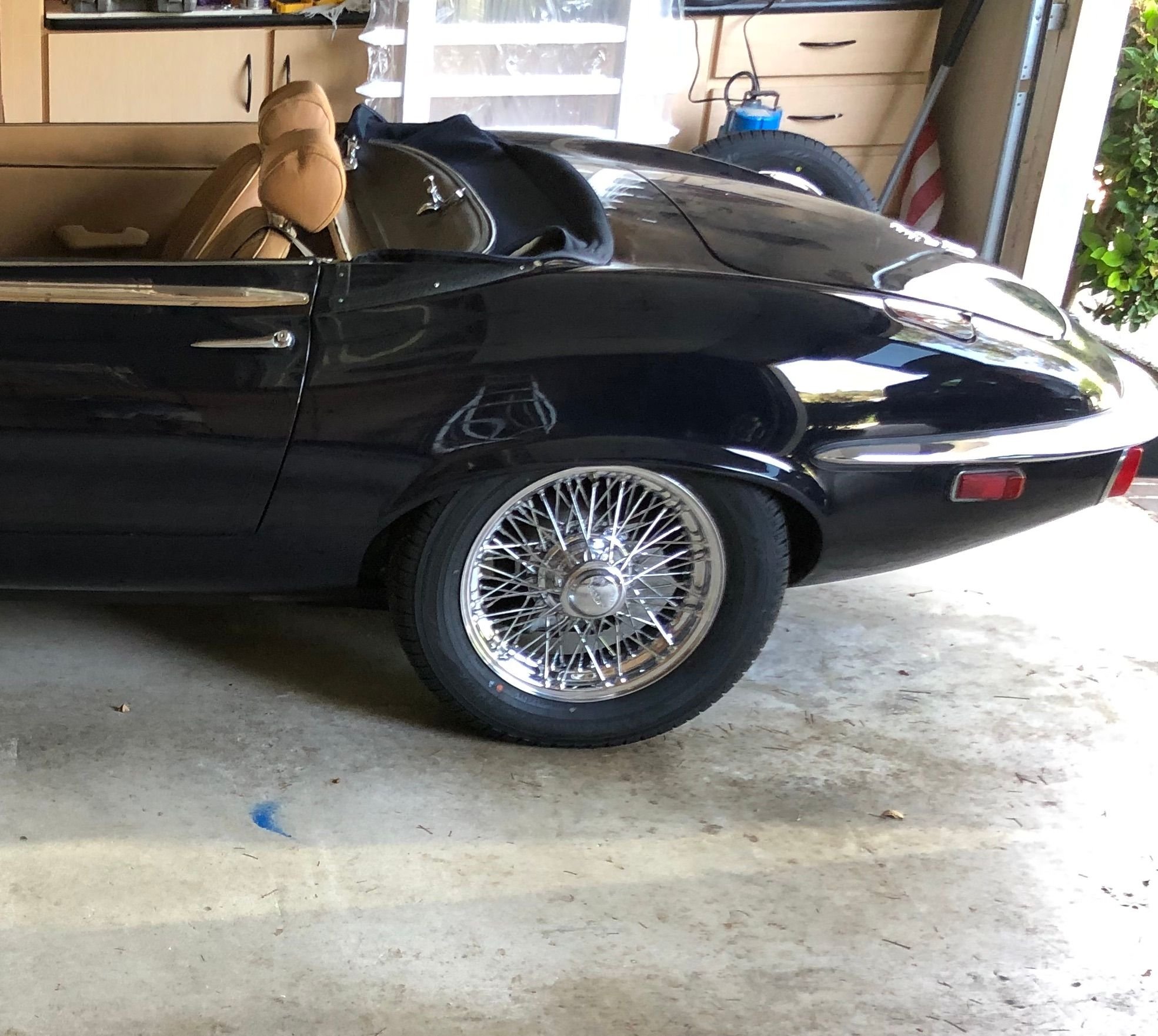

Do they have any markings on them? They are most likely 16” x 6.5”. I have 16” x 6”’s on my 74 OTS and the look is very, very slight and that opens up a lot more choices in modern rubber if you drive a bit hard. I’ve read that 6.5” is right on the cusp of what fits when turning the wheels. The 6.0” do not rub at all.
I bought a set of Competition laced wheels that are stiffer for cornering and prettier. I fit then with some Pirellis and they mounted perfectly in the rear since the brakes are inboard. But the front didn’t clear the slightly bigger series 3 disc or caliper. I called back Dayton and they realized I had the Series 1/2, MK2 wheels. I have them on the Hemmings classified inexpensively as they made me a nice deal on the new correct ones.
This is the goal on a different “dream car”
This is with the original 15”
This is the 16” x 6” . Notice that the edge of the rim sits right at the fender height in both.
