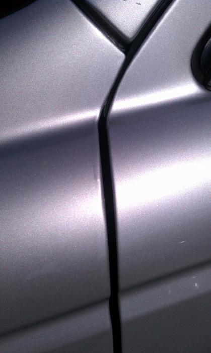

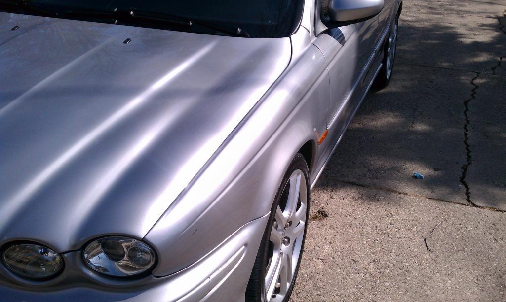

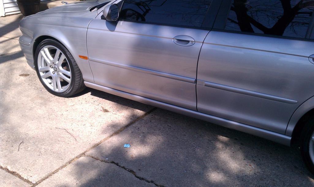

Hey Guys/Gals,
I had my car fixed after a fender bender and kinda got shafted on the fix.
The dealership said they just got a state of the art body and paint shop. So they took the car in, and when I got it back the hood was a significantly different color than the Platinum OEM paint.
So they took the car back fixed the hood color (not perfect) (minor tiny bubbles) and then I saw the fender which is way darker (the pictures below).
The manager told me that since the car has been in the sun and outdoors the paints are very hard to match due to natural wear, which is understandable, and that the paint will fade to the same color of the car (Really?!) but when I got home, Not only did I notice the difference, the girlfriend and neighbor even said something to me about the difference. Since the car was in the shop lights, and and a slight angle its no biggie, but when anyone looks at my car in the sun or pure daylight its 100% noticeable.
Tried calling Jaguar corporate since the guy gave me some attitude when i doubted his shop, all you can do is just talk and then you get the "Sir I'm so sorry Sir people". I gave up on the shop when they said give it some time to fade.
My question to you guys/gals is How much would it be ,ballpark figure, if I took off the fender myself and brought it to a noteable shop to have repainted? I know I could just go there, but I'd like to get a fair and honest opinion of a paint and body guy thats done the work before I get the "its a jaguar so it'll be more."
What do you think of this work?
Thanks before hand to all that respond and help me out.
- Dave

I've never been a painter, but I've been in the business awhile. As the old saying goes.. sh*t happens. But as a business providing a service to a customer, you make it right.
It's not unusual at all to not have new paint match the original. I'll say that silver is one of the most difficult colors to match. But this is fairly normal. What's not normal is the recourse the body shop took in the repair. What should have been done is blend the paint into the adjacent panels to minimize the appearance of mismatched paint. Even the best body shops out there do this. It costs more both in time and money, but it's realistically the best way to take care of this issue.
Just curious, but what insurance company paid for the repair, or what is an out-of-pocket deal? Some insurance companies are notoriously cheap, especially some of the fly-by-night companies.. they'll literally pay just enough to get the car back in one piece.
All that being said, removing the fender and taking it to a more reputable shop will likely give similar results - they'd probably ask you to bring the vehicle in, so they can blend into the adjacent panels. Because honestly, that's the right way to do it. You're likely looking at several hundred dollars considering the paint, materials, and time involved. Easily $400 in my area, if not more.
Hope this helps, and good luck!

Sorry for the late reply on this, I just saw this thread. After looking at the pics, all I can think is THAT'S F***ED UP! I think I could match the paint better with a box of 64 Crayola crayons. I don't care what the dealer is telling you, that's just a bad paint job. If the dealership is giving you the runaround, you need to drive the car down to the State Farm office and show them what a lousy job the dealership did. State Farm will make it right. They guarantee the work of the body shops. They may try to send you back to the same place to get it repainted, but just explain to State Farm that the dealership painted it and it was wrong, then they repainted it and it was still wrong. You'd like to go to a shop that will actually make it right.

The whole front of the car is far darker than the rest of the car. So I assume you have had all panels at the front repainted.
The whole point about bodyshops is that they are supposed to be able to match up to the existing colour even though it may be slightly faded. This is done by use of correcting toners and colour testing. However, metallics can be notorious to match, and yours is, or course, a metallic, and silver as well !!
A "state-of-the-art" shop should be able to compensate for fading to some degree. Normally this is done by fading out along the length of a panel, not finishing at a panel joint or line, which makes the repair obvious

Well, before reading any bid of the post, I did look at the pictures and could easily state the color difference.

prett much everyone gave you the correct answer. You should never PANEL paint, but blend adjacent panels. And the paint can be matched even when faded. But yes if they just took the paint color and mixed like it was new, this is what you get. I watch the mobil paint guys come onto our lot and perfectly match , blend, and repair right in the back parkinglot out of a van or truck bed with fast drying hardners. I really think they do a bteer job than many paintbooth repaints....but again it always always depends on the PERSON doing the work, not the shop

BLEND(adjacent panels),one time i opened a can of basecoat and it just struck me as `too green' AKA`greener than' the shade on the car,,i prepped and blended the whole side,it matched(EDIT=my point here being although i was repairing a small dent on one door,i didn't have time to do it twice,i told the owner`don't tell anyone i painted the whole side of your 2 year old Lincoln Town Car for 250 dollars',but i did it ~one time~ and everybody was happy)
but several points i'll make>#1 if there's any doubt when i first see the (agitated) paint=i'm usually correct in my assesment of`match',often times adjusters will stipulate`nothing extra'(suplements) attempting to force a shop to `panel paint' or`butt match',,however MY assesment is you are not building a sound customer base by doing business(butt matching) nice vehicles.it can be done but i would have to start talking`alternate formulas' and i'm already typing a book here soooo>
sorry for bad or no editing i'm in a hurry,,30 years in the trade(read my intro)#1 contact your insurance agent and disclose your unhappyness,they are after all going to lose money when you go to a company that will take care of you.
looks like the hood/fender dosn't line up in front?,,
i could go on into todays color matching`technology' the paint manufacturers came along with and it is much better support than 30 years ago when they use the`sun fade' excuse(ever hear of an electrophotospecterometer?,the body shop that did your fender certainly has as well as`fan decks',do some research)so therefore there's no reason to send a nice car down the road with TWO colors on it,feel free to PM me if you feel the need i have to run and prime a dash on an old convertible,good luck and post up what happens ,i'm glad to help offer explanations,,Dennis

When you blend into an adjacent panel you do not remove the clearcoat. The entire panel is lightly scuffed with 1000 paper. The base color is blended but not applied to the whole panel. You have to stop the color somewhere before the next pane. Preferably on a bodyline or curve. On doors I like to stop near the mirror where a shadow is usually cast. Then the whole panel is clearcoated. At least that's how I been doing it since they came out with clear.
So no, you can't start fixing dents or chips that are close to the next adjacent panel or you will be back to a panel to panel mismatch. If you keep going to the next panel, the whole car will end up geting refinished. Keep in mind the insurance company is only responsible to restore the car to preloss condition. This doesn't mean fixing things not part of the accident.
Where this shop went wrong was trying to panel paint in the first place. I would never consider trying it on a difficult color like silver with a high end car like a Jag. Just plain stupid on their part. A PPG instructor once told me to always blend into the next panel. The agravation created by a likely mismatch is not worth the small savings of time & material.
This is a perfect example. If they had done the blending correctly in the first place, chances are that you never would have noticed any color variation since you wouldn't know where to look. Now they have an unhappy customer that is going to examine anything they do. Really dumb.
