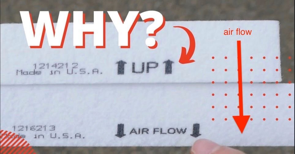

I'm a little confused. as there is an arrow and the word "UP" beside it and your telling me that it doesn't mean "UP" but flow direction???

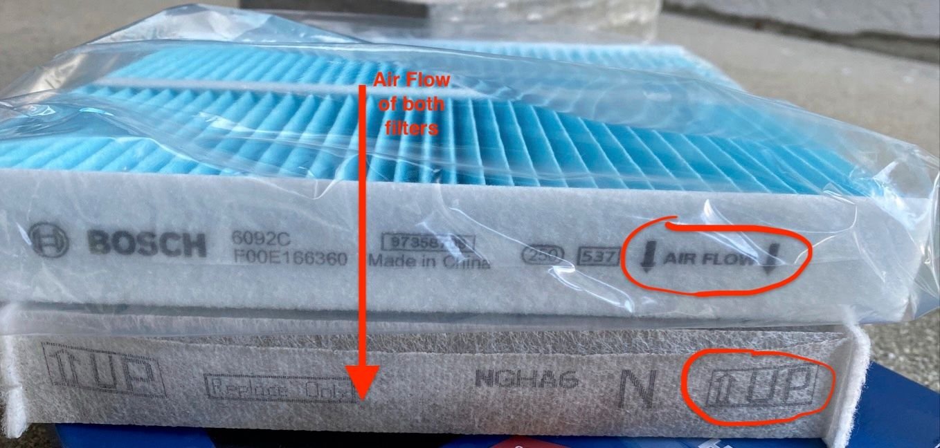

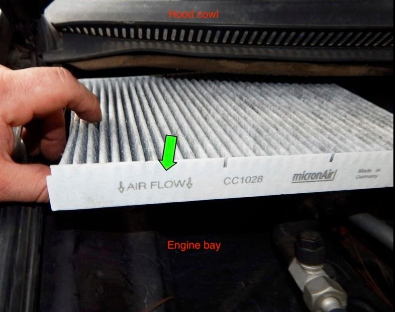

Post air flow confusion
Yes, unfortunately, it can be slightly more complicated. See the PIX in this post. The arrow is the airflow direction, but the Arrow with the up next to it is pointing toward where the air goes in and then flows down through the filter (so yes, it's pointing in the opposite direction of airflow, indicating where the air goes into the filter). In the Jaguar this end up arrow is correct yet the airflow arrow would be correct facing down. This arrow up filter is also used in multiple other vehicles like Toyota and is an instruction not an airflow. In some vehicles, the filter is installed on the edge so there is no up, on others the filter is installed vertically so there is no up, and on some it actually would be this end up facing down depending on manufacturers application.
In short, the arrow is air flow, but the up is air inlet and will depend on the manufacturer of the filter as to which one they use.

Ok, since I have the OEM filter with the UP label, I did see that aftermarket filters indicate air flow. Makes sense, thanks for bringing this to our attention.
