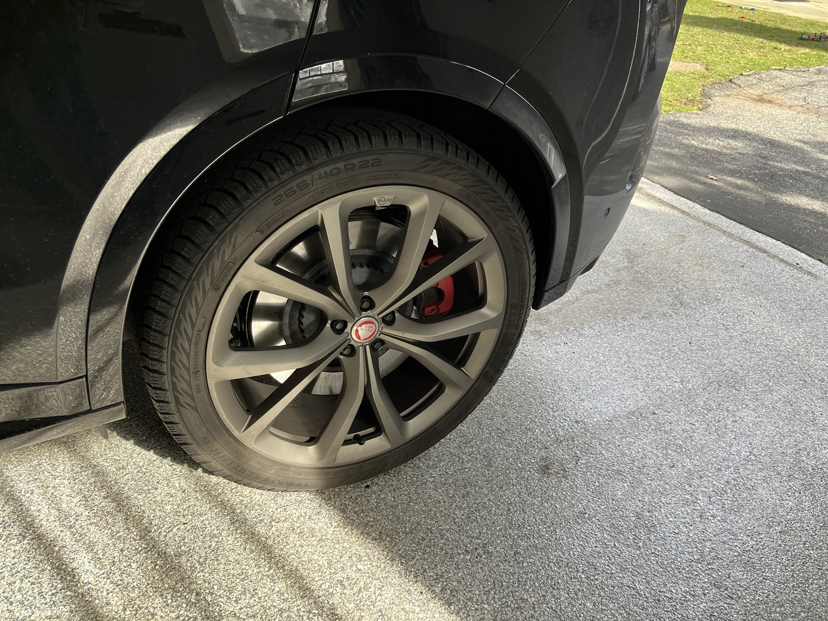

That's funny - I went with the same SVR replica wheels from the same eBay seller. Who was terrific. I however didn't do staggered fitment - I went for a square setup and adjusted the offset slightly so they look the same on the car but all four are interchangeable. So wheels at rear are slightly narrower than OEM to help with winter grip. And means there are more tires available so I put the Nokian Hakka R5
Not sure if you've installed yet. For some reason the conical wheel nut seat on the new wheels didn't quite match the OEM ones - when I dry fitted they wiggled a bit. So the vendor kindly sent me a set of replacement lug nuts for the winter wheels. So check if they snug properly before installing

OEM TPMS for Winter Tires-photo179.jpgOEM TPMS for Winter Tires-photo308.jpg
I purchased a set from him in 2020 and have been using the black growler lugs that came with the car. You're saying that you could actually wiggle the wheel a little bit with the lugs tightened to spec?

I didnt bolt it on. When I just held the OEM jag lug nuts their cone seems to be different dimensions and it didn't mate up with the lug holes properly. Both are conical but they are different dimensions
But minor issue and the ones they sent work perfectly. Plus I can have black for winter and silver for summer!

I changed the wife's winters to summers today and made a point to check the lug holes in the factory and replica wheels. They look the same to me. I also checked my brand new replica ones (for the incoming P575), and they look the same, too. Factory Jaguar lug nuts mate up the same with all three variants.
