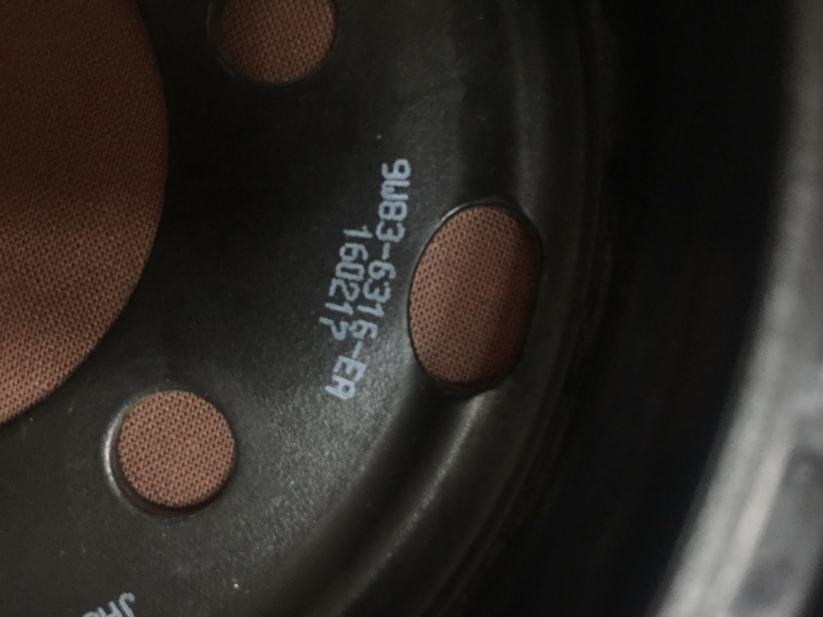

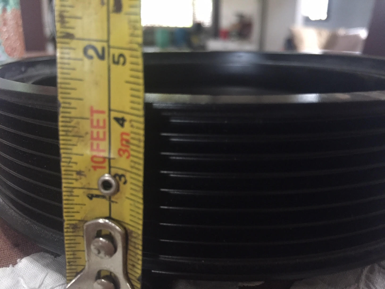

The guys at my bodyshop were able to do this easily following this write up for an F Type:
https://www.jaguarforums.com/forum/f...pulley-179588/
Now, things would have been easy and straightforward, but........ my oem pulley seemed to be a recently revised model and i had to have a 2mm shim made with centering hub (requiring the VAP pulley also to be machined slightly (pics included). Without the shim the first rib of the belt would run off the pulley.
Ive sent my oem pulley to Stuart days ago and he will probably advise shortly on the best way to deal with this pulley revision. I’m the first one who has encountered this, but the shim has worked perfectly and as mentioned earlier, the tune is simply above and beyond expectations ....

We've revised the drawings for the later model pulleys. Stock will be done in about 1.5 weeks so no need for ships in future.

Is there a way to know which one you have?

Early = Grey Metallic
Late = Black

Here are some crappy pics of my late model pulley

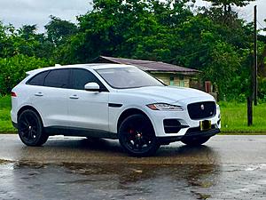

As of today my 2017 35T Prestige has done 2000km, nearly all of them with the VAP tune, pulley and BMC airfilters, as it was tuned on day 1.... As surprising as the performance increase was right out of the gate, it has only gotten better as the engine breaks in. The Jag drank both fuel and coolant at an alarming "pace" in the first 1500km or so, but has settled down nicely on 18mpg in mostly city driving, and is very capable of hitting the 23mpg highway number on longer trips.
Throttle response in Dynamic mode, in Drive, let alone Sport, is quite fierce. It might actually take some getting used too...and I love it. After driving turbo cars all my life this throttle response is truly an eye opener. As I've mentioned before, as surprising as the top end performance is, the increase in midrange power delivery, is even more so.
The pops and bangs from the exhaust (part of the VAP tune) on overrun from 4k rpm and above, have only gotten louder and angrier over time, as has the exhaust note in general.
I also appreciate the VERY noticeable increase in supercharger induction noise resulting from the combo of BMC airfilters, overdriven supercharger due to the pulley, and the removal of both the engine cover and the sound deadening hood liner.
All in all the tune continues to amaze and is way beyond what I expected beforehand.
(Yes my baby looks a tiny bit different than a stock Prestige...20mm wheel adapters and some paintwork..)
