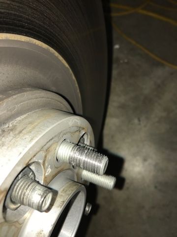

Originally Posted by xrix4096
Get the mechanic to cut them flush with the spacer nuts after the spacers are installed.
Just to clarify, you do not want to cut the bolts flush to the spacer bolt nuts, you would be cutting half of your bolt off.... All you need to cut off is just the tip of the bolt that doesn't have threads 2-3mm...
Edit: Here is a bad pic of a spacer that you can see the end of the bolt that needs to be cut...

+1 to Oz’s response. The Gyrodynes do need the 3mm ground from the end of the studs. None of the thread will be lost, and when you get custom wheels made that are the right offset, there will be no issue when eliminating the spacers. The mechanic is simply not thinking clearly about how a threaded stud works.
