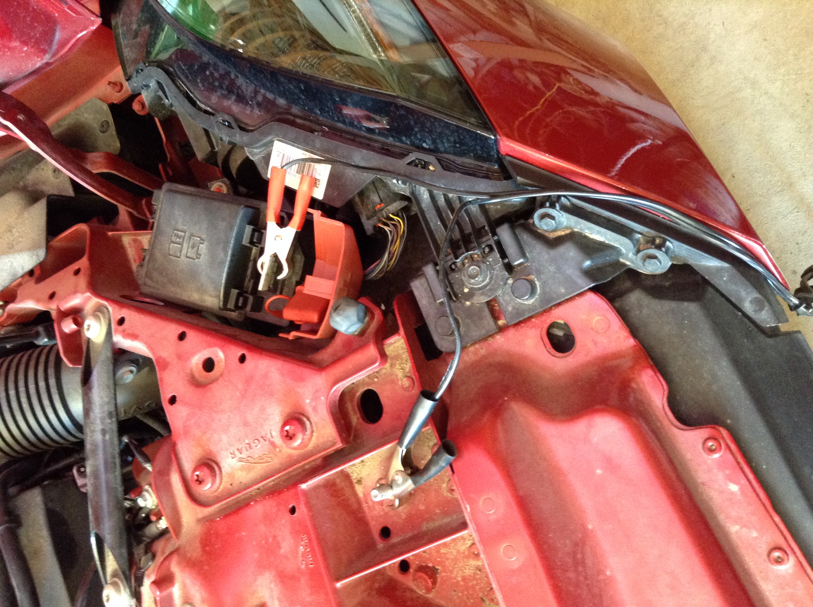

I just hook mine up to the 'boost' ports under the hood.. a positive one and then a chassis ground is near it.. close hood carefully and its done.

Sure, give me a day or two.
This is the method the master mechanic at Jaguar told me to use.
Lawrence.

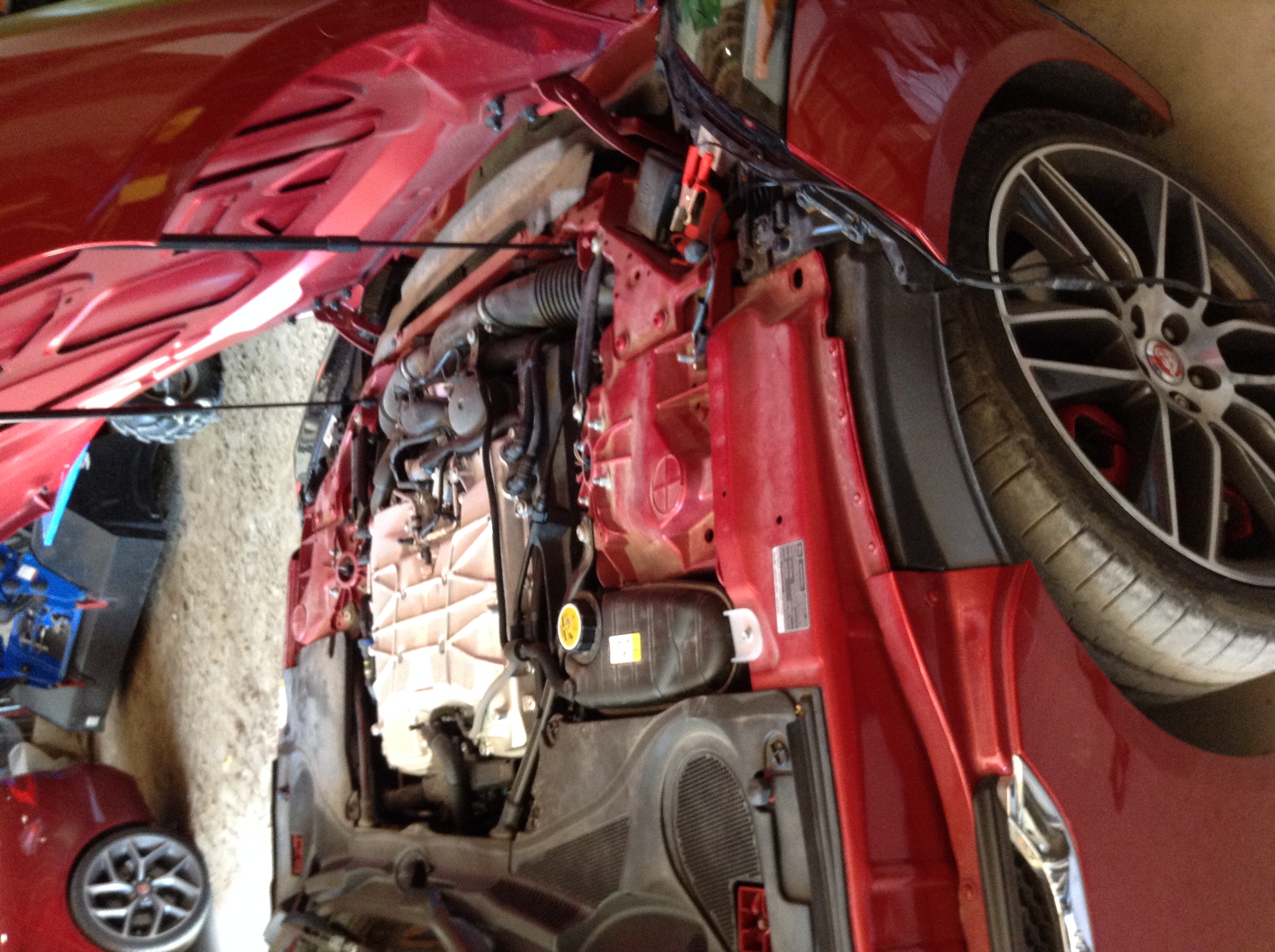

Assuming my pictures uploaded... this is simple.
If you can't park your F type for at least 3 weeks or so without the battery going low, you would have something wrong with the battery or the car is drawing power that it shouldn't.
Therefore, I use this set up once in the early winter and leave it until I bring the car out in the spring. I don't need to plug it in when I am away for a few weeks during the summer as it starts right up.
You have to me careful to close the hood fairly gently so you do not jar the clips loose.
Anyway, I was told by the mechanic that Jag's have a sensitive electric system and this is by far the safest way to boost or to trickle charge etc...
So whatever ....
Lawrence
