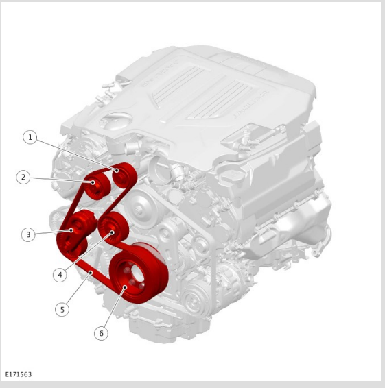

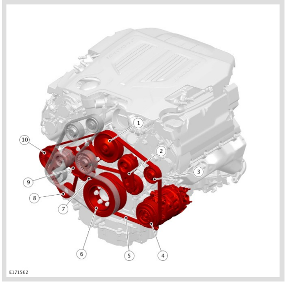

  5. Replace both belts

Obviously replace both belts but also the tensioners.
