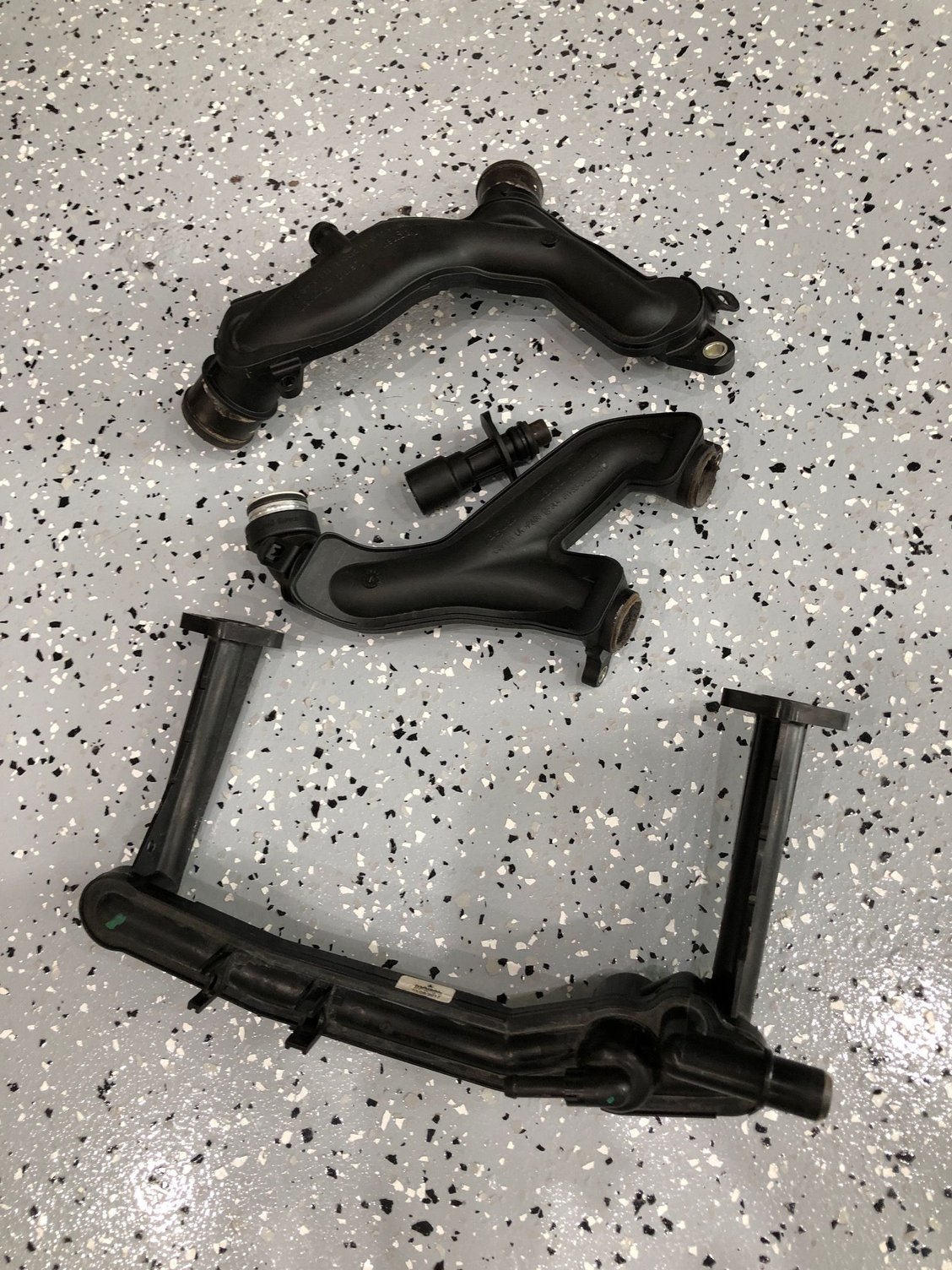

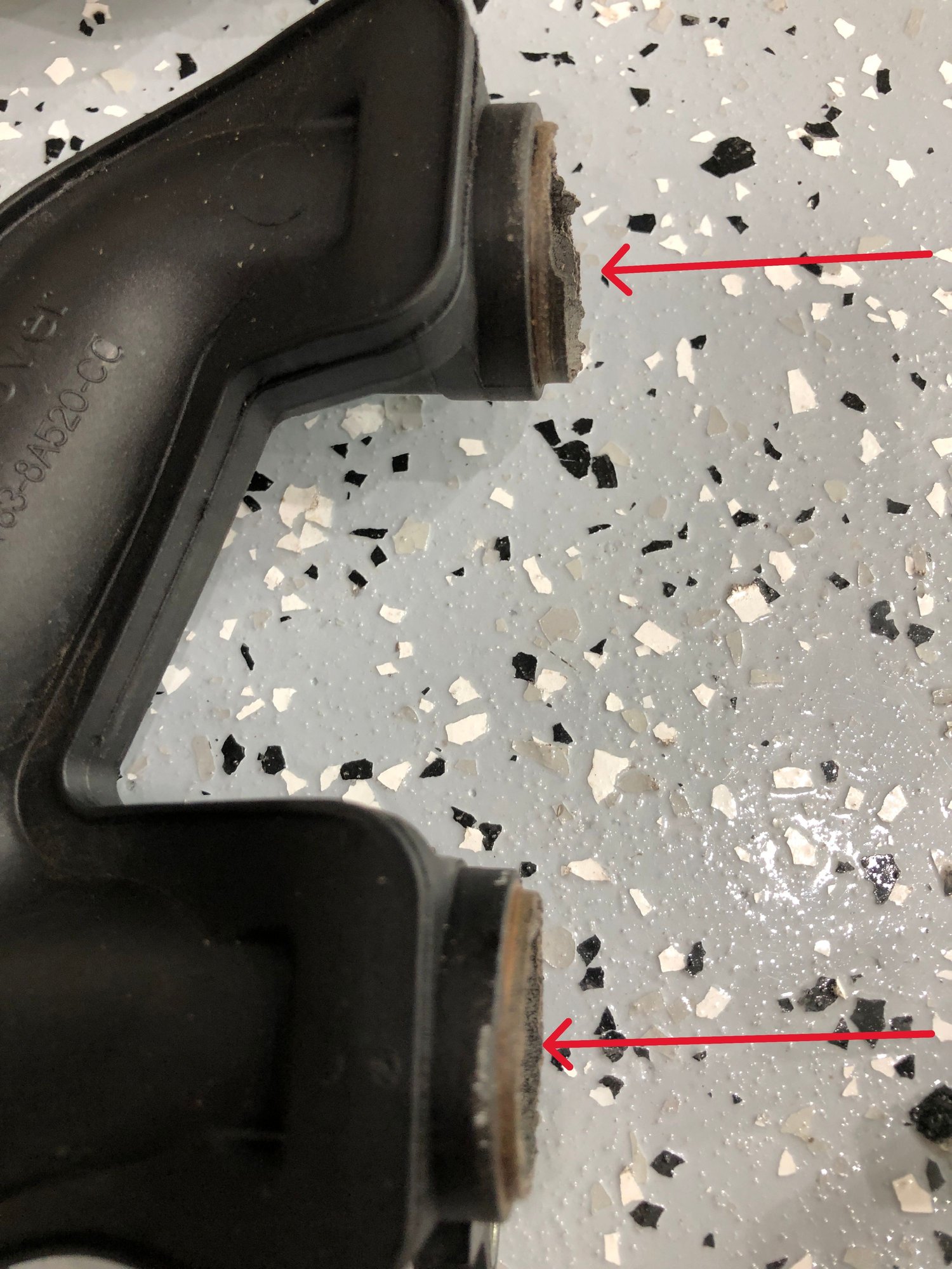

My 2016 F-Type R has just over 33k miles on it. I'm planning a 5,000 mile trip next month in it, so I thought it would be prudent to have the Y-pipe and other bits updated now rather than face potentially doing them (or a full engine replacement) on the road.
FYI, the cost at the local JLR dealer would have been over $5k and, while they would use the one-part plastic JLR manifolds (without a seam like mine had originally), they wouldn't use the newer metal JLR parts or any aftermarket metal parts. I can understand their logic since they give a 1-year warranty on their work and they have the backing of JLR's OEM testing to rely on, but I prefer to go with metal parts.
The cost at a local independent shop that has been around for many decades was only $3.5K for everything (Y-pipe, rear crossover, upper front coolant pipe, thermostat, gaskets, hoses, o-rings). They use alloy parts for everything possible and the job will only take a couple of days. I also had them check a couple of "while you're in there" items: the supercharger coupler and the rear diff seal. The coupler was fine, but the diff seal needed to be redone, as I suspected from the evidence on my garage floor.
I know this isn't a unique story but the reason I opened this thread is to tell you I dodged a big bullet and I recommend you do the same. My car isn't high-mileage but it was a failure waiting to happen. The crossover pipe was already leaking, which explains the occasional coolant smell that I detected. The Y-pipe, though, was ready to go at any time. It wasn't the seam splitting, however. The problem was both of the pipe ends going into the block. When they removed the Y-pipe, everything below the o-ring grooves disintegrated. I guess it was cooked by the heat of the block until it was completely brittle. I'm so glad I had the job done preventatively and I wouldn't have know to do so without this forum, so thanks.
Also, the same shop had a customer last month that bought an earlier Jag with only 11k miles on it, thinking it would be trouble-free for a while at that mileage. You guessed it: the Y-pipe blew within the first 1,000 miles. Fortunately, the owner shut down and didn't blow the engine. They weren't happy to have a big bill so soon but they actually got pretty lucky.

When I did my repairs replacing with aluminum, I found the same as the OP. The O-Ring seats on the Y-Pipe had both disintegrated leaving broken parts in the valley openings. No splits along the seams at all.
I replaced all of these parts with aluminum aftermarket, including the small connector pipe that goes from the water pump to the oil cooler. Luckily, I did not have issues with the aluminum connector pipe as other have had. The crossover pipe was changed to aluminum too although my original plastic one looked OK at the time of change.
