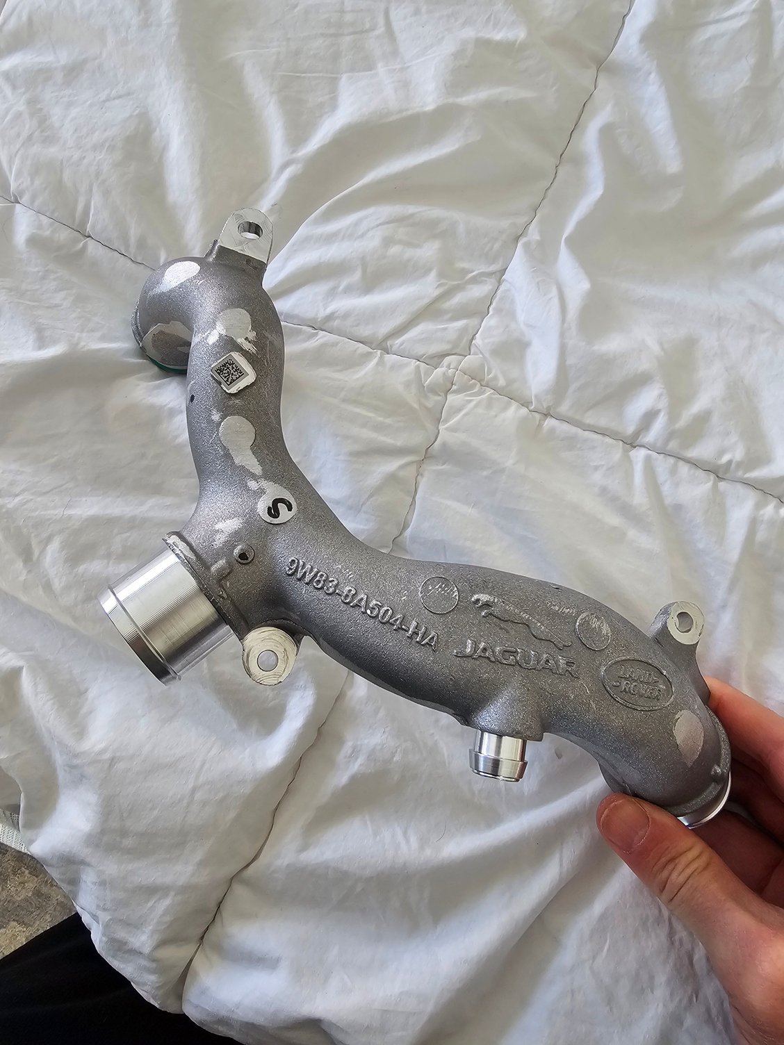

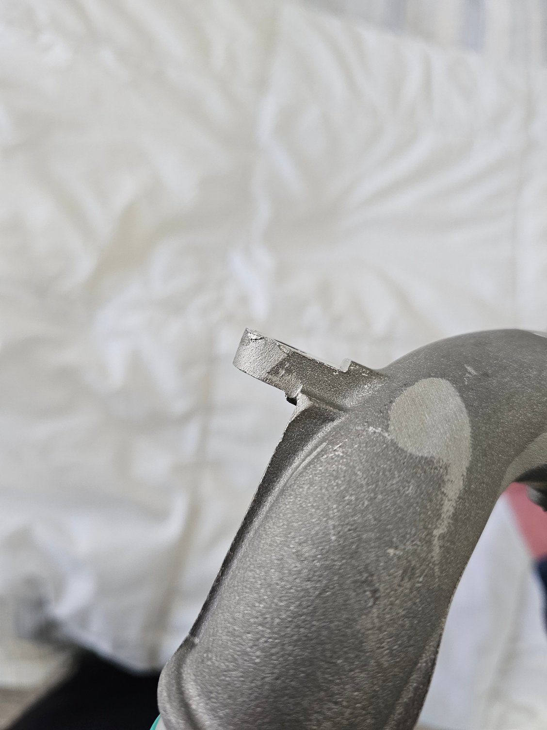

Bumping this thread up, finally getting around to ordering the parts, ordered the newer aluminum JLR upper and lower pipes, the upper pipe I received had a good bit of grinding done on it. That normal?? Especially the mount points look like they were ground down. See pics

For a cast aluminum part, that looks fairly normal -- perhaps a bit more grinding than average. The part is cast, in a sand or ceramic mold, and is not at all flat, smooth, or even anywhere. All the mechanical surfaces -- hose barbs, bolt brackets, etc -- will then be machined to appropriate tolerances. There will be other surface grinding done where the casting sprue is cut off (technically its probably more properly where the gates and/or risers were cut) . Any other places where there were mold issues will also be cleaned up.
As long as the inside is "smooth", it will be fine. I put quotes around smooth as it will be relative. The inside will not have a machined surface, so it will have whatever the natural casting surface is. What you wouldn't want is protrusions into the cavity.

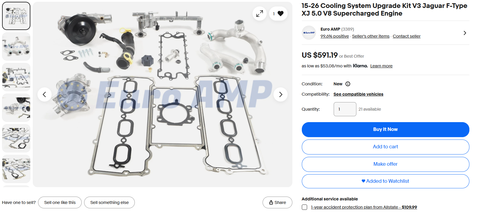

has anyone used this kit?

Just finished the job with their V6 kit. Everything good quality, fit well. no leaks, and my Y-pipe was completely crystallized at the engine inlet also. I strongly recommend reading the very complete thread writeup by GerbilEngineer and watching the YouTube videos by Onca Engineering. It took a week of part time days and I am delighted to have saved several thousand dollars.

I was looking at a similar kit for the V6: https://ebay.us/m/gS8SDp

Thanks for the validation - inside is just fine, was just thinking OEM cast parts would be more finished. Not a problem just wanted to make sure I wasn't getting something tampered with and returned.

I am probably a little too **** about things, but I've read enough posts and talked to enough mechanics where I get cold feet using the entire kit. Honestly by now the V3 kit is probably good, but I decided to piece together my own. I know this is the umpteenth time a parts list like this has been posted, so apologies in advance, but can someone in the know take a look and make sure my list is complete? Want to make sure I'm not missing anything small, gaskets, o-rings, that will get me stuck for a few days during the install (mine is the V8, 2015 MY)
