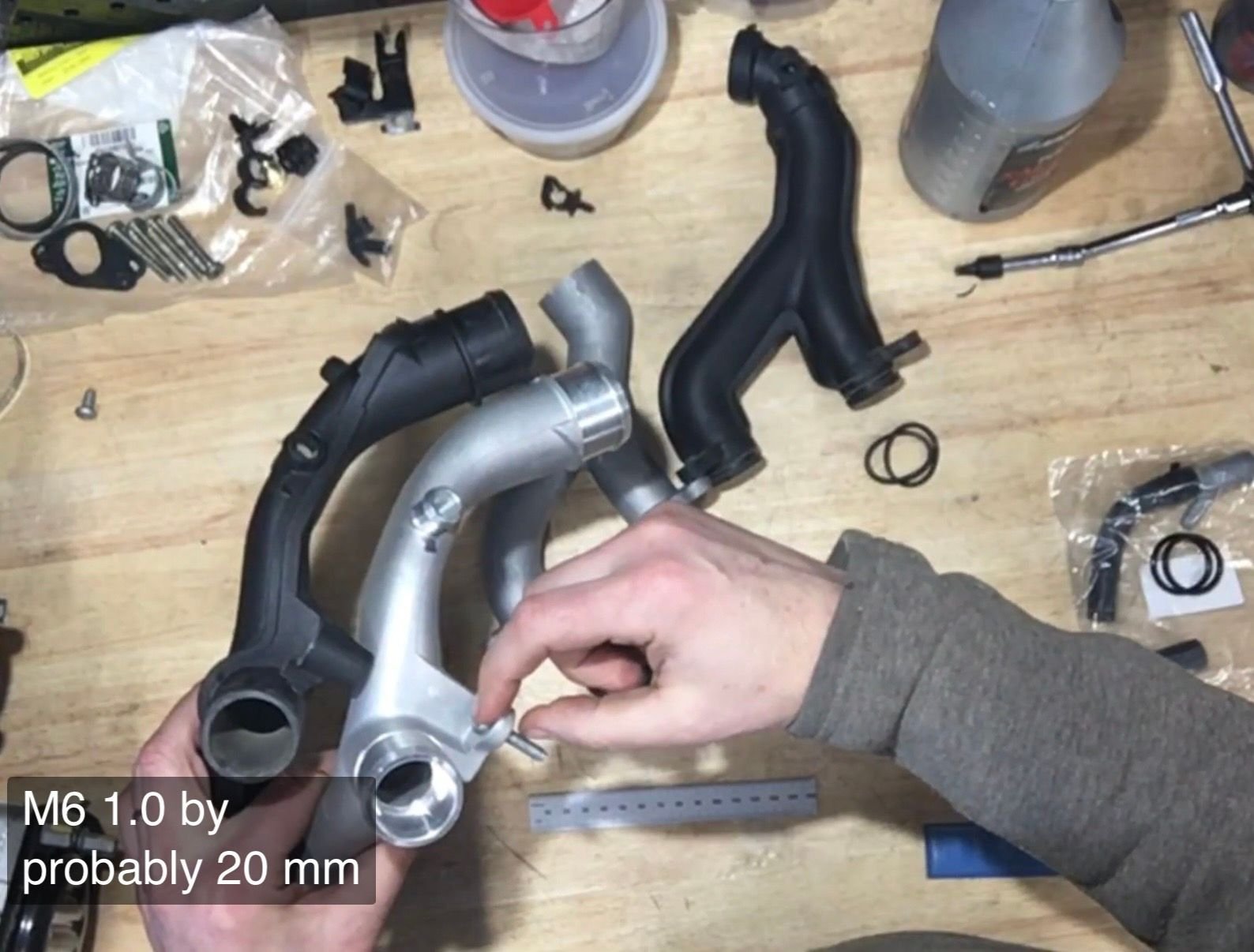

Originally Posted by wachuko
Shorter bolts for the new aluminum pipes since those tabs are thinner than the plastic ones.
Ooh thank you, did not pick up on that!
What size do I need? Thinking M6 x 20 or 25mm, maybe get some washers just in case?
Old Feb 7, 2026 | 01:17 PM
  #62
wachuko's Avatar
Posts: 260
Likes: 95
From: Ocala, FL
I am almost positive it is M6 x 25 mm. Hopefully others that have done it will chime in.
From this video he mentioned 20 mm:
https://youtu.be/JaPCktESH8A?si=on_Lnmyh1VVT7KE2
The later plastic ones also have the small tab and require a shorter bolt, I usually cut down one of the old water pump bolts to a suitable length so the head matches the rest of the bolts.
