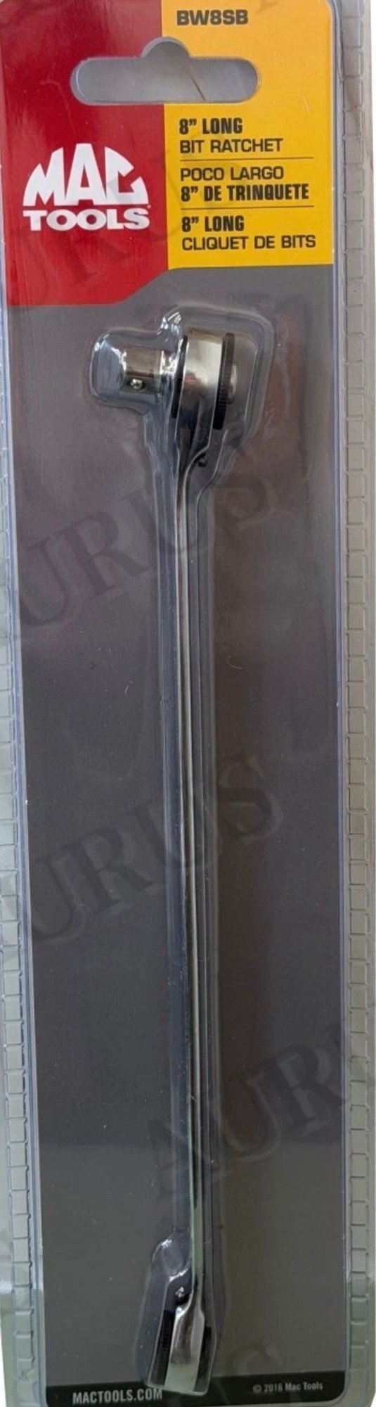

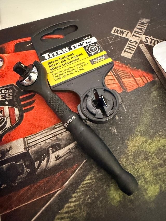

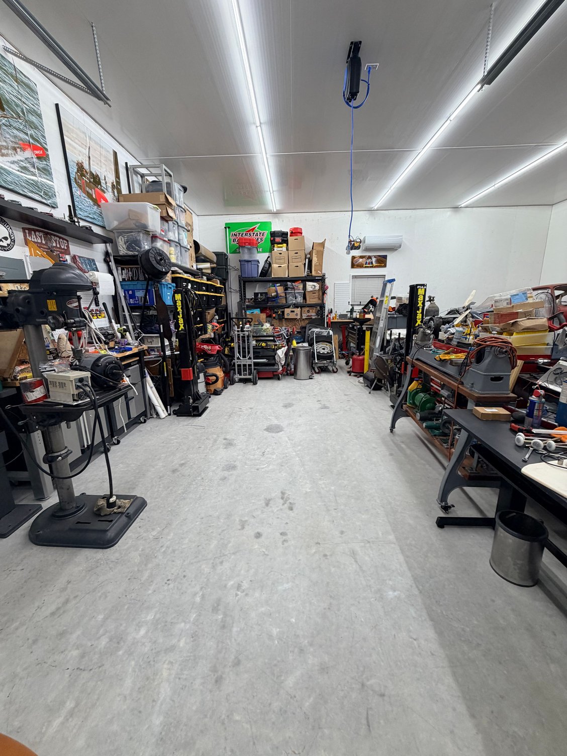

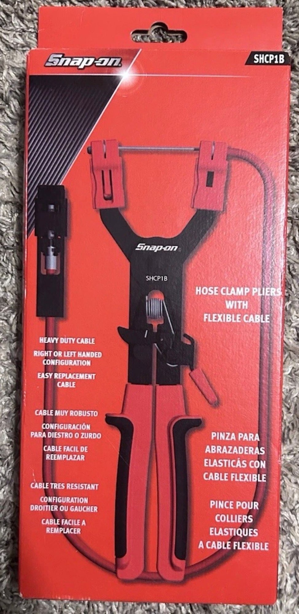

I was planning on doing the same. Finishing the small workshop in the backyard so that I have the space to work comfortably. Too much carp in the way from our recent move but getting there…
Also looking at the different YouTube videos and buying some of the tools that will make that task easier. Specifically, those hose clamp tools that will avoid the majority of the cursing, .
And the long ratchet tool for easier access to the bolts for the ignition coils on the driver side…

Photo from a few nights ago… finally have the space to move the lift into place to mark the location of where to drill the holes. I have a MaxJax two-post lift. This is what I used in our previous house because of low ceiling height… here I have the ceiling height but not the budget to get a new one. This old lift will have to do.

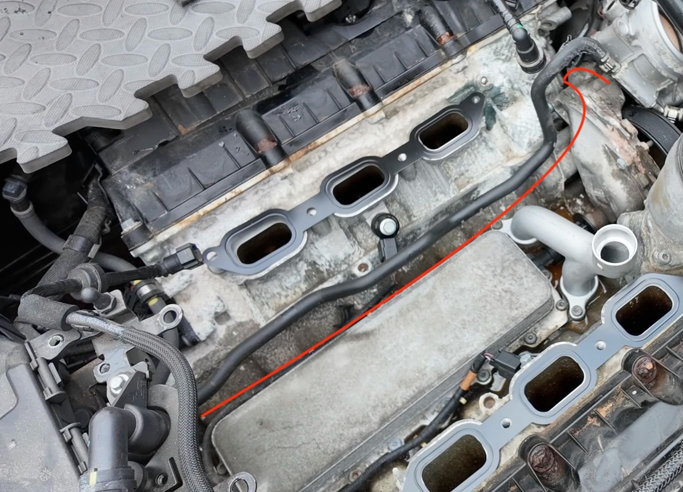

It might be better now, but I have read accounts of the aftermarket aluminum "heater" pipe at the back having leaks. Might want to pressure test it for leaks and need for deburring. I opted for the factory plastic pipe - banking on the fact I can get another 10 years out of that. Also going with OEM water pump and thermostat. While you have the SC off, consider changing:
1) the coupler, new spring model or solid
2) the hose under the SC
3) remove the insulation from.under the sc
4) replace.the vc bolts if they look heinous
5) change the sc oil
I *think* my list is mostly complete, waiting for someone more experienced to verify I do think I missed the hose under the SC, and thr accessory drive belt, should change those, will add the part numbers for those here in a bit.

What hose under the supercharger?? This one:
If it is the one that connects to the throttle body, then that would be: C2Z18677
Yep, I read it becomes pretty brittle over time sitting in the valley of death. Also read to be careful when you set the SC back onto the block, it can get pinched. And apologies, I was confusing myself, this part is on my list already, AJ813614 (different for the V8). My current list looks like:
