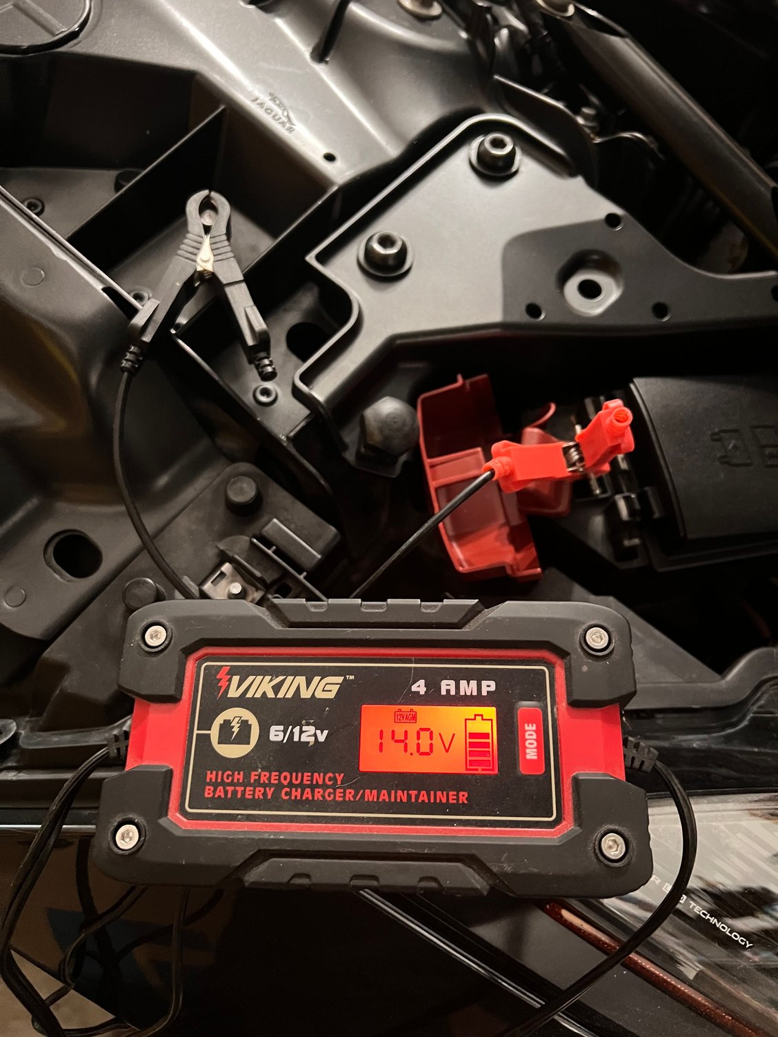

Just as follow-up, the charger eventually dropped down to around 13.5v and the status indicator flashed on 3 of 5 bars. It's been there for about 5hrs. It's only a 4 amp charger and so will probably need overnight yet, but it all does kind of suggest that the battery was pretty low, I think. Maybe that's a good thing in terms of suggesting low voltage culpability; it's something of a relief for now!
I was thinking, too, that when I had the PPI done, the inspector did plug in a code reader. I've read on the forum somewhere that doing so can prevent the can buss from sleeping or something like that? Could that be a factor in the low voltage here? The battery seems to be charging normally, anyway.
Old Mar 15, 2026 | 02:50 PM
If that is the case, disconnect one of the terminals on the battery, for mine, I found the positive terminal to be easier to disconnect. Leave it off for at least 30 seconds. Connect the battery again and it should take care of that. Confirmation of this is, when you lock the car, look at the center red triangle and watch it go off in a few minutes. If it does, you are good.
Might want to do that now and then continue to charge the battery until fully charged.
Oh, another thing, I had to follow a reset of the windows. procedure is in the user's manual:
To reset the windows on a Jaguar F-Type (e.g., after battery disconnection), fully close the window, release the switch, then lift and hold the switch in the closed position for 2–5 seconds. Repeat this closing action up to five times until the automatic one-touch open/close function is restored.
If you do not do that, the remote functions with the app will not work. To avoid someone getting trapped inside the car or something along those lines. At least I had to do this to get the app to work correctly with my new car.

Yes, I did pull the ground and yes, it greatly improved charging performance! It’s charging at +14v and the status indicator bars are filling up!
Thanks for the tip on the windows, too. I don’t have the Remote app set up yet, and was planning a trip put to the dealer for help on that. I signed up on a Jag website but was unable to link the car because it was still linked to the previous owner (I presume). I want them to give it a look over, too, and make sure everything is up to date and look at a couple of minor issues.
