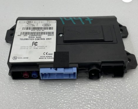

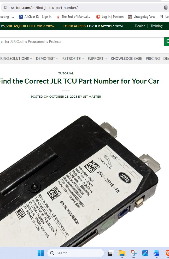

Default OMG yes.. video YES!
Originally Posted by dennis black
You have to upgrade the tcu to the 4g tcu module and program, it with SDD, I now have a a 2017 xj
and I'll show you guys how to do it, or maybe make a video

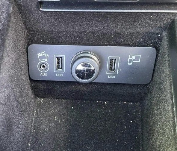

thank you so much for posting... I thought I was literally at the end of the line for getting my Jaguar Remote app to work. I believe this is what is in my 2017, built mid-late 2016 F coupe Manual Trans:
the only question I have is that I do NOT have SDD capability in my car... there are only 2 USB ports in the cubby.
Did you get your 4G unit from this SX outfit in China??
Attached Thumbnails Washed car and got rough running w/ "injector circuit high" code-telemmodule.jpg   Washed car and got rough running w/ "injector circuit high" code-portlayout.jpg   Washed car and got rough running w/ "injector circuit high" code-4g-tcu.jpg
