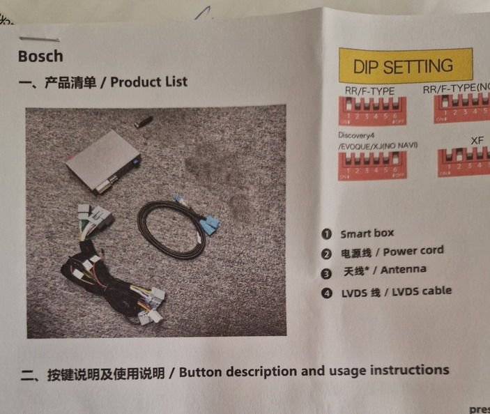

Hello, The new module arrived today.
It's the module with only one antenna.
It also comes with a part that looks like a microphone.
Do I have to install it?
It's not listed in the description either.
The cable is really long now, too.:-)
Thanks, Fank

I installed the new module today and it worked immediately.
I set the dip switch to "1" according to the instructions.
It's simply fantastic how this upgrades the vehicle a bit, I like it.
The only problem I have now is with the steering wheel controls
for forward and reverse.
But I read the interesting post here by KRAZY-K and will test the settings in the next few days.
I am very satisfied with the module and the service from Carlinklife.
Thanks also for the many helpful posts in this thread.
Regards, Frank

This thread has been immensely helpful. I went the aliexpress route and ordered this AUTOABC unit here ALIEXPRESS.
Took me about an hour to install and overall very impressed. Package looked just like this Kuhli's unit in post #105 and came with a mic.
- There are aux cables to connect in the center console. In the Headunit audio setting, I had to switch to using AUX to get sound from the carplay unit.
- The colors on the screen looked really washed out but turns out the display settings were adjusted to a very high brightness. turned it down and its fine.
- Track buttons for previous and next songs do not work but may need some fidling around with it.
-It came with 0 instructions but i followed the available ones on youtube to get it installed.
