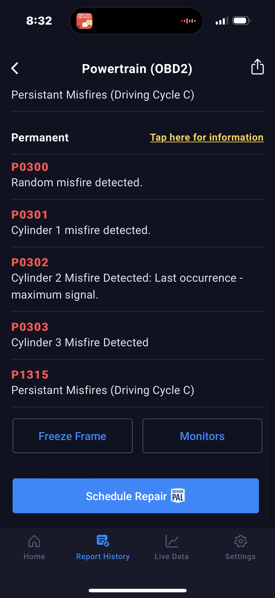

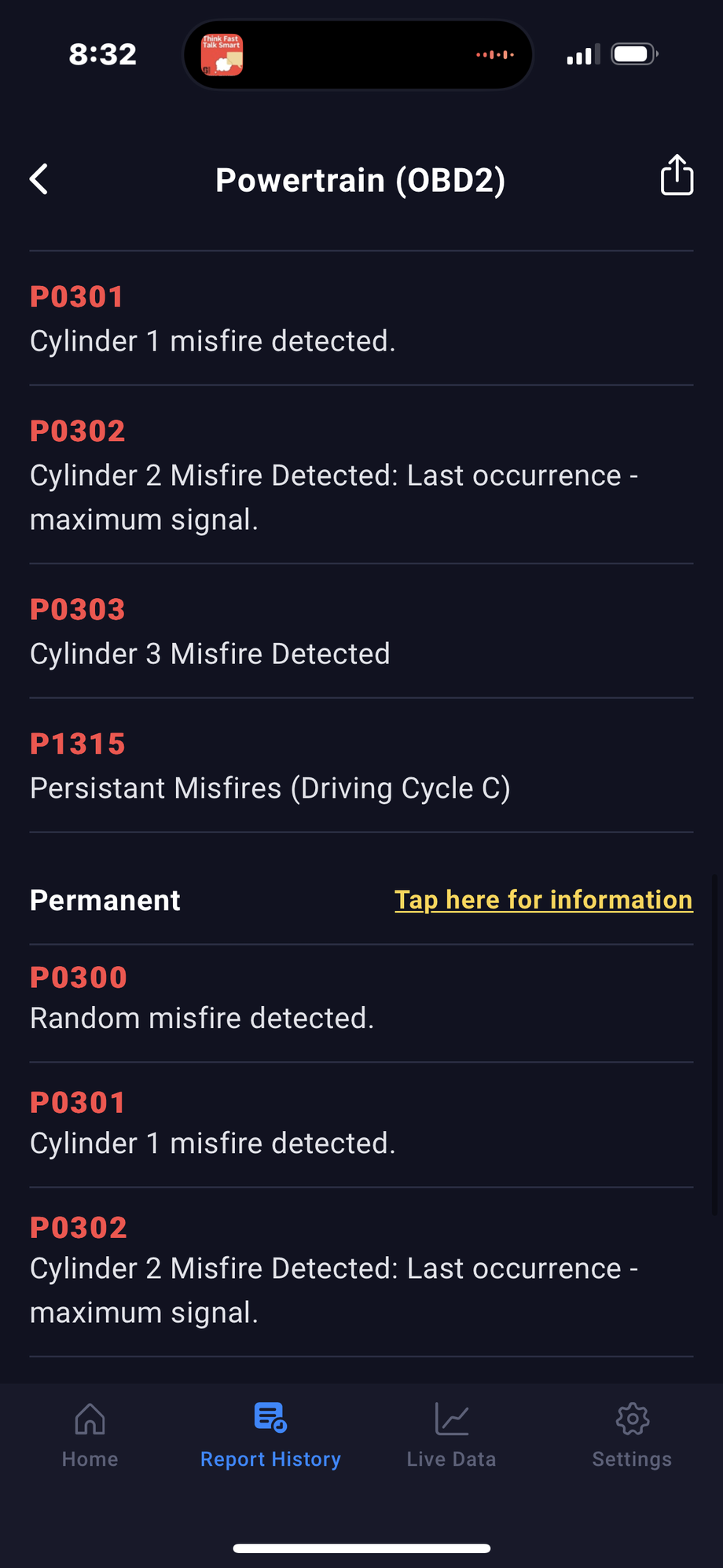

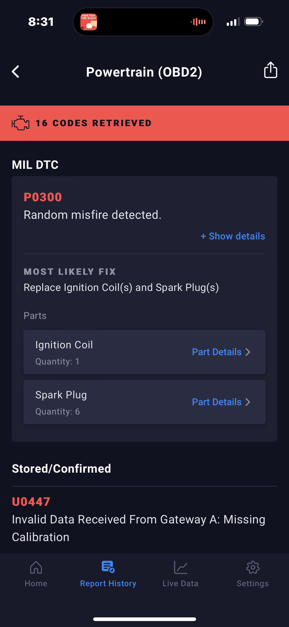

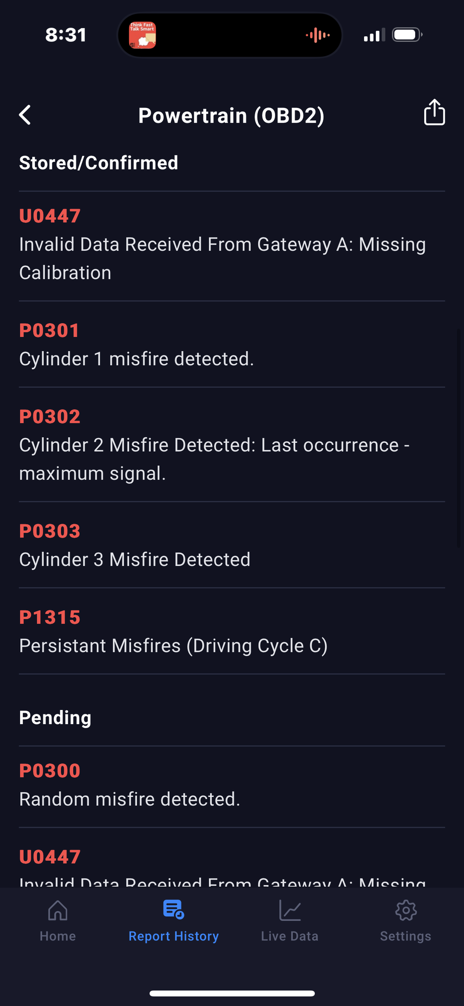

Good morning all-
It has been an eventful summer with the Jag. My wife and I left on a trip to Napa, about 1 hour from home (in South Lake Tahoe) the cooling system failed and I sent the car to a local indy. $4,000 later, I have a new coolant crossover pipe under the supercharger. Car has a velocity ap tune on engine and transmission, lower pulley.
A few days later, on a normal drive to town we started smelling a foul odor and then the car went into limp mode, turned around and drove 7 miles back home.
Got it on the lift and pulled the cats, car has 38k on it now and seems a likely culprit.
The passenger side cylinders were clearly not firing well as the inside of the pipe and O2 sensor is heavily sooted.
Now, when starting the car (open manifolds), it still appears to be running poorly on the passenger side.
I assume the plugs are fouled beyond repair and it is now time to do plugs (sounds like a pain in the a$$), but any chance the plugs will clean up on their own to make certain the cat was the only issue??
Appreciate any tips here.

Generally when that happens your better off to replace all 4 injectors and plugs on that side of the engine.
Off course without any engine info you may have a V-6 instead? Full car details will always get you a better answer too.

I guess I’ll order the injectors and plugs to go with my new VAP down pipes.
