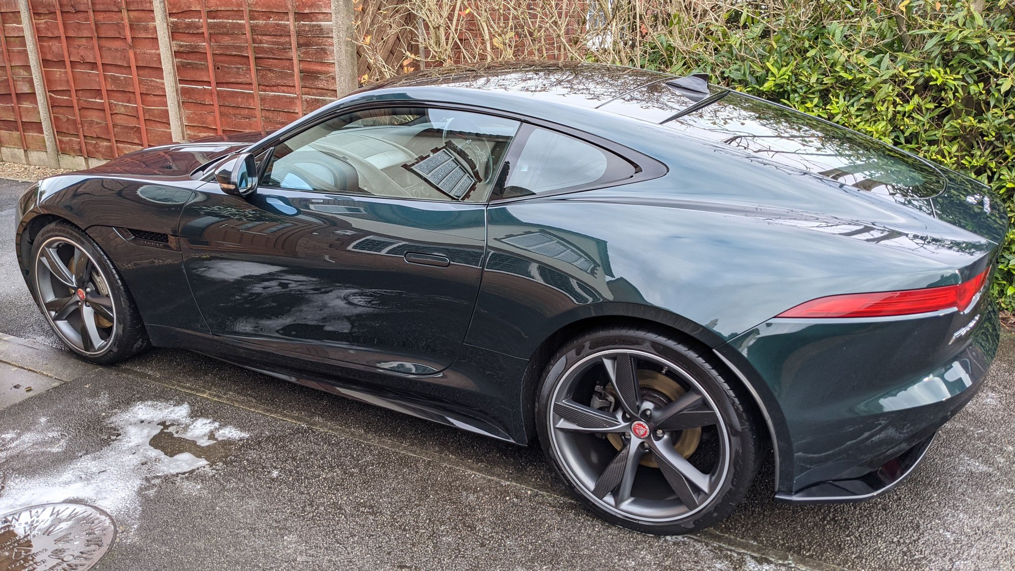

Love mine. Has all the options including the switchable exhaust. It's almost a crime that it doesn't have a lsd though. Any hot hatch will beat me away from the lights in cold or wet weather while I have a one wheel spin up. Once rolling though it's amazing. Just got the vap 416 tune.

Really looks nice! And tell me more about the tune. Was it a long process?

that's very beautiful! is that the sport design pack at the rear?? do you know the parts no. of that rear part?
many thanks!
