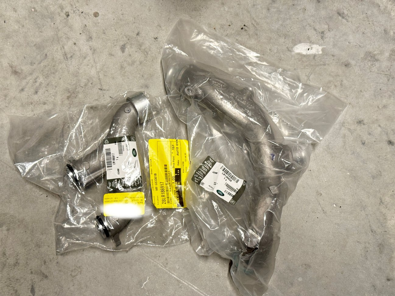

Do you have the reference number for the aluminum coolant pipes? The dealer is telling me they have only 1 reference for each piece and that they cannot assure that the piece they are going to receive is not the same as the old plastic one

Originally Posted by Evoex
Thanks! Sadly since these are considered Land Rover parts and are not in the list of parts for the F-Type the official dealer is not willing to install those. They will install the revisited plastic ones without the stitched sides. I'll leave it like this for now and buy the aluminum parts by myself, if at any time I have any issues with the coolant pipes I will replace those myself with the aluminum ones.
Cheers!
Cheers!
I'm pretty sure the appropriate Jaguar part #s have been supplied on here...
but anywho, those 2 are what's in my Ftype..and i beat on it daily and had it in the 4-6k rev band for most of a weekend a few weeks ago. She's running like a top.
Cheers!
- AJ813865: Lower pipe (aluminium)
- AJ813917: Upper pipe (aluminium)
As per;
https://www.jaguarforums.com/forum/f...4/#post2546741
They also seem to be on jaguarparts;
2013-2024 Jaguar Engine Coolant Outlet Flange AJ813865 | JaguarParts.com
