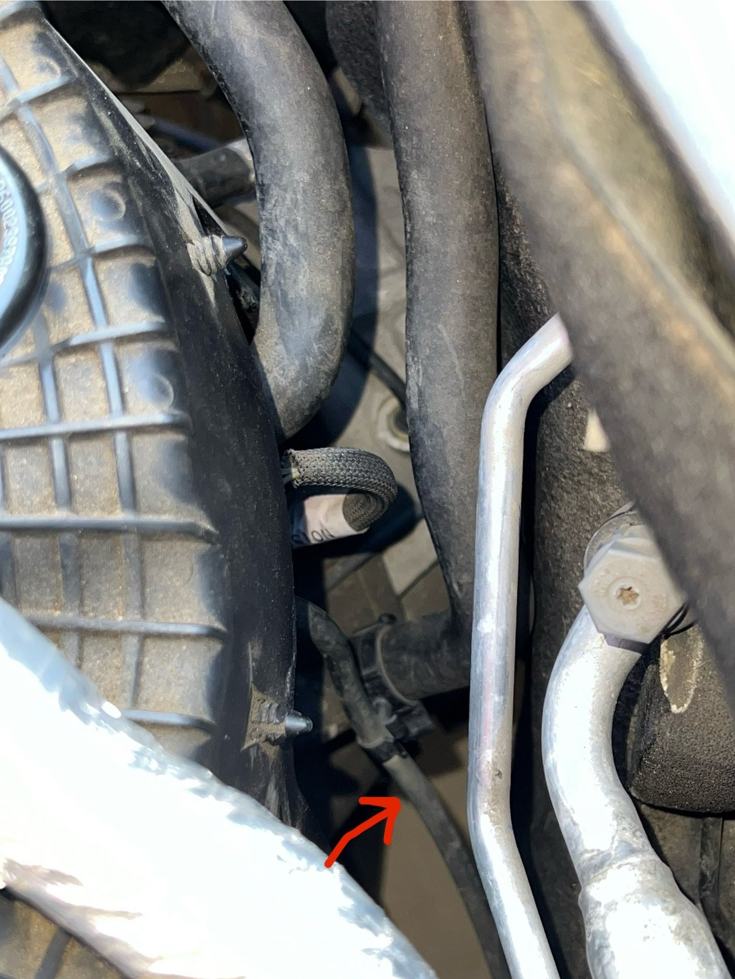

For 2019 Jaguar F-Type P300 2.0t. Question for the experts. Check engine light went on. After checking, P0507 code shows on OBD reading. Has rough idle and RPM would fluctuate up and down. At times, high idle in park. Took to mechanic and he saw that there was a vacuum line that was not connected. We could not figure out where the line can be connected. Does not look torn off. Just out of place. Then we were able to figure it out and placed into engine mount. He did a pressure test of the exhaust system and found no leaks. It was fine for a few days of driving and the check engine light is back on when I turned the car on as soon as it gets started. Video is included and pictures of hose are also included. I’d greatly appreciate it if anyone has an insight as to what the problem could possibly be. Thank you all.
