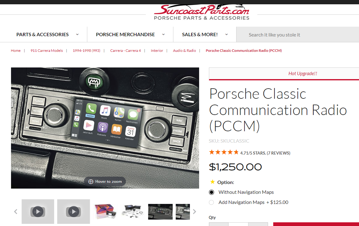

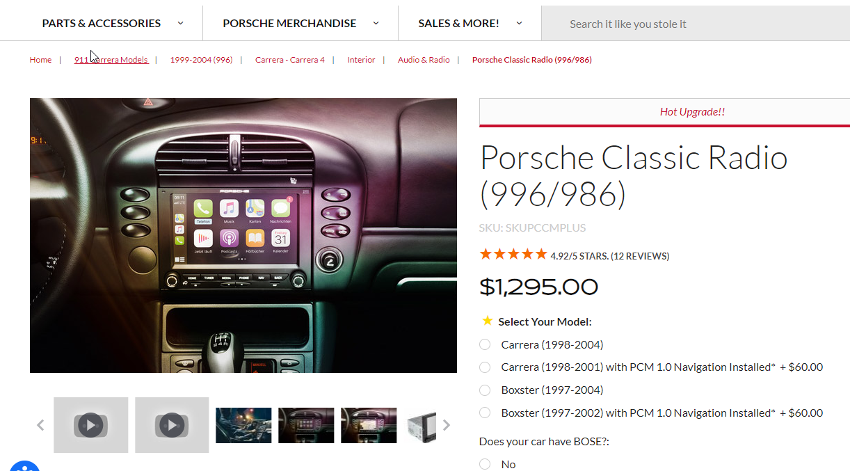

I hope remote start and lock stay with us. Status is nice and cute too...
JLR should do what Porsche did and come up with a "blessed" new tech option for carplay...I went third party but doing something that is officially sanctioned is all they need to do. Frankly, carplay is great. 1k for the unit. An hour of labor...done. They have a double din unit too....the porsche tax is shown here too....but this approach is what is needed and likely would fit across the line since their radios/units seem to be similar. I think it would really make a lot of people happy. They could even go in with another company if they wanted to spread out costs.. .but LR units alone would cover things probably.
Here is the idea to copy:
