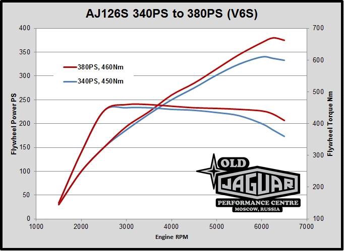

This will cause a stir...
The reduction in power from the V6S to the V6.
Same thing with the 5.0L; 470ps, 495ps, 510ps, 550ps, from an identical engine.
JLR aren't the only ones that do this, the supercharged Ford Coyote V8 "Miami" here in Oz is similar, throttled back to hit a number.

Originally Posted by Foosh
One thing that does ring true is that the power does seem to "fall off a cliff" once you hit 6K rpms. My "butt dyno" feels that routinely.
Cambo,
That chart certainly is consistent with what I said in post #5 above w/ regard to my base car.
