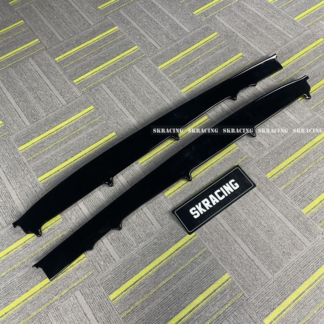

My car didn’t come with the optional factory side skirts. I like the factory look. A lot of the aftermarket models are different, I don’t like them.
Has anyone used these? I plan to buy the plain ones and paint them body color. How do they attach? Is it a DIY job?

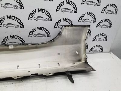

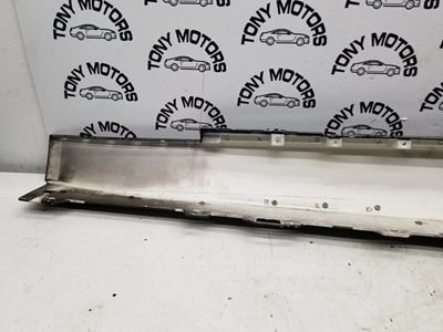

@mvining In answer to your question regarding fitment of sideskirts, yes it's a DIY job, but it does come with some challenges. The OEM side skirts are secured by 14 M6x10mm bolts, each side. However these bolts fit from 'inside' the side sill (see pics).
So in order to mount new side skirts, you will have to remove the side sills from the car, unless the aftermarket side skirts use a different mounting approach. The side skirts pictured in your post don't appear to have the thread inserts that the OEM ones do, so they may just use screws directly into the plastic of the side sill. Best to check mounting approach with the Seller before purchasing. This video shows you how to remove the side sills from the F Type
It can prove difficult to remove the kick plates from the side sills without damaging them as they are bonded with double sided tape, so you may want to purchase a new set of kick plates as part of your upgrade project.

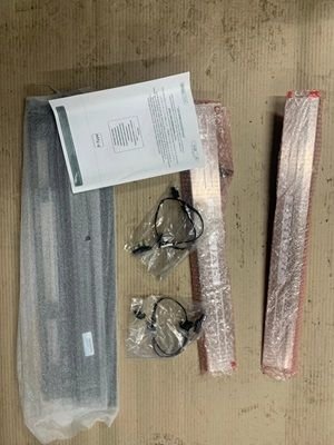

@mvining Just to be clear, that's not my video of how to remove the side sills, it's another forum member who I think has now sold his F Type. He bought his iluminated tread plates from Ebay and the Seller did not include the connecting wires. If you buy the full illuminated tread plate kit (T2R6090), it comes with the metal tread plate, plastic base and connecting wires
These kits are now becoming rare, so the price has gone up significantly since I fitted mine some 2 years ago. Current price from Britcar is £570. Although there is also a kit available from EBay UK Seller at £427 T2R6090 You can of course just replace the kick plates with non-illuminated ones (Jaguar or Union Jack) at much less cost.
