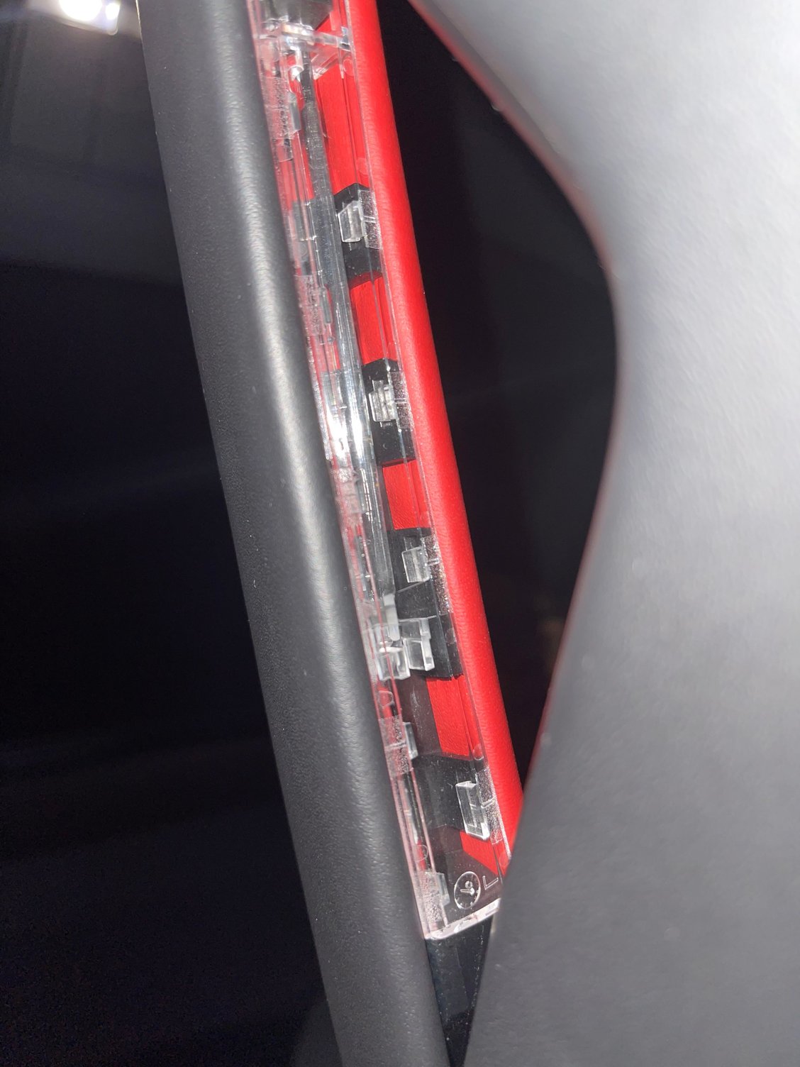

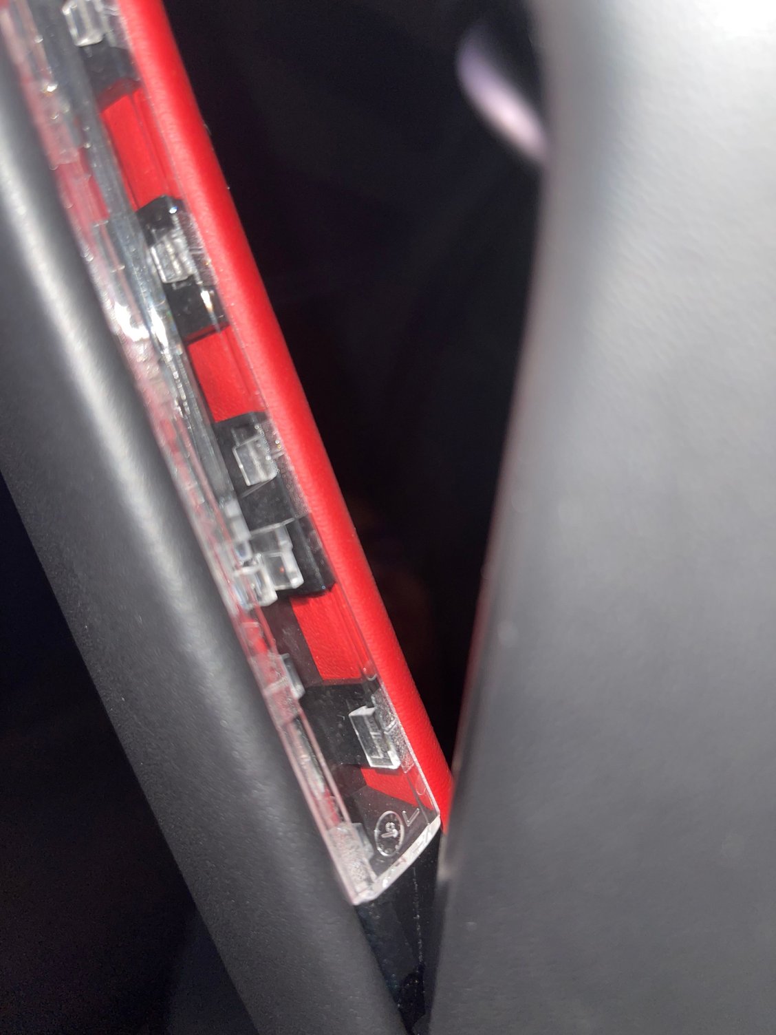

Hello guys, recently when looking at my spec I noticed that it was written :AMBIENT LIGHTING
But nowhere in my dashboard screen can I find how to configure it or at least put the ambient lights on.
I verified the bottom of the handle of the centre console where you find the lights and I found this :
Does it look like I have them mounted without the function on the software to put them on?
If so should I go directly to the dealership to tell them to add the function to use the ambient lights?

I think there's a difference between "ambient lighting" and "configurable ambient lighting".

Ok, but does it seem like the lights are present but just not useable because I didn’t pay for the option?
I wonder if I can ask the dealership to put the configurable lights and if they’re only going to add the function on the software in the case where the lights are already mounted by the factory but not activated
You can ask but they won't do it, JLR have a strict policy of not activating optional software (ie a tweak using SDD or Pathfinder) that was not paid for by the original customer. You could possibly get it done by a privateer who has SDD and I am fairly sure Cambo has a list around here somewhere of the functions/options he has enabled using SDD, good luck finding anyone out your way with SDD and the knowledge and experience to use it properly!
Member Valerie Stabenow had the exact same issue and she got the JLR dealer to "turn it on" but the difference is it was an option she had paid for that they simply forgot to turn on at the factory.

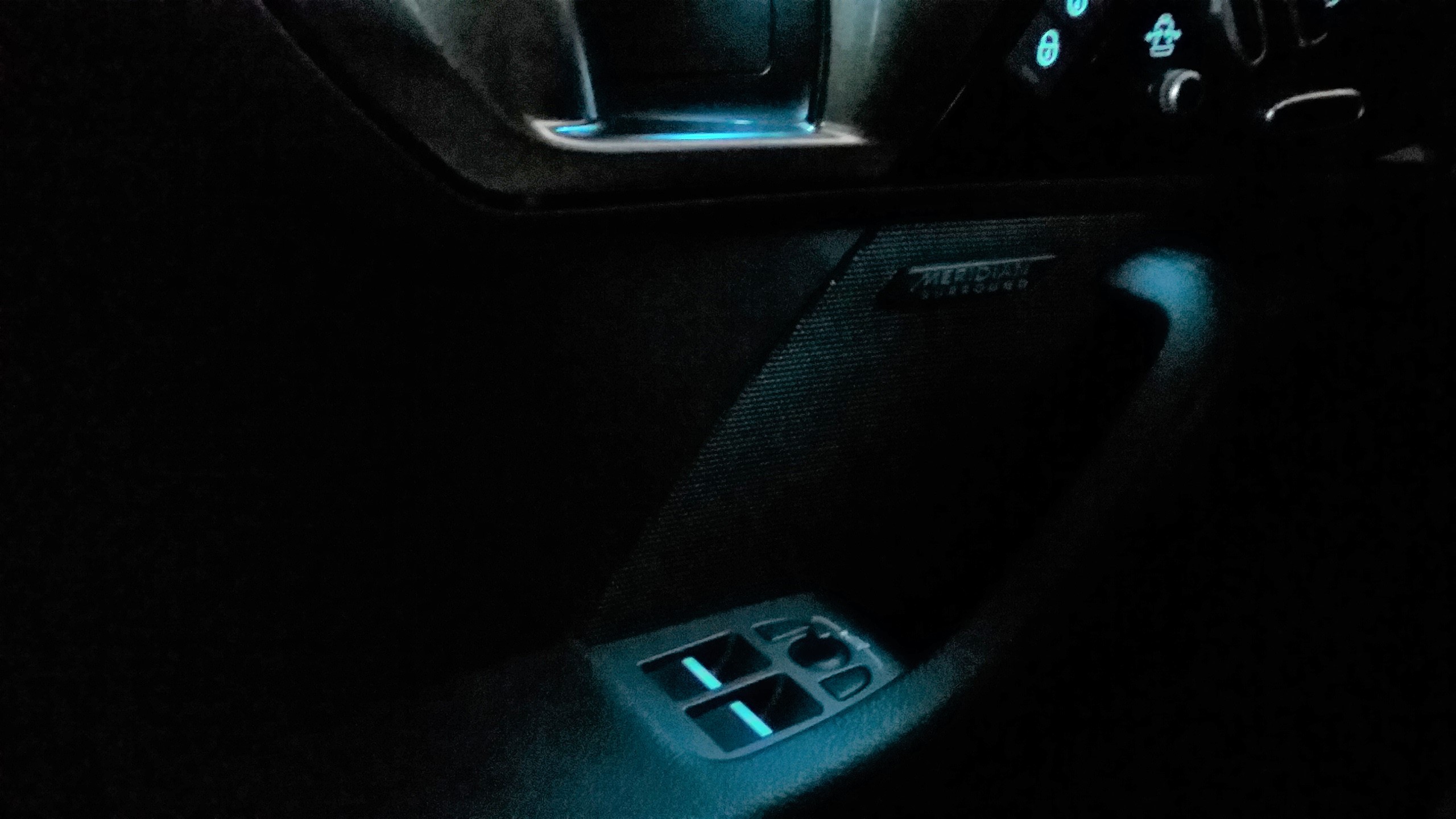

I believe i have photos of what the door lighting and grab handle lighting look like... in my car, a soft medium blue. will find them and post them. Hope you made progress at the dealer.
Correct. Cars with non-configurable ambient lighting still get soft blue in the door handles and the center grab handle.

Here are the photos showing the lighting in the door and grab handle areas. Center photo is from under the handle to show the LED strip. Color is pretty much spot on.

Note that the door handle color doesn't change with controllable ambient lighting it stays blue.
