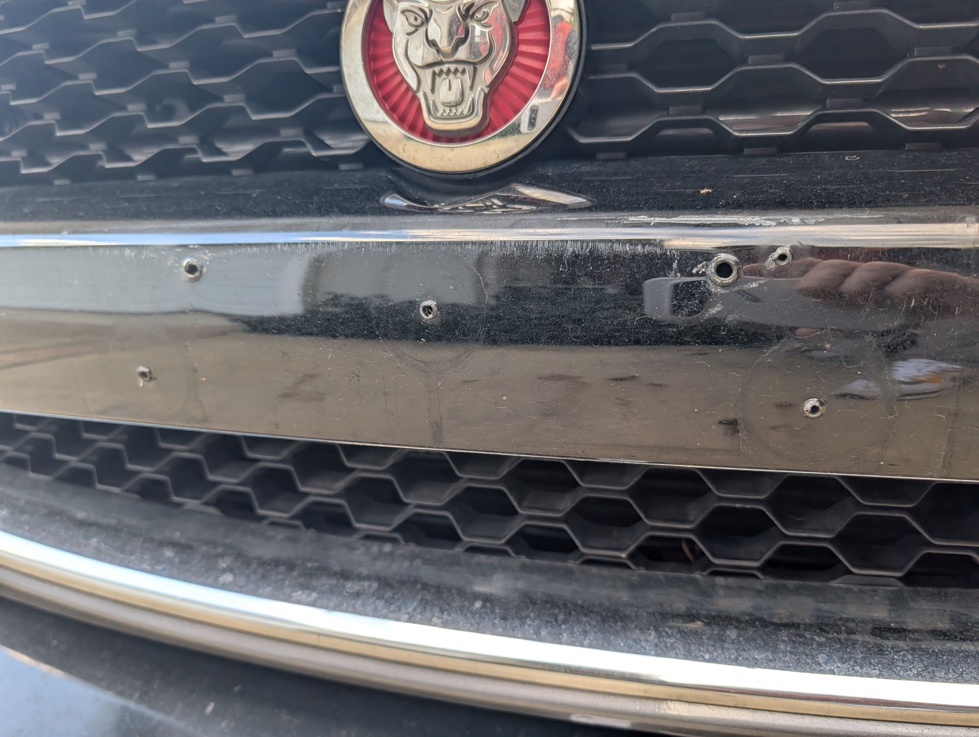

Looks like the previous owner got a little carried away when mounting the front license plate...
I don't need a front plate in my state so wondering what the lowest effort fix for this will be, it doesn't need to be perfect, just not as bad as it is right now.

See if you can procure a crossbar cover from someone who recently did the crossbar removal project.

Thanks for the tip! It looks like new ones are available on eBay for around $170. How involved is removing and replacing this piece?

There's that, or you could use BumperPlugs. For the front bumper bar, you could upgrade to P7 grille, or remove the bumper to replace the crossbar only.
I did my front end for the SVR for $700 paint, blend, full re-clear.

Don´t be angry at the previous owner, this is OEM way how the holder is attached from the factory. You can buy new part or switch to Project 7 replica, but with that goes a bit of work. To remove the bar you need to disassemble the bumper, which needs to disassemble the whole front underbody with about two thousand bolts.

You could fill it, sand it down and then either use some sort of wrap over it, or depending on the width, some of the tapes available in a variety of finishes... semi-gloss black or carbon fiber??

@FTypeInTheSun I just took my 2016 in for a front nose repaint and then a p7 replica replacement on the front grill. My current bumper cover is in near perfect condition. I'm located up in Seattle and can ship you my OEM bumper cover if you're interested all you need to do is pay for the shipping. Just DM me if you have further interest. Bob

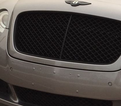

When I had this situation on my Bentley, I just used plugs. I color matched them to the bumper color. This is the quickest easiest way to dress up the ulginess. It is far easier than wraps, paints or repaints. It appears you are on chrome? If so, you could experiment with black plugs or some shade of silver.
