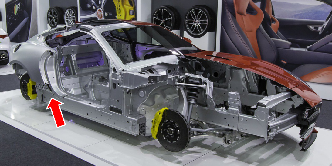

Hi jm717, Foosh:
Can you confirm.... are these the fasteners in question?
Attached Thumbnails anyone hear this noise?-7c3e6e08-a432-4d56-8228-e4cfbac7b75f.png
Old Mar 6, 2018 | 11:11 AM
jm717's Avatar
Posts: 86
Likes: 36
From: PA, USA
Originally Posted by hades281
Hi jm717, Foosh:
I am not sure exactly which fastener it was. The repair was worded like this: 22293 BODY FLEX AT LEFT LOWER B PILLAR TO STRUCTURE FASTENERS TEST DRIVE WITH CHASSIS EARS ON LR SPRING, SWAY BAR, SHOCK, LOWER CONTROL ARM, & ROCKER PANEL, REMOVE TRUNK INTERIOR PANELS TO ACCESS SHOCK, REMOVE LOWER DOOR SILL CLADDING AND TEST DRIVE, LOOSEN B PILLAR FASTENERS AND INSTALL STRIP CAULK BETWEEN PANELS TO ISOLATE NOISE, TORQUE FASTENERS TO SPECS, TEST DRIVE, REPLACE LEFT DOOR WEATHERSTRIP
I think the important part was this: LOOSEN B PILLAR FASTENERS AND INSTALL STRIP CAULK BETWEEN PANELS TO ISOLATE NOISE, TORQUE FASTENERS TO SPECS
Mine was not a known issue with a Tech Bulletin, at least not at the time. It was definitely a rattle that originated at the lower B-pillar, but sounded like it was behind my left ear, probably the sound just traveled right up the B-pillar so to speak. It sounded like small pebbles dropping on a plastic tray, I know they found the problem, I have never heard that particular sound again.
Hope it helps you & good luck.
