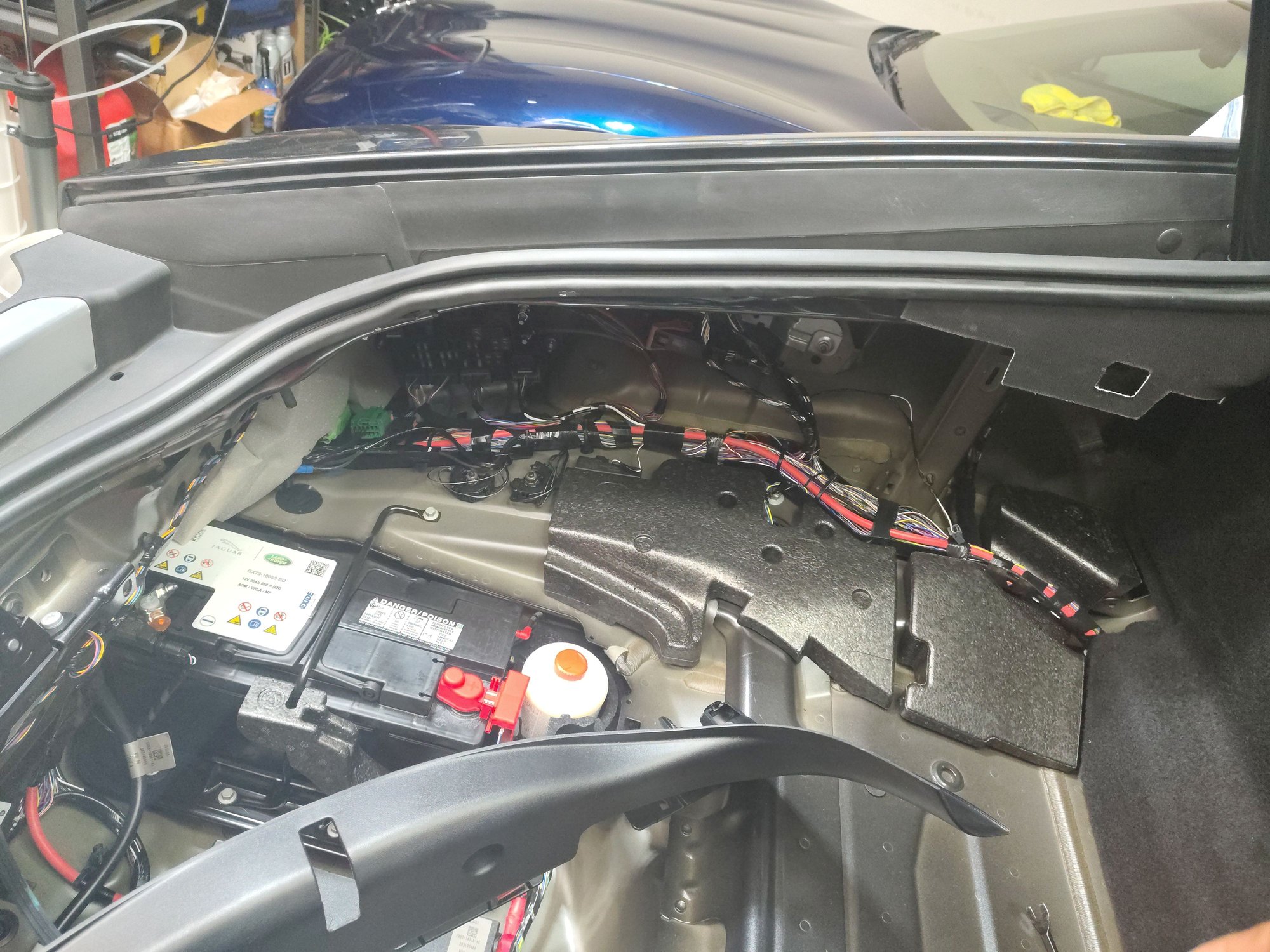

For anyone interested...
As talked about in the following thread around the now known concerns around pulling fuse 15 (i.e.: To keep the back exhaust valves open), one solution to the problem is to install a valve controller from ASR -->
https://www.jaguarforums.com/forum/f...emoval-290806/
Here is the specific ASR RX1 valve controller some of us are installing as a remedy to the problems discussed in that thread:
https://asr-component.de/gb/begin/31...-type_1_type_2
I just finished successfully installing it on my 2024 R. All is well. Completely plug and play. Everything worked as described. I like that it remembers the setting I had when I last shut down the car, so I don't need to remember to open the valves again like I did with the Claws Out setup I was using before for the fuse 15 pulling. I also programmed it to my Homelink garage door opener buttons for a nice integrated feel. That worked as expected as well.
I have attached a PDF from the workshop manual that shows the info concerning the removal of the trunk area trim panels, which is required to get this ASR device installed.
GUIDE:

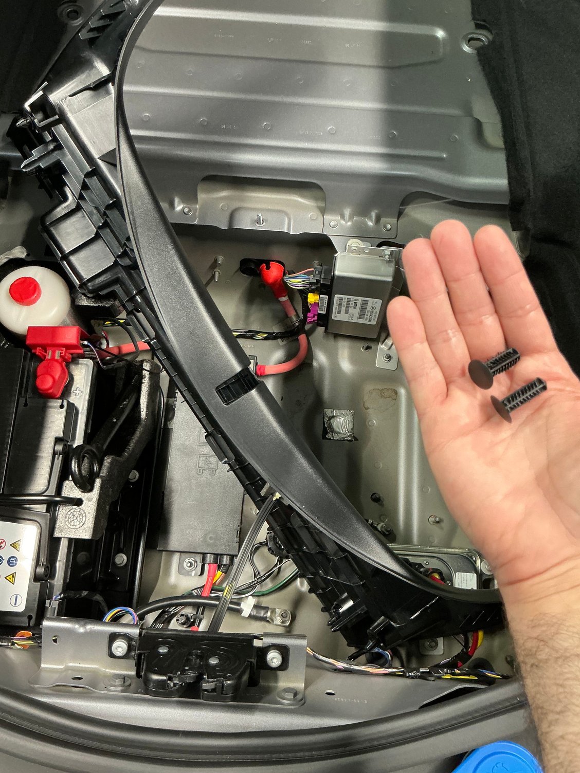

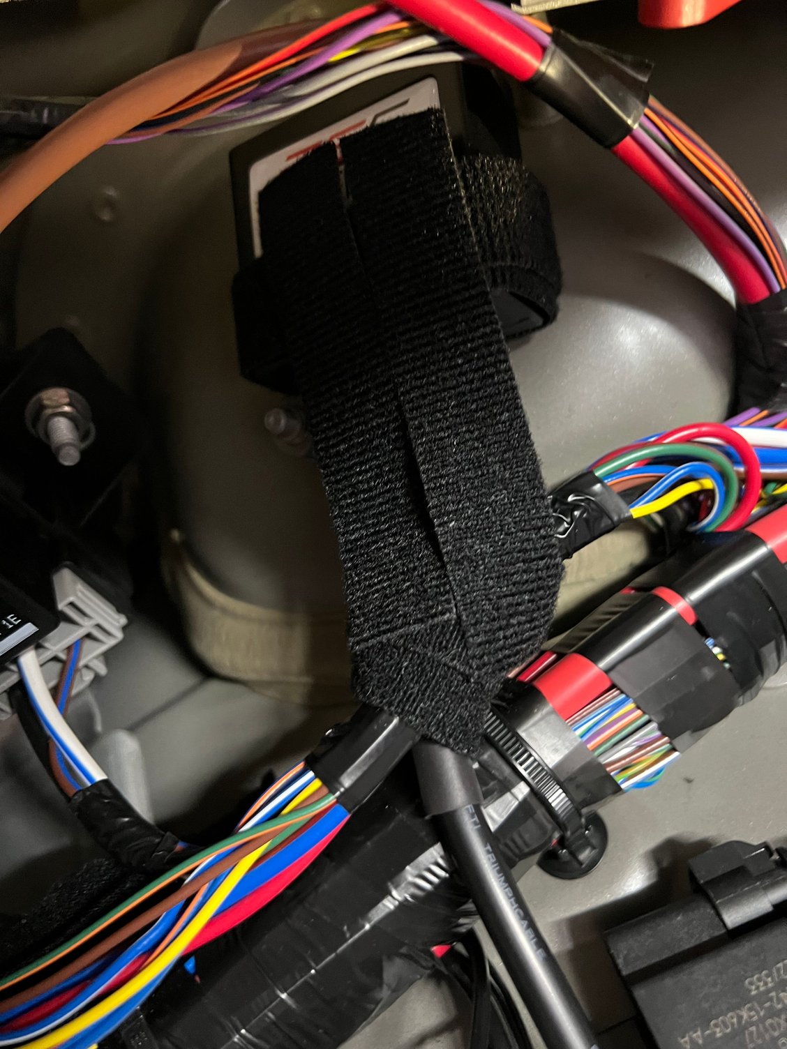

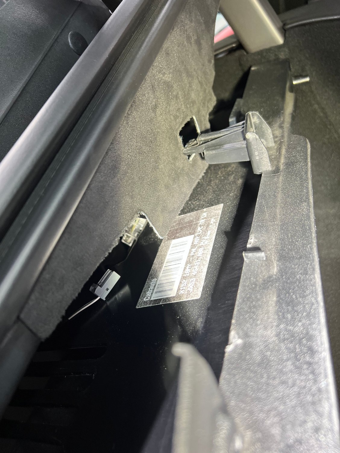

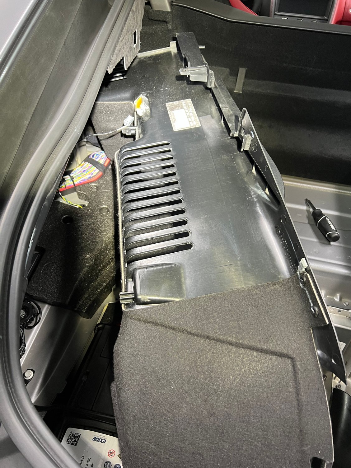

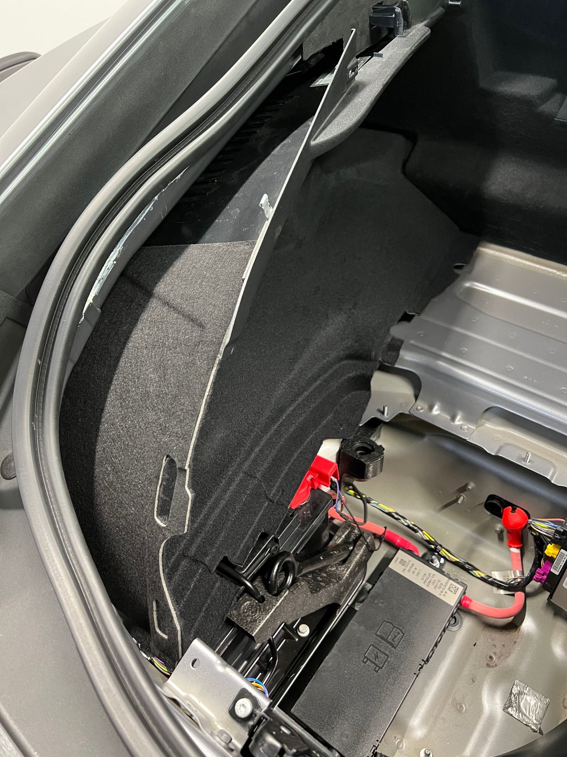

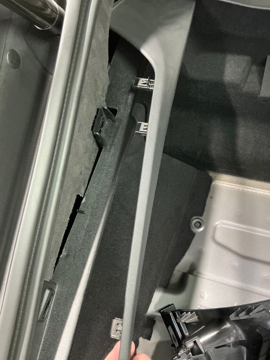

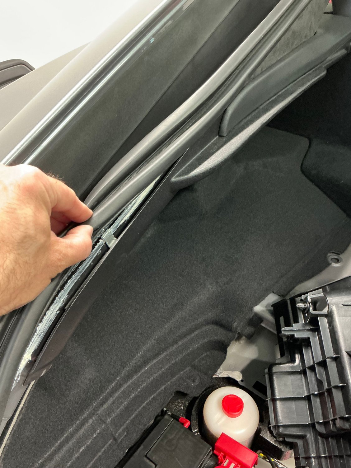

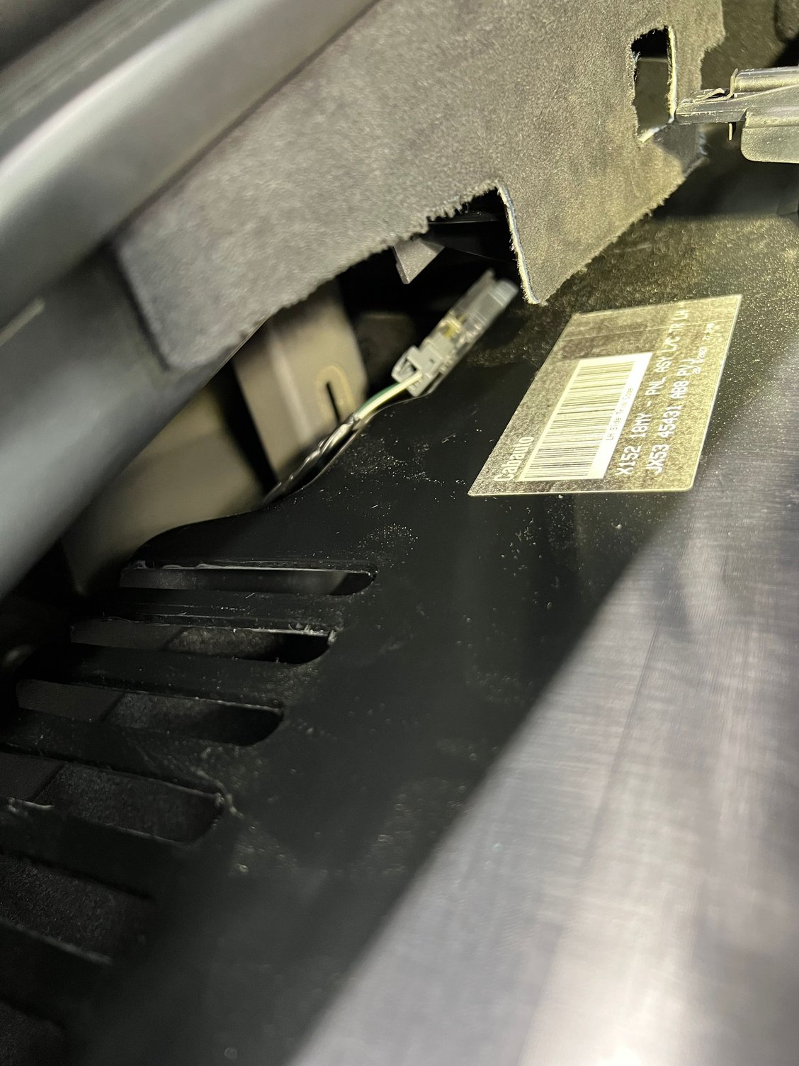

Note, my attached pictures are in order and pick up basically from step 5 in the attached workshop manual info onward...
1) Before doing anything be sure to follow the pre-installation info in the ASR documentation. It gives steps there for ensuring that the car is fully asleep before doing the install. NOTE, for some reason I was only provided instructions in German. Not convenient at all, but I just used google translate. No doubt they would have helped me out if I had contacted them, but I didn't bother. Google translate did fine.

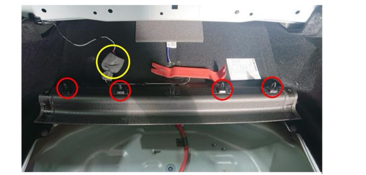

2) Remove the tonneau cover from the trunk area to get it out of your way and then follow steps 1-4 as depicted in the attached workshop manual info (pretty straightforward).
3) For step 5 in the workshop manual info it is a bit less clear, at least it was to me. It seems to indicate that you have to detach something from the safety pull handle, but I didn't end up doing that (i.e.: A tip I got from visie on the forum here when he did his install). As it turns out the wire/cable behind is long enough where you don't have to detach anything (i.e.: Once the piece is off you can just move it aside out of your way). I didn't need any tools at all. You just need to pull the piece forward towards the front of the car carefully. I started on one side and pulled carefully. Then I went to the other side and did the same. At that point the 2 depicted fasteners in the middle were still fastened, and then I carefully pulled forward in the middle. Presto, it was off. The 2 fastener you see in my hand in the first picture are those 2 depicted fasteners in the middle of the piece in the workshop manual info. They were loose so I took them out completely and put them aside so as to not lose them. The other 4 fasteners (i.e.: 2 on each end of the trim piece) stayed in tact and together for me and were not loose at all.
4) Step 6 in the workshop manual info depicts that you should remove the entire rubber seal. That is NOT necessary. Leave the rubber seal alone for now. We'll come back to it later on below.
5) Remove the piece depicted in step 7 of the workshop manual info. I wasn't originally quite clear how that came off. The clips are such that you simply need to pull it directly to the right, as can be seen in my images. It comes off quite easily. I started at the very back of the piece towards where I was standing at the back of the car and unclipped the first clip, and then I worked my way towards the front of the car (unclipping the rest of the clips slowly and carefully).
6) Remove the screw depicted in step 8 of the workshop manual info and put it and the handle assembly that comes off aside.

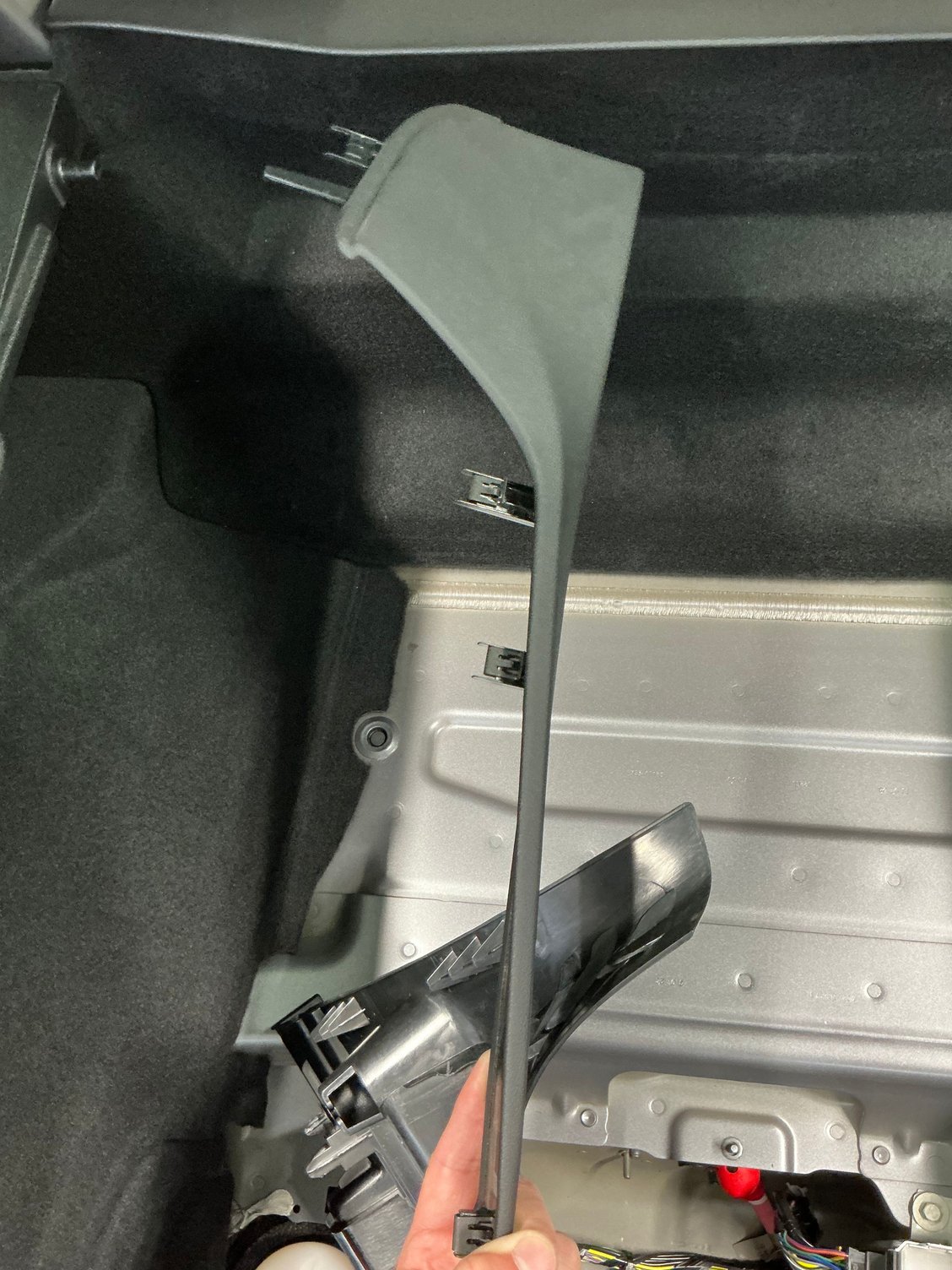

7) Step 9 of the workshop manual info depicts the removal of the last big trim piece that needs to come off. There is a metal clip on this piece that is covered over by the rubber seal. See my picture showing this (4th picture). Just pull the rubber seal up carefully only in the depicted area to expose the clip. Carefully unclip the metal clip. It comes off really easily.
8) Once the metal clip is off only pull the back part of the panel forward from the left approximately the distance depicted in my 5th image. You don't want to go any further, as a light needs to be disconnected first before doing so.

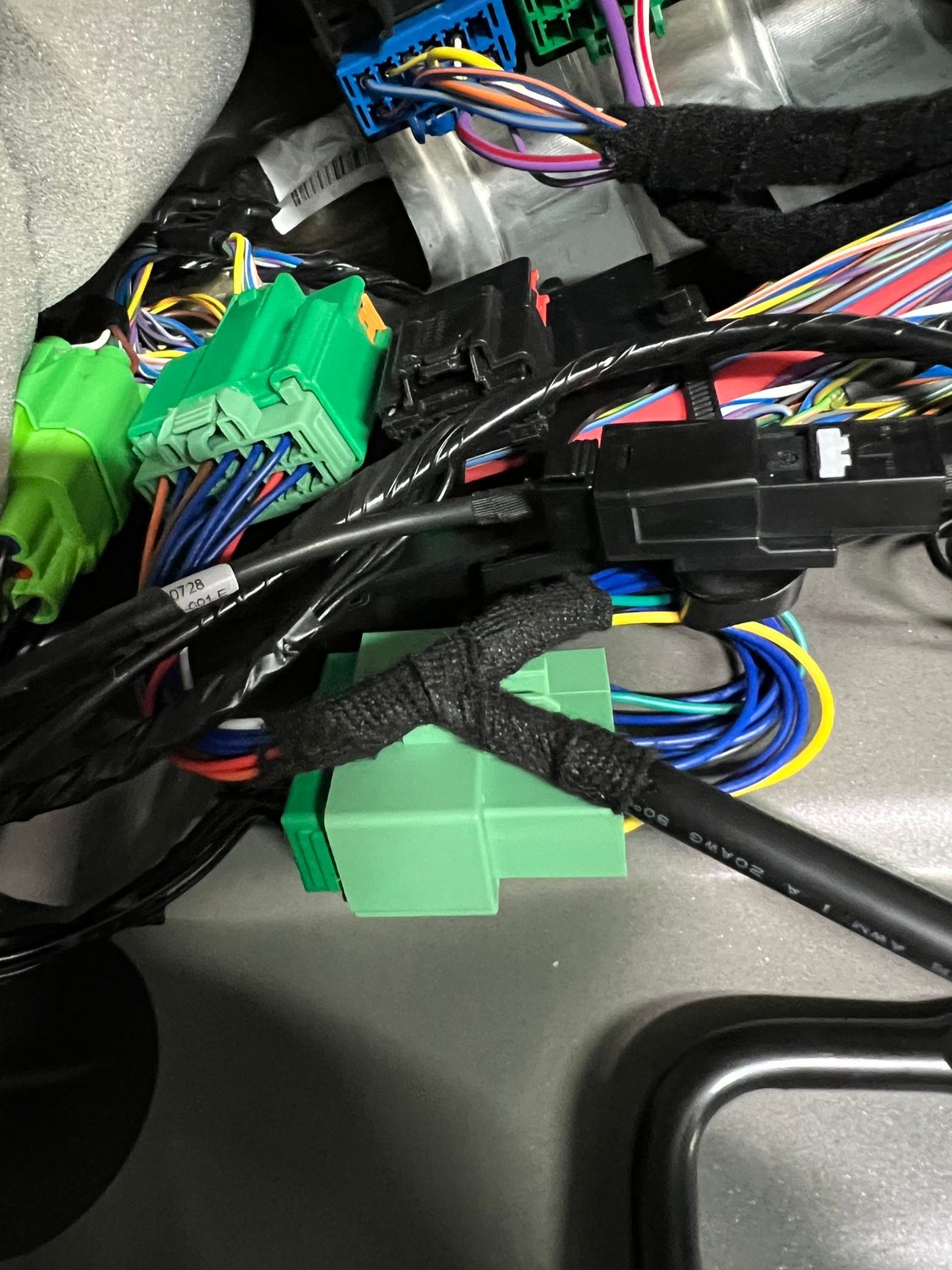

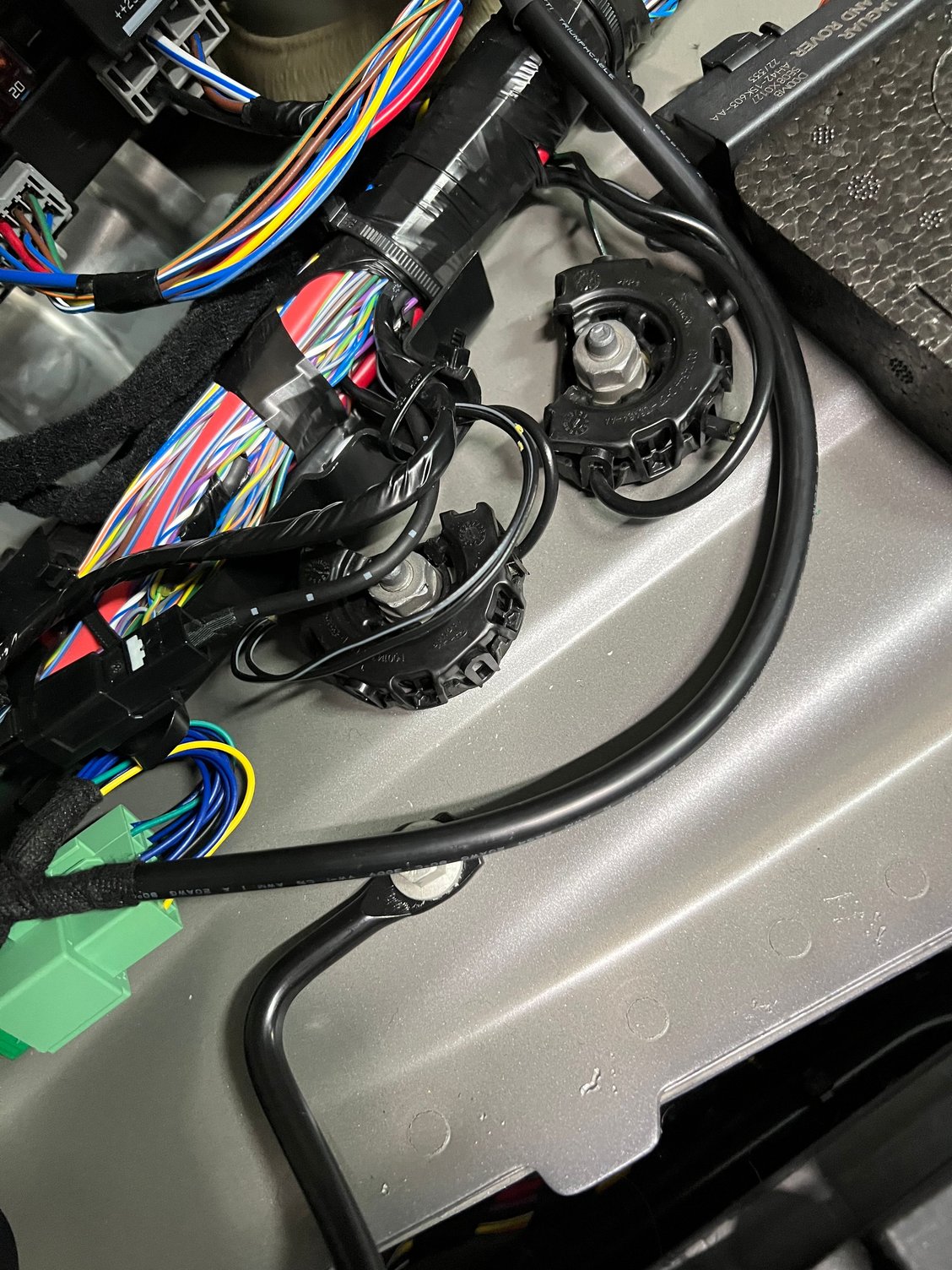

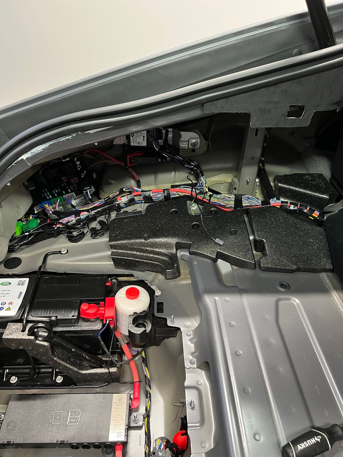

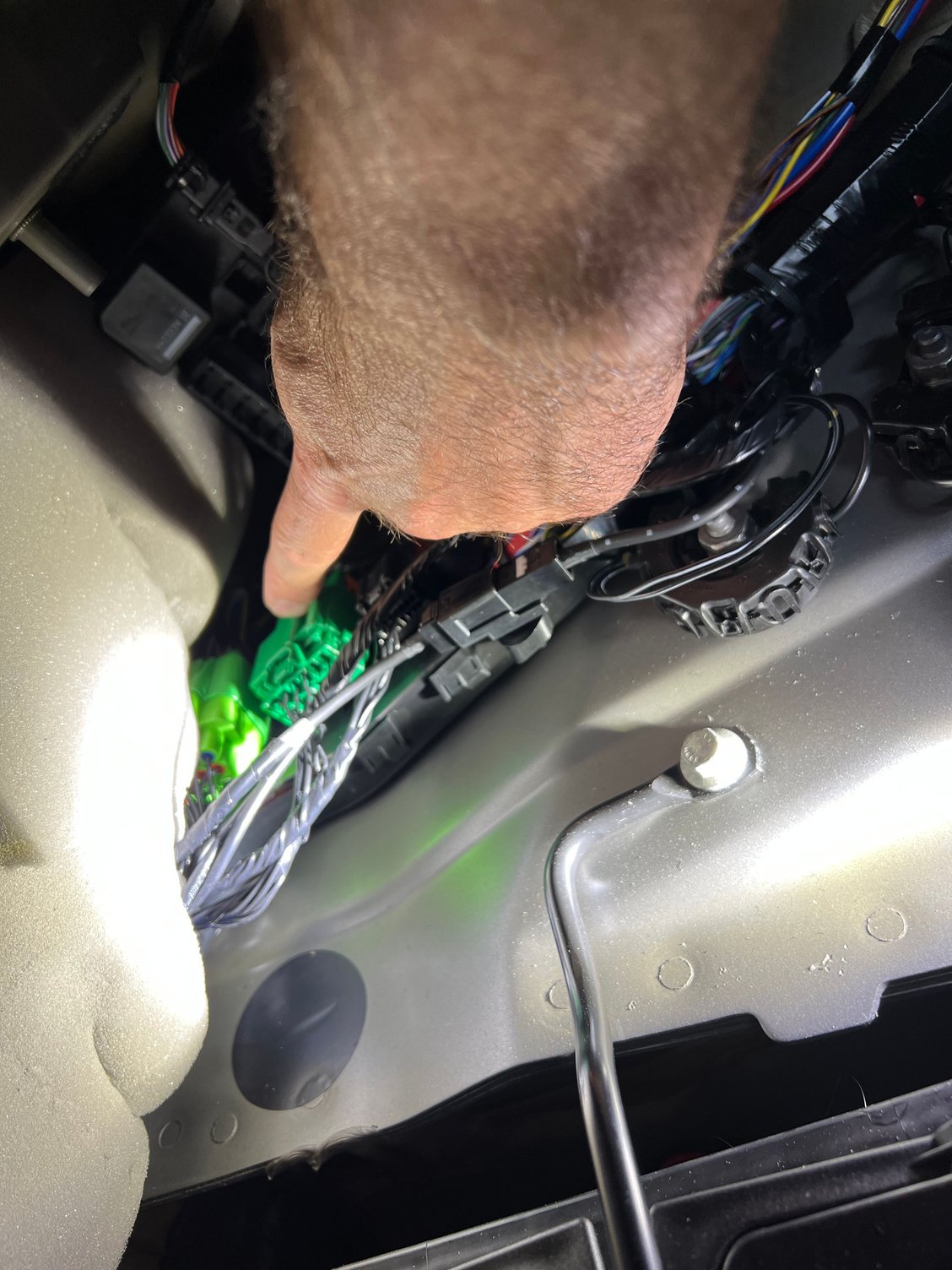

9) Carefully disconnect the light connection shown in my images. At this point you can remove the trim piece completely out of the way to expose the wiring harness of the car.
10) The darker green connector towards the back of the car on that now exposed side is what needs to be used to connect the ASR device in. This plug is clearly indicated in the ASR documentation. At this point you need to unplug the car's male connector from the female plug. For some reason this was not easy to do in my case. It was awkward. In the end I carefully climbed into the back of the car (be really careful if you go this route, not a lot of room and lots of things to step on and break). That made it less awkward, and eventually I was able to carefully get it out while pressing the tab on the top of the plug there. It's not rocket science obviously, but I found it a pain for whatever the reason. Mileage may vary on this.
11) Then you simply need to plug in the male plug of the ASR to the car's female and the original male connector of the car to the female connector of the ASR device (shown in my 11th image).
12) My last 2 images show how I chose to route the ASR cable and place the device itself. I took care to not have the device rest on any wires incase it ever ran hot or anything (i.e.: Never know, if it failed hard or something), and I made sure it could not rattle. I also placed it like this so that its install was not evident at all around the battery area without fully disassembling the trim like we have here for the install.
YOU'RE DONE!
Just test the device to confirm it's working, and then reassemble everything in the reverse order.
Hopefully someone will find this helpful.

Hi there,
Those pictures you are asking about are in reference to steps #8 and #9 in the guide. That is just a connector giving power to the light on that side panel you are going to be removing. You are correct, that connector has nothing to directly do with the ASR install itself.
The 6th imagine down from the top shows the light connector connected as you first pull the panel back a bit…You just need to make sure you disconnect that before removing the panel anymore than depicted in that image, as you clearly could cause some problems otherwise.
Make sense?
Hope that helps…

Yeah, okay, so nothing to worry about. Just follow my guide and you should have no surprises. I assume that picture was from the ASR documentation. I remember they used the convertible in their docs…I guess that’s what they had access to.
I understand what you are doing here…Just gathering clarity and getting comfortable with everything in your brain before tearing your F-type apart…lol…Totally get it. I felt the same at the time. This was why I did this guide, to hopefully make things clearer and less concerning for someone else.
In any case, welcome, and best of luck. It’s a really great product. You will love it.

Got it all buttoned back up. I couldn't get that trim panel in the middle flush like it was so I'll make more adjustments over the weekend. The device worked flawlessly, which is great these days. I zip tied it out of the way of any potential hazards. One thing I noticed immediately was I can clearly hear augmented sound from the speakers now when I activate the exhaust button inside. I knew it was there, but I never heard it so clearly. It's very prominent in the comfort setting with the module off [3]. I will avoid that at all costs. I'll get it out on the road for a few miles this weekend to see how well it performs while driving. Have you noticed anything different about the remotes? I'm guessing maybe just different designs. They both work, so it's no big deal. Just odd to have different styles.
Thanks again for the trim removal tips and pics.
