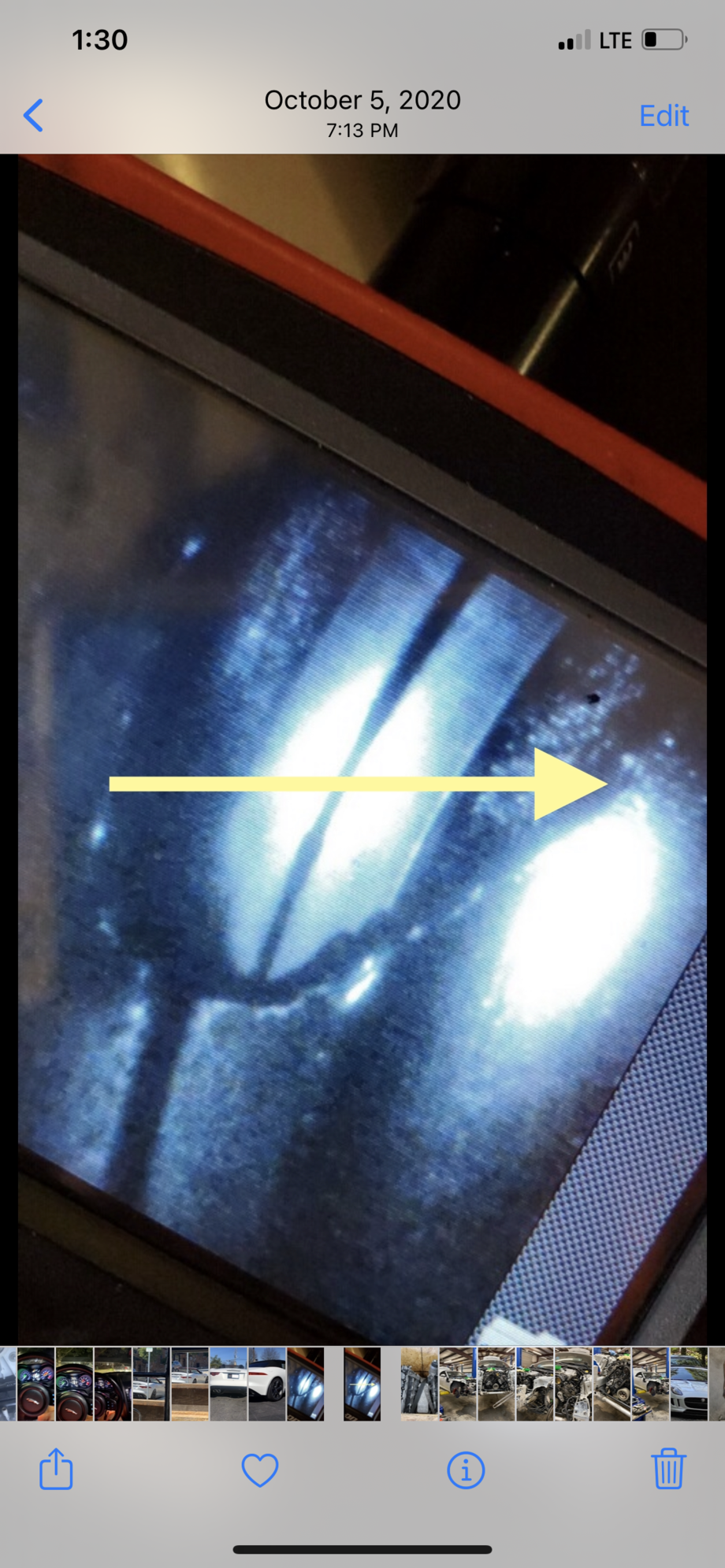

I don’t know your exact situation, but I have been there. My 2014 s v8 had a similiar issue. If the piston is damaged, they can easily see that with a scope. Any competent shop shouldn’t be guessing and should exam the car thoroughly. Here is a pic of my damaged piston from 2020.
Original motor, hole in piston, unknown foreign object
