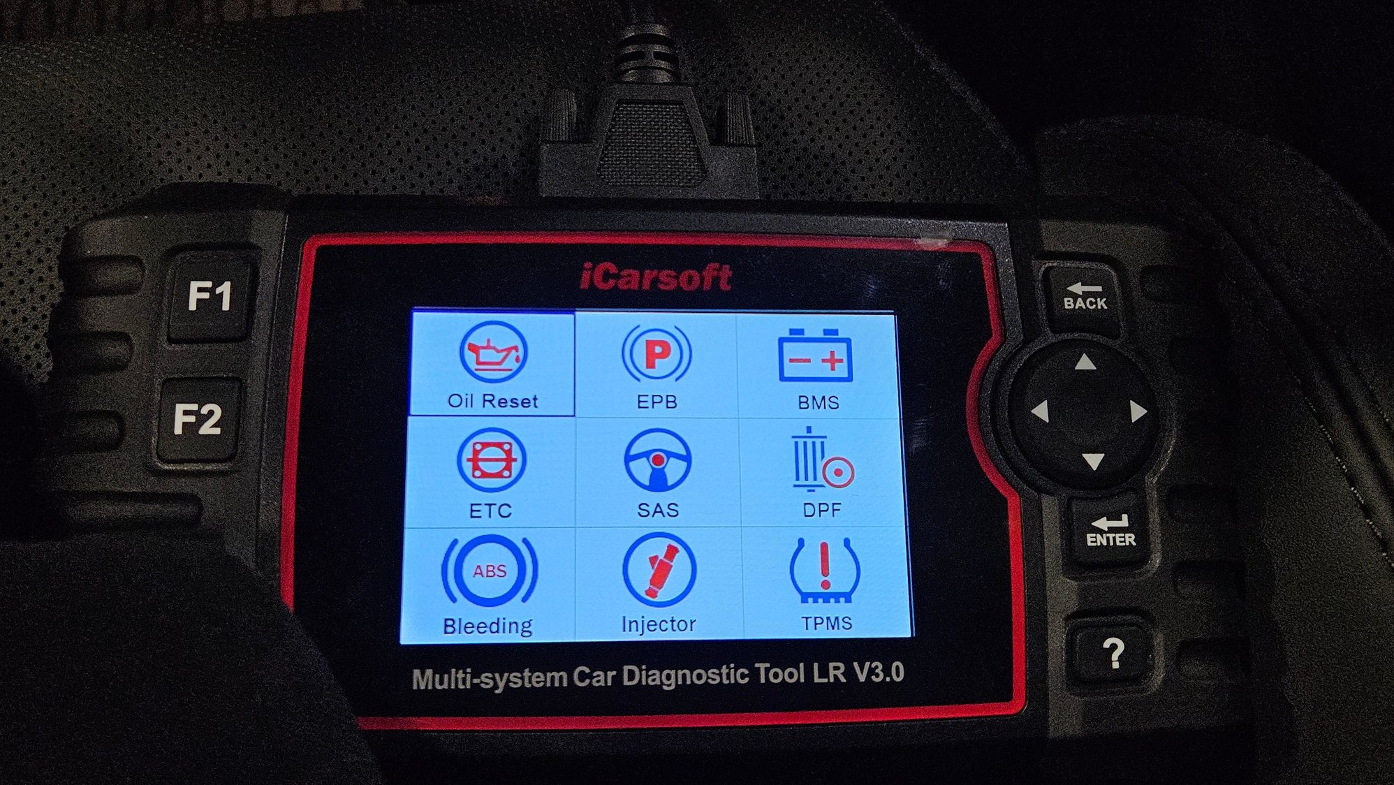

You have to reset the bms with a scan tool
I'll be posting another video of my wife's F-type R Maintenance and Battery info, I'm putting a Stage 4 for here

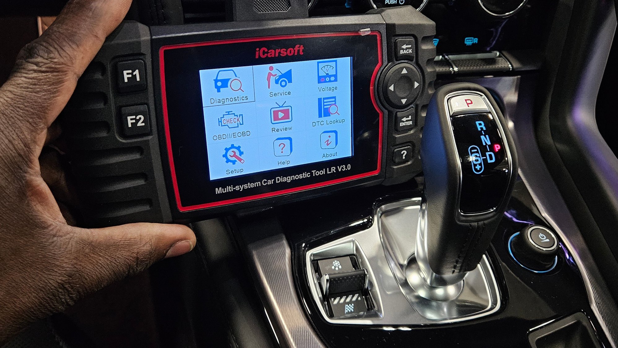

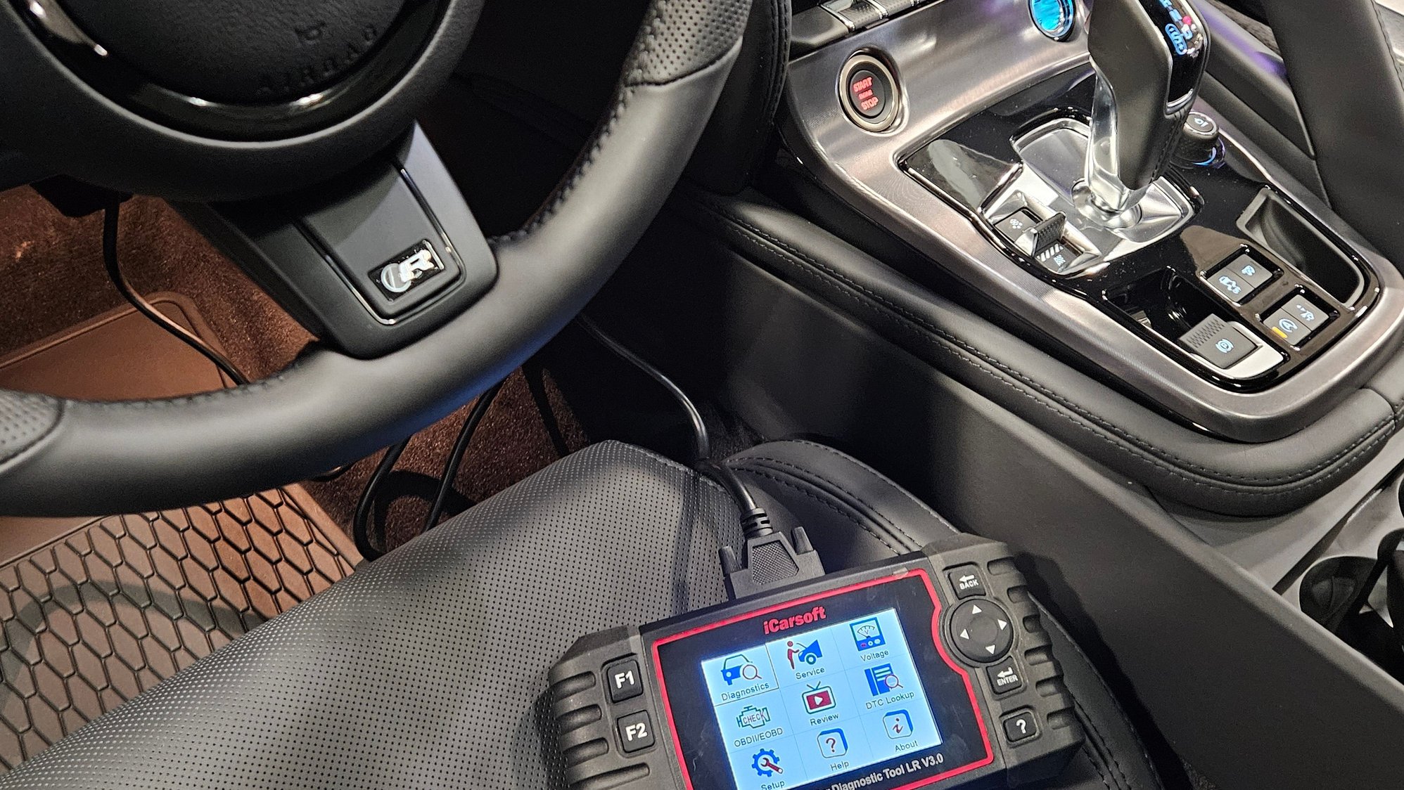

I noticed in your pictures an Isoft scanner V3.0, however, I looked these up and they're specified for Porsche, is that sequestered for Porsche only, or is it available to all makes?. Just curious.

Here’s the JLR version. I got mine off Amazon.

This ICARSOFT v3 is specific for Jaguar/Range rover
