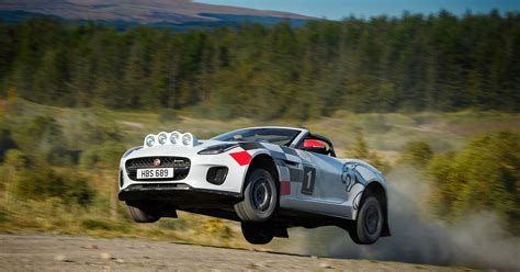

JLR had a go at jacking an F-Type up. They also made it fly ;-)
