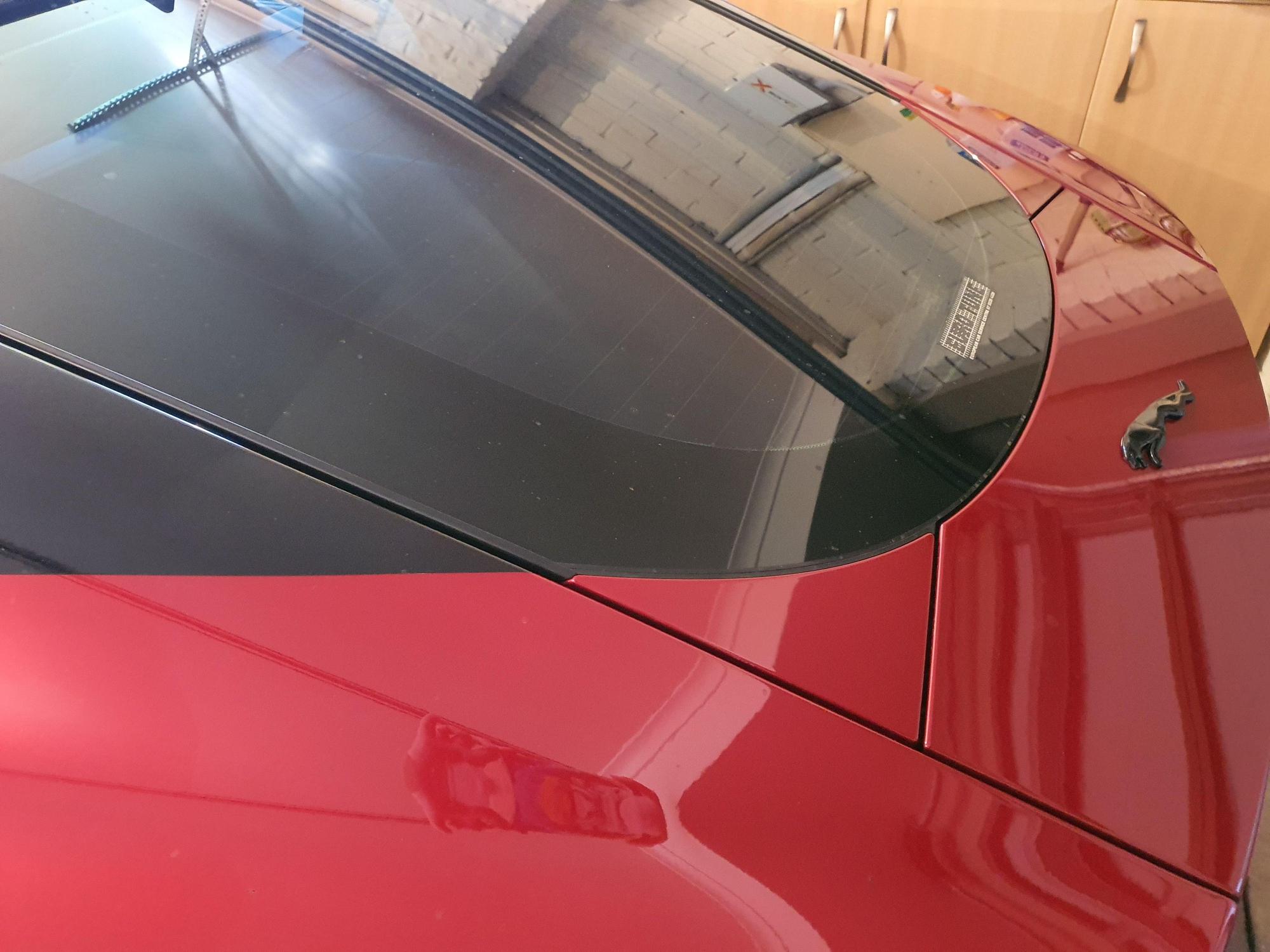

Pics requested recently, nothing to do with squeaky wheel.

Thanks Bruce , nice and clean side line , thanks

I was thinking about having the A pillars on my vert wrapped in black. Still undecided, but that looks really good Bruce.

Think Bruce this needs a separate thread, anyone else done the pillars
