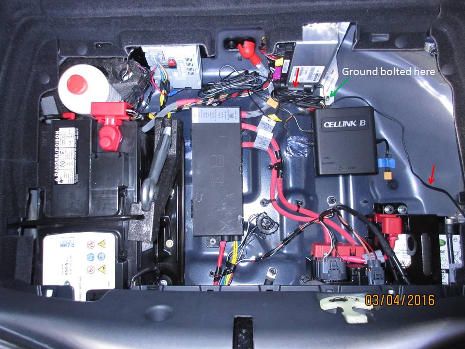

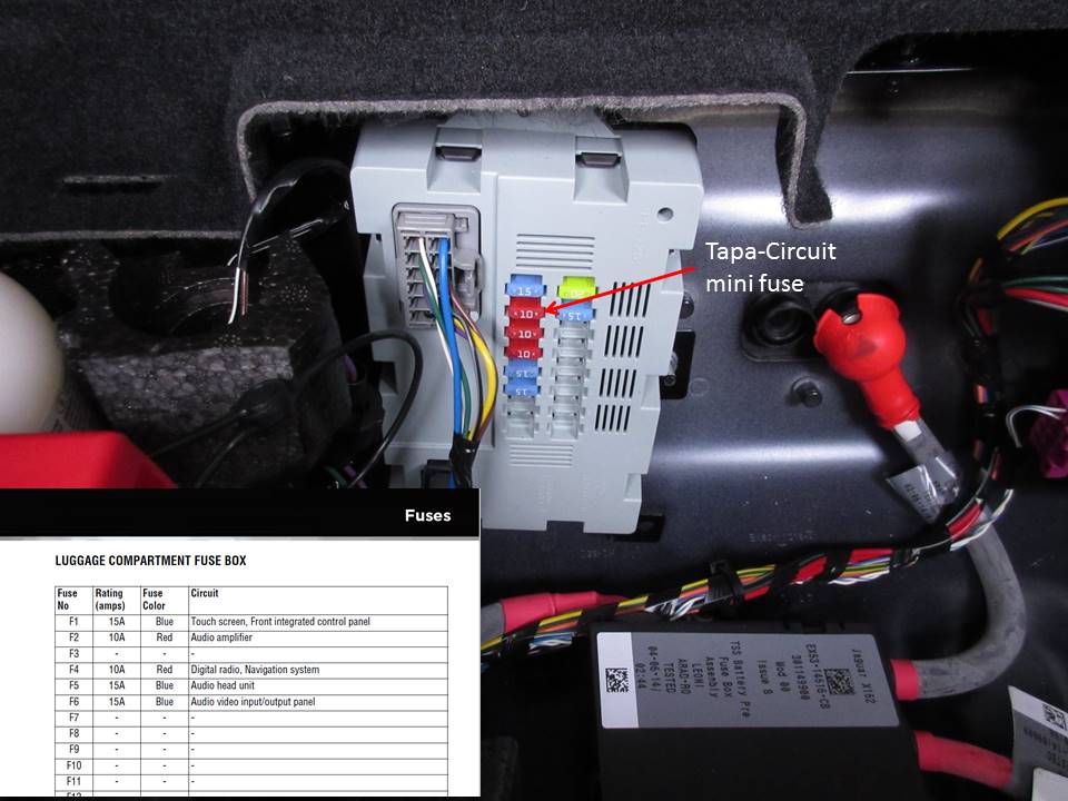

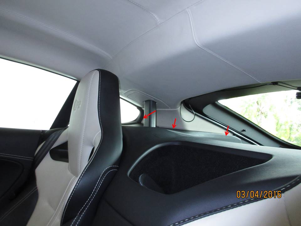

I've wanted to install a dashcam for months but have not due to headliner issues. I thought the headliner issues wouldn't return so I purchased the dashcam. Well I said screw it and installed the dashcamn today. The following photos show how I routed the wires. A few things I would do differently. Blackout the white writing on the front dashcam bracket, get a larger crimp ground ring, and ensure the heating elements are not in the middle of the rear camera. I put some foam spacers on the left side of the battery before I velcroed it down. I hope the pictures are self explanatory. I know the front camera blocks the auto headlight feature but I never use it.

did you take the power supply cord from the front camera unit back to the trunk? Did you just go along the driver's side taking the same route?
Both cords run along the passenger side, they split were I hide the rear camera excess cord. The power cord continues into the trunk.

Awesome. What is the cellink box for and is that part of your install?
Cellink is a separate battery for the camera to run on so it doesn't draw any power from the cars battery. Its a complete package from blackboxmycar's website.

Low battery issue popped up while the car was at the dealership all week for another attempt to fix the headliner. Dealership says the Cellink was not letting the car go to sleep. I have removed the tap a circuit and moved the positive to the eco-battery.
Well that's unfortunate. So the Eco battery will drain while parked?
The cellink is rated for 72 hrs in parking mode and takes one hour of driving to charge. It should not drain the eco battery if you drive enough. By attaching to the eco battery the car should now go in sleep mode. If you don't drive the car enough at least the main battery will still start the car.
