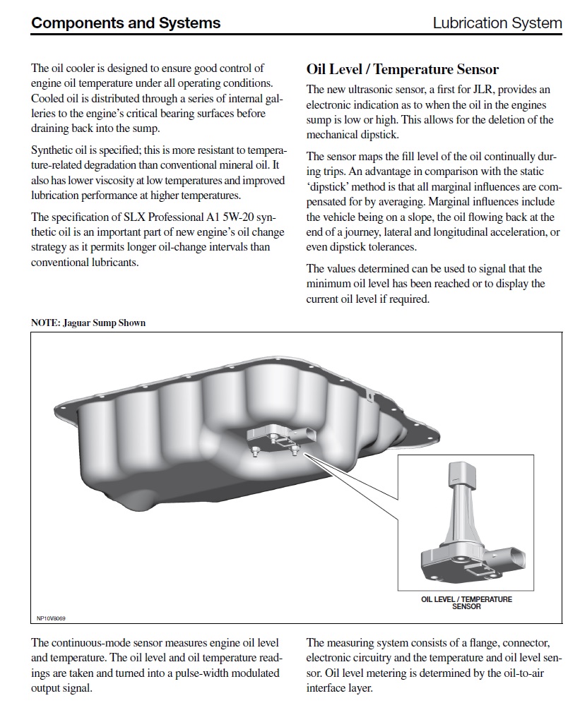

Found this in the diagrams:
This seems like an innovative feature, but where and when does this electronic wisardry actually display a reading or warning?
