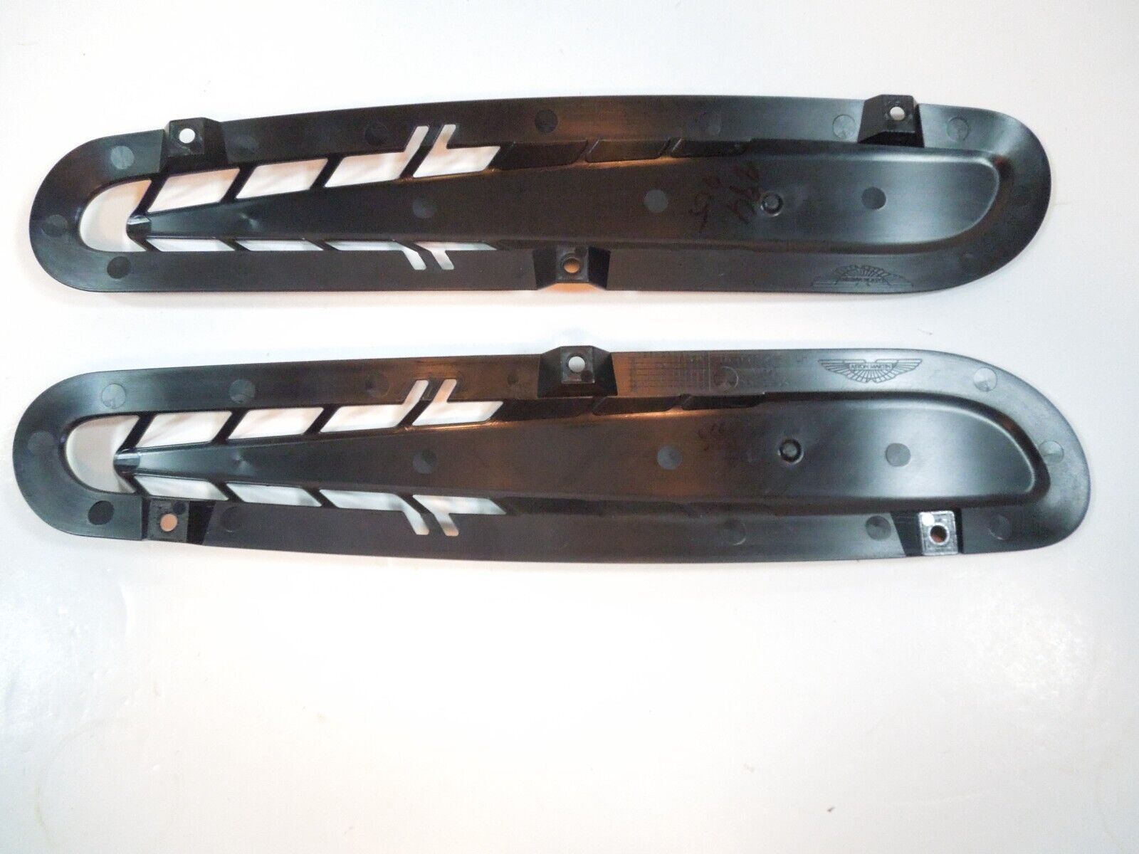

On my Aston, the DB11 with the V12 comes with two extra hood vents (4 total), The inner two are right over the cylinder heads and on a V12 with a 60* bank, the coils end up almost directly under the vents so if you find yourself in rainy driving conditions a lot (or washing the car) the coils get soaked under water which eventually causes a problem.
AMs solution was these (accessory) water shields that allow the ventilation but divert the water away from the tops of the cylinders.
They mount under the hood on the same hardware that holds the vent screen in place. They work very well and I have them on my car. My engine never has water, or even wet on top of the cylinder heads.
Seems to me this might be a good "project" for someone that could lead to an aftermarket product for sale.
The ones for Aston are factory, so they are stupidly expensive, but I see them on Ebay all the time.

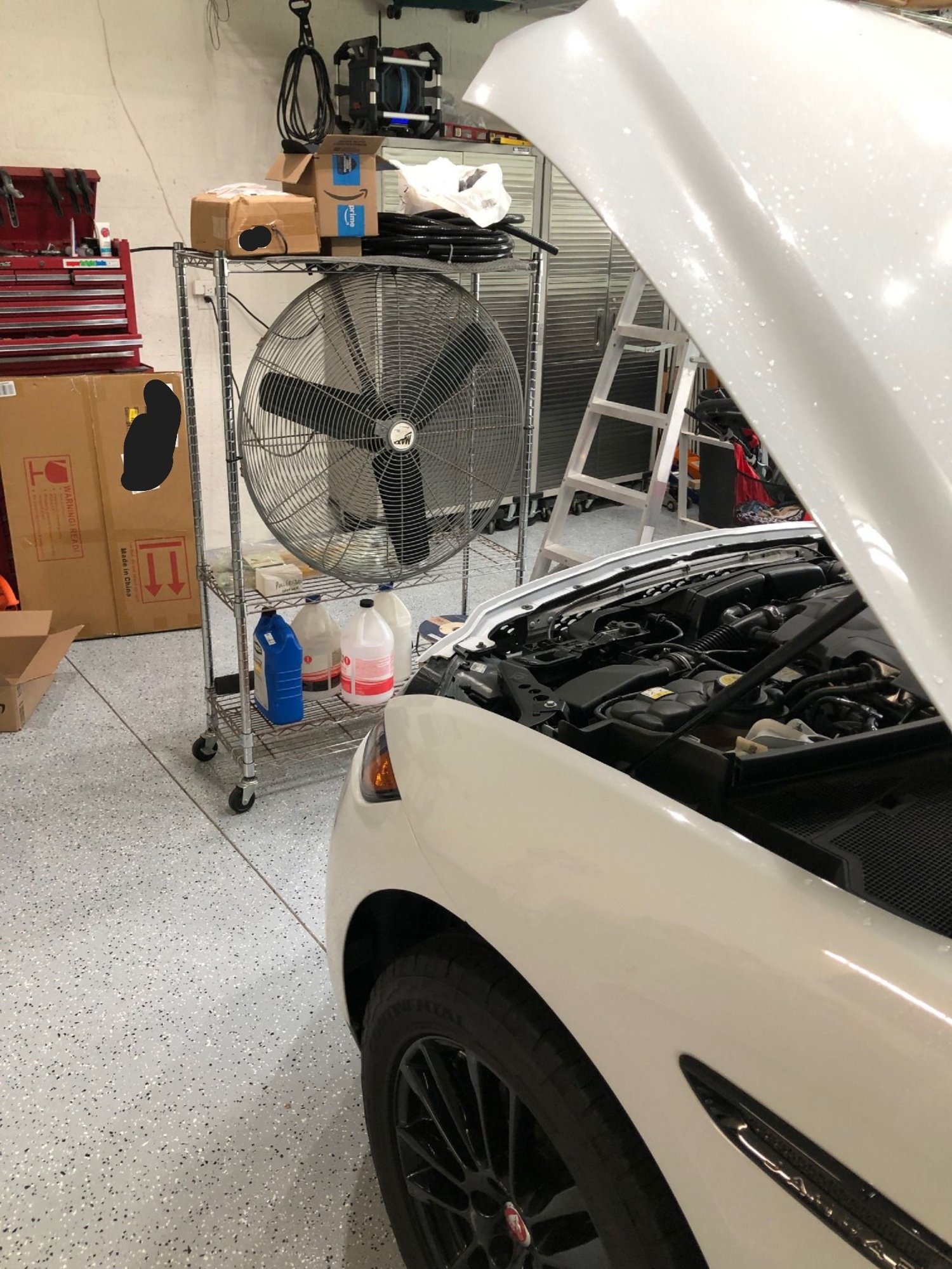

One other 'best practice' is to just open the bonnet/hood after a hot drive. I am able to pull in to our garage for this. On warm days with my E type, he gets back in the garage, bonnet/hood goes up and I set a small oscillating fan on an upturned 5 gal bucket and aim it at the engine.
Old Aug 10, 2025 | 12:37 PM
Dionysus's Avatar
Joined: Apr 2022
Posts: 133
Likes: 60
Hahaaa... I had to chuckle a little bit when I read your post.
I've been known to do the same after a "hot" drive in the summer in FL. I rigged up this 3 speed floor fan on a wire rack that I can roll around anywhere in my garage. It is industrial and I could use it if the car was on a dyno...haha... Get's it cooled down FAST!
