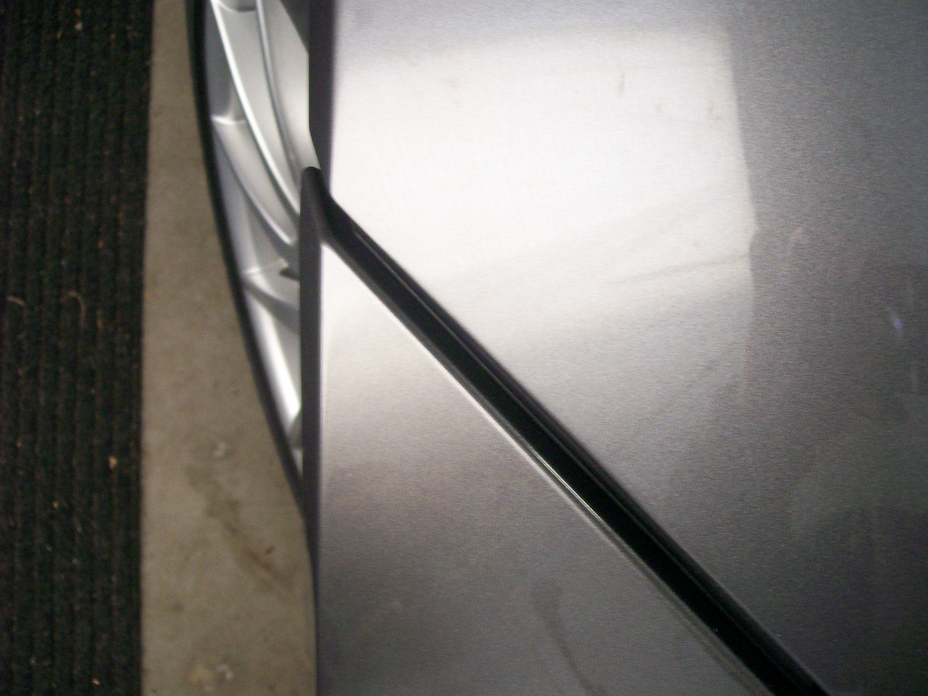

Default Panel fitment
When I was looking at my 2017 in 2020, there were some panel fitment issues that I noticed.. where the bonnet/hood lines up over the front tires. I downloaded all the workshop pages to see what it would take to make it better. UGH.. seemed to me that it was not worth the massive effort and likely to make other fitted areas worse. I did have a headlight assembly area that stuck out to the side. I just happened to press in on it when trying to get around the car, and the whole panel moved inward. I did some forum research and read that an owner had an identical issue and found that the headlight bolts were partially out of their holes. The headlight bolts in question are behind two yellow-ish plugs in the front tire wheel well. When I looked in there, there were NO bolts at all. Bought replacements, put them in and aligned the panel. One would think at this price point (originally) that fit and finish would be better. I looked at new 2024s in the showroom and they were about the same. Oh well.
and IMO, I would not consider a car that had suffered a side swipe crash. Hang in there. Your car is out there, be patient, you will find it!
Yeah, minor body stuff like this is not something I'm afraid to tinker with if necessary, but coming from a fairly modified car in my Impreza (which was quite problem-free, to be honest), I'm kind of looking forward to have just a nice car with minimal need to change or fix anything - just something I can enjoy driving and occasionally maintaining. Where can I find these workshop pages? I've always tried to keep a copy of the shop manuals for whatever car I've owned (or, back before the Internet, a Haynes book!)
I really appreciate your encouragement! I think if I could find it, my ideal would be a red V6S RWD coupe with the suede seats... but I guess the chase is sometimes part of the fun.
Yup patience is key. If at all possible get a car with comprehensive maintenance history.
Panel adjustment isn't hard, it just requires method and patience. Most alignment issues are really minor and a 5 minute task. Check out this video:
