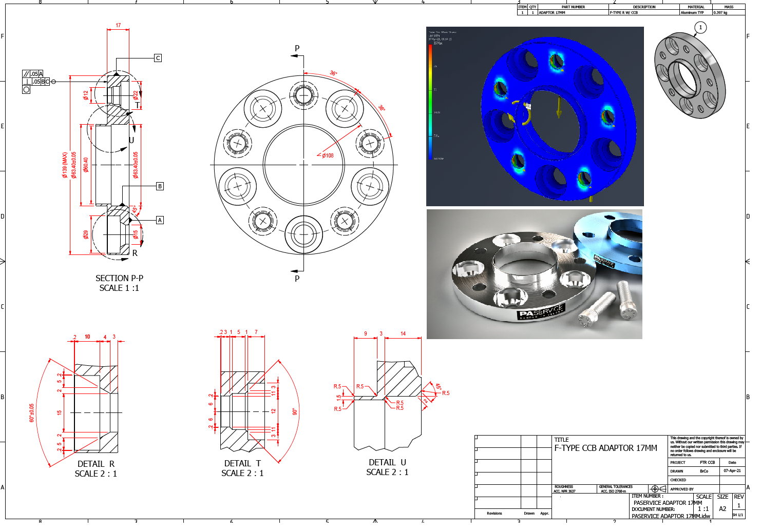

I designed a 10mm spacer but wasn't enough for the spokes of my BBS, so i went for 17mm adaptor hub, so far works great, extra balancing accuracy was required to remove all steering vibrations. Let me know if you need step files and drawings.

Indeed, normally is 150mm, but anyway is flat so could be more, on this hats you have an inverted bevel, best 138mm. If your prefer a affordable solution, you can also order a normal spacer 150 mm and machine a 45deg chamfer on the back edge, thickness 10mm should enough for the hat, then you need to check if enough for the spokes (i doubt).

Mine are 138 to make sure clearance, drawings/ tolerances are unknown, as you see on my drawing 139 is the max until the bevel but I only measured one not all 4, i did some calculations to check stress but still ordered from a specialized company to make sure was according their specs/ standards.
