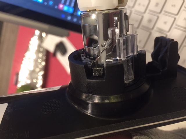

After the tabs are pushed out of the way there is a little black housing that prevents the socket from being removed from the trim. How is that part removed?
lighter/1 v power socket

I just installed my new Carbon Fiber Console trim kit.
First the install instructions for these parts suck. Next that part just snaps straight down onto the housing, just put a thin screw driver under the middle of the connector and give a slight twist and it will pop off. then snap it back on after you move the housing to the new trim part.
For removing the lighter housing from the old trim part; there are 2 tabs that need to be released shown further up in post #4. The easiest way is to hold the trim piece in one hand with your thumb pushing down on the socket and push in on the top of the tapered part of the release tab (not the bottom) with a small screw driver, keep holding pressure with your thumb after it releases and push on the other release tab or the first one will snap back in place, The housing will pop loose in your hand.
The CF kit comes with a black trim ring for around the light socket to replace the bright trim piece but I didn't replace that piece because there are no instructions for it and it's almost invisible and not worth breaking the lighter socket trying to take it apart without knowing how.
