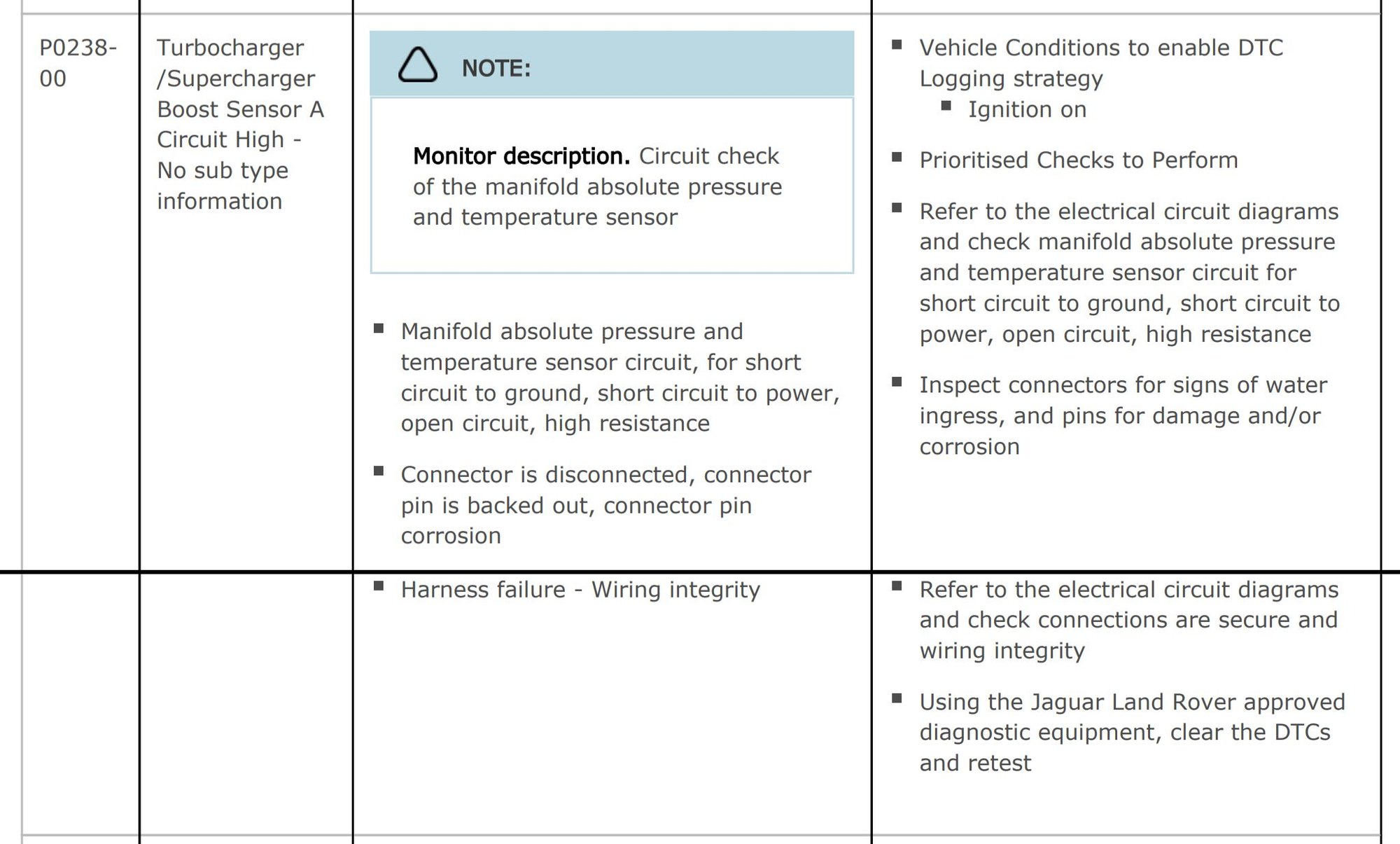

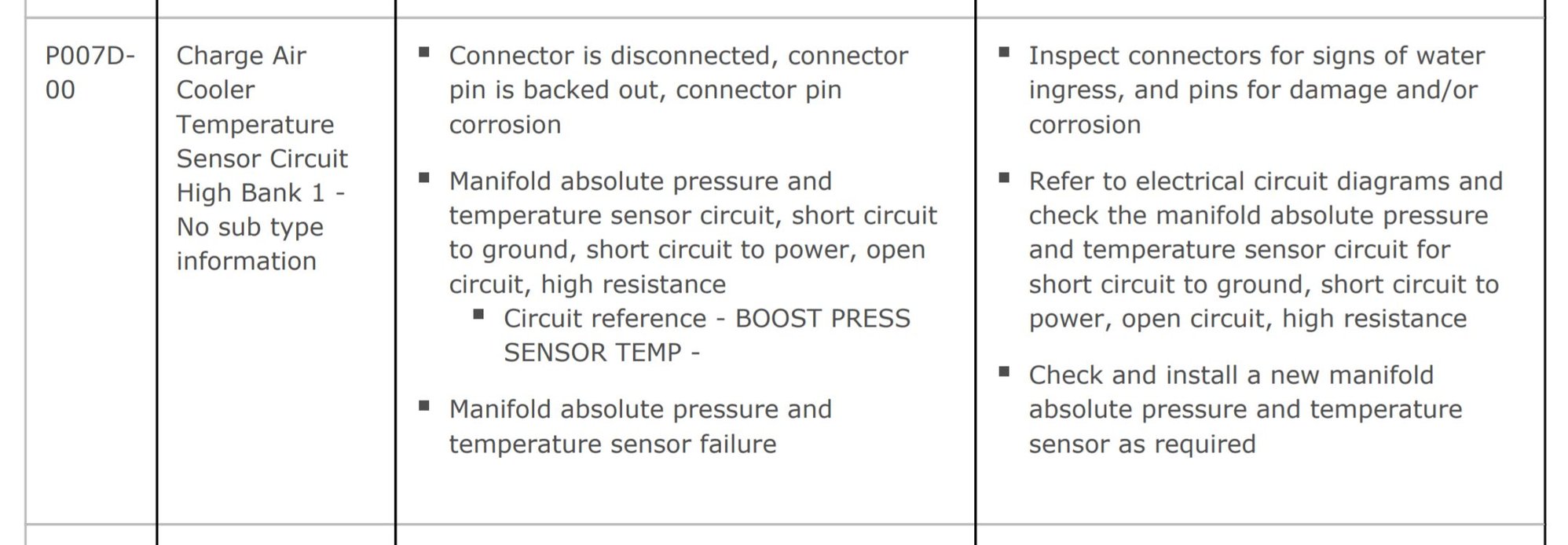

I just did the y-pipe upgrade on my 2015 F-Type Base. I am running with good temps and no leaks now, which is great. However, I now have a CEL, and am getting two codes:
P007D, which Google tells me, OBDII code P007D indicates a "Charge Air Cooler Temperature Sensor Circuit High".
P0238, which Google tells me, OBDII code P0238 signifies a "Turbocharger Boost Sensor A Circuit High".
I have checked all of the wire connections, plugs and stuff and everything seems to be plugged in ok. I was concerned that the problem was the manifold gasket (the metal one) because I had reused the old one when I did the upgrade, so I ordered a new one and replaced it. But after that replacement I get the same two codes. Also, I'm not in what I would call limp mode, but performance is definitely restricted as the car will not rev over 3000 RPM.

From the repair manual, which can be found here…
https://www.dropbox.com/scl/fi/o6d1x...=fqnaquye&dl=0
Note that both codes refer to the “Manifold absolute pressure and temperature sensor circuit”. The repair manual has schematics at the end.

@DJS - absolute life saver! Thank you!
The manual you linked to is much better than the one I already had - or at least more usable. The other one is 28,000 + pages long, and I have a heck of a time finding anything in it. Page 3839 of yours had the diagram I needed to find the MAP sensor plug, and I discovered that it was indeed not fully plugged in. Got that plug seated, and cleared both codes.
