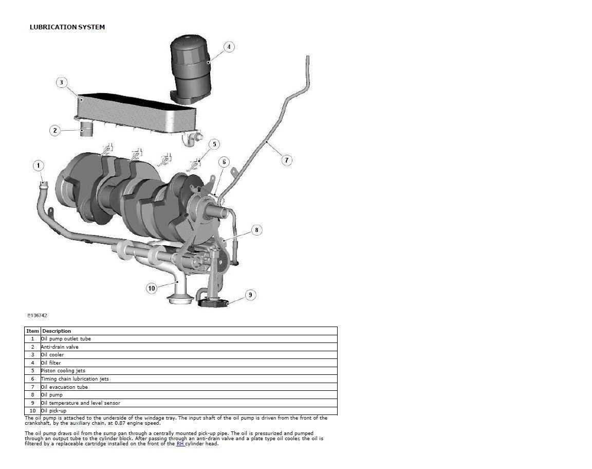

Must be bad luck of the draw. 30+k miles on my engine that sees 20 psi of boost every time I drive it. Never an issue, but I do keep an eye on all the fluid levels. Regarding a dipstick, I’m working on developing a flexible dipstick constructed similar to an old fashioned speedometer cable that would fit down the oil suction tube. I’m using one on my MINI.
Watching with interest.
That said I don't like your chances of success, just too many bends in that suction tube!

I’m in the middle of a massive kitchen remodel, so nothing happening soon. The paramount sc heat exchanger is still sitting on the workbench and I still need to get a machine shop to convert the OEM shifter into a short shifter. The original short shifter fabricator has discontinued production (insufficient demand) and we have a couple forum members that need one.
As long as the bends are not too sharp, my dipstick concept should work.
No real sharp bends (around 90 degrees max) but a helluva lot of 'em, especially down the bottom end where it would get a bit difficult to push it through:
