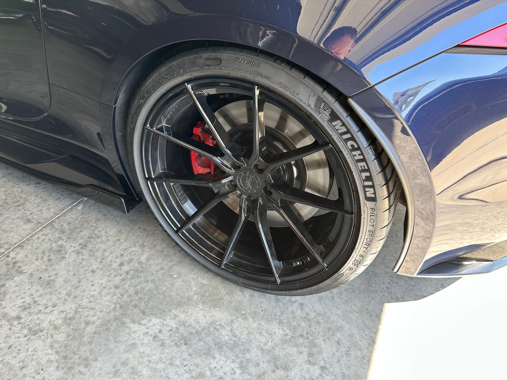

First and foremost, I finally after 5 years of ownership on Pirelli P-Zero tires, swapped to Michelin Pilot Sport 4s. I will leave well enough alone there, but a welcome addition. In the process of getting ready for new tires, as the car is approaching 8 years, I figured it was a good time to replace the OEM TPMS sensors in the process. The biggest challenge I saw was that I did not want to pay almost $500 for OEM sensors, when others could be obtained at a tenth of the price.

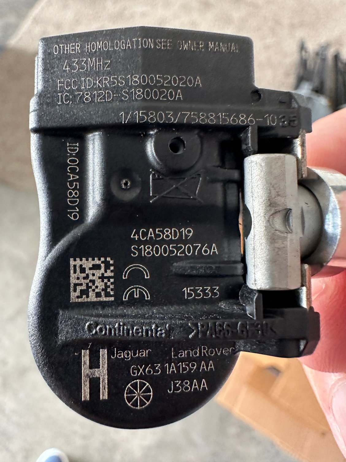

The absolute best thing you can do, ahead of time is using a scan tool, like an Autel TPMS scanner, you would be able to see exactly which model TPMS sensor is installed and more importantly which variant. You'll see either a FW93…1A159…AB for Low pressure (C2Z31510, C2D21599, C2C41655) and GX63…1A159...AA for high pressure (C2D47173). These part numbers are for the 433Mhz dilemma...
Also if you want to refer to an VDO application guide, which is the company that makes these OEM sensor. Here's the link:
https://www.vdo.com/media/182593/201...ation-list.pdf

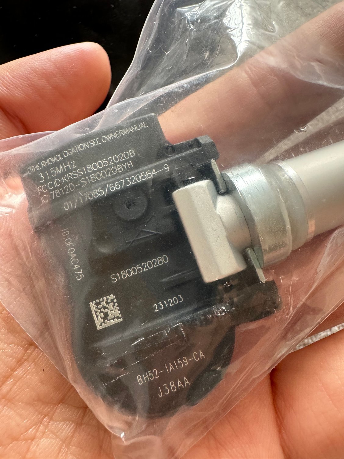

After much research and scanner, I determined that I had the GX63 variant of the sensor, with a very specific identification sensor number. In my case, S180052076 (3 ended with an A, 1 with a B) all the same.
So I went onto Amazon and located the following item with the exact same ID numbers:
Amazon.com: BDFHYK Programmed TPMS Sensor Compatible with Land Rover Rover Evoque Sport Velar Vogue Grand Evoque Discovery Sport Defender Jaguar E-Pace F-Pace F-Type I-Pace XE XF XJ 433 MHz Tire Pressure Sensor : Automotive Amazon.com: BDFHYK Programmed TPMS Sensor Compatible with Land Rover Rover Evoque Sport Velar Vogue Grand Evoque Discovery Sport Defender Jaguar E-Pace F-Pace F-Type I-Pace XE XF XJ 433 MHz Tire Pressure Sensor : Automotive
I had the new tires, mounted and balanced and the new sensors installed. Now the fun began. Driving back from the shop, I had the normal, TPMS sensor light on and eventually the entire system had a melt down and threw the dreaded tire pressure fault, X’s on the tire pressure views and was not reading the new sensors. Probably did not help that I took home with me the old sensors and the entire system was trying to figure out what sensor was what.
Once home, I removed the OEM sensors from field of view of the car, checked that the new sensors were active and working (via my Autel TPMS tool) and rather then going through JLR’s painful process of relearning, did a forced trigger of each of the new sensors, to obtain their ID’s and then load via ODB relearn process.
The result, a $50 set of TPMS sensors that work just as good as OEM and this amazing consolidation of information to share with all of you. I am including pictures of a chart I found below, source for some of this information shared, pictures of the old sensor and link to the new ones. Hope this helps someone, along the way. Oh a picture of those beautiful new PS4S’s.

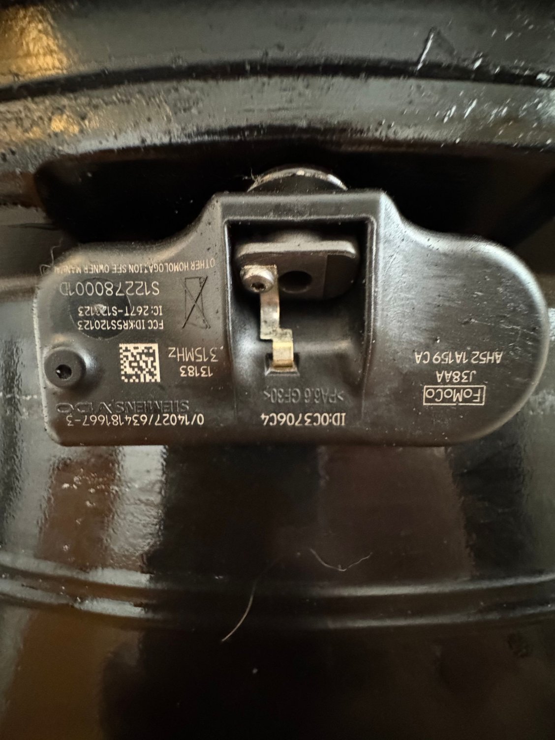

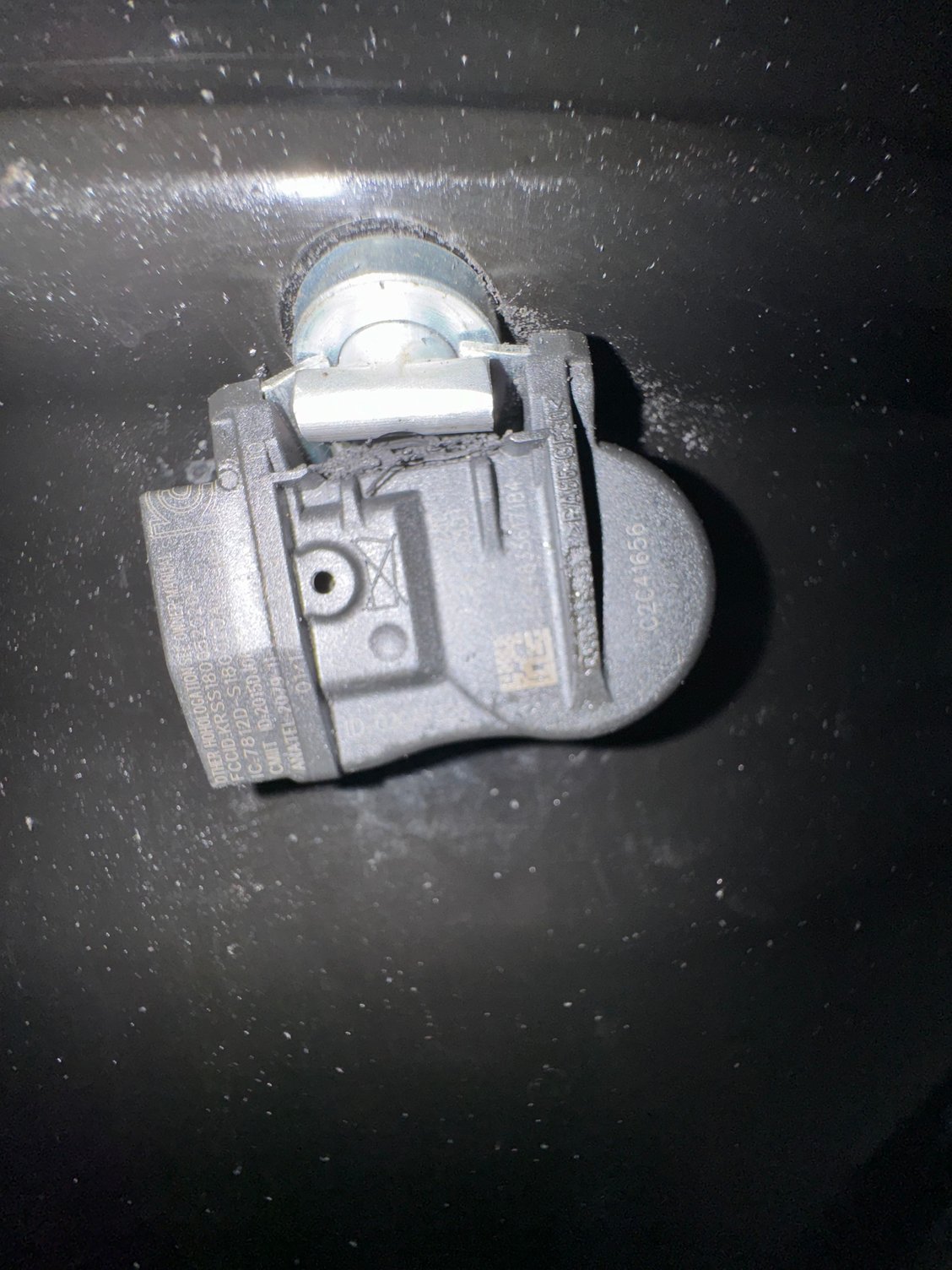

From 2015 R vin k18454, 315mhz(not marked)
From 2015 R vin k14954, 315mhz, a completely different design but worked with the above
Aftermarket part from China, haven’t installed them but should be good, looks exactly the same as the pic 1
